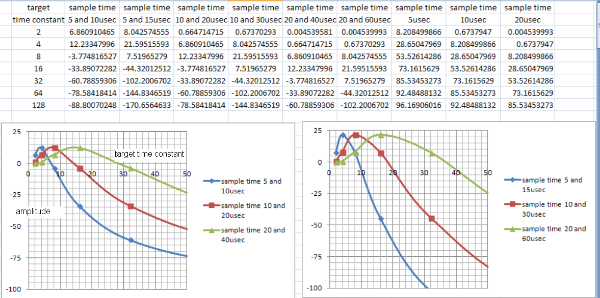

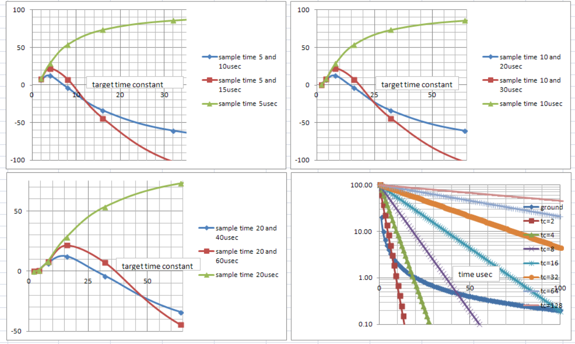

    There has been some discussion of GEB in at least two threads lately. [TDI ground balancing scheme, twice over] and[ Replies to Minipulse Plus]. I charted some data to see if I could understand the problem. The lower right chart is a log-linear plot of ground (1/t) with an amplitude of 20 at 1usec and target time constants with an amplitude of 100 at zero time vs time in usec. The other charts plot signal amplitude vs target time constants sampling at different times. The lines with two samples reject ground, ((sample 1 amplitude - (sample 2 amplitude x sample 2 time/sample 1 time)). The single sample plots the percent amplitude based on 100 at zero time for the different time constant targets.

      Thanks for the reply. A couple questions I had, how far apart the sample 1 and sample 2 should be and how far apart the second set of samples should be. S2 time/S1 time=3 is better than S2 time/S1 time=2. Looks like doubling the time for the second set of samples is a good place to start. I'm guessing there is a limit with the time difference with the PI detector where it gets worse. Excel isn't limited by noise.

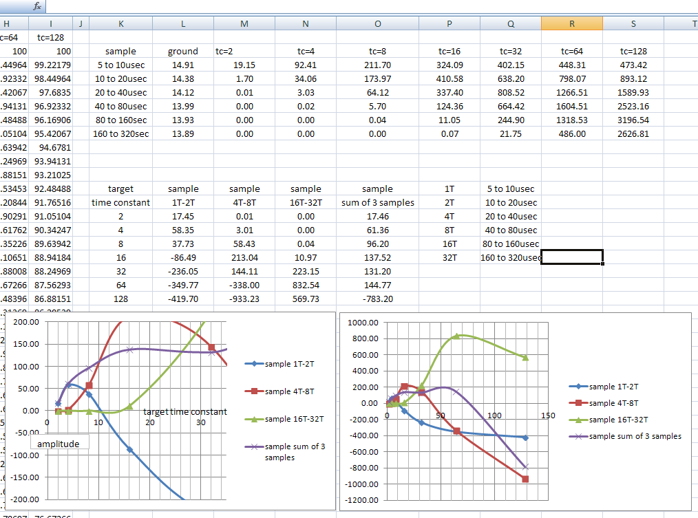

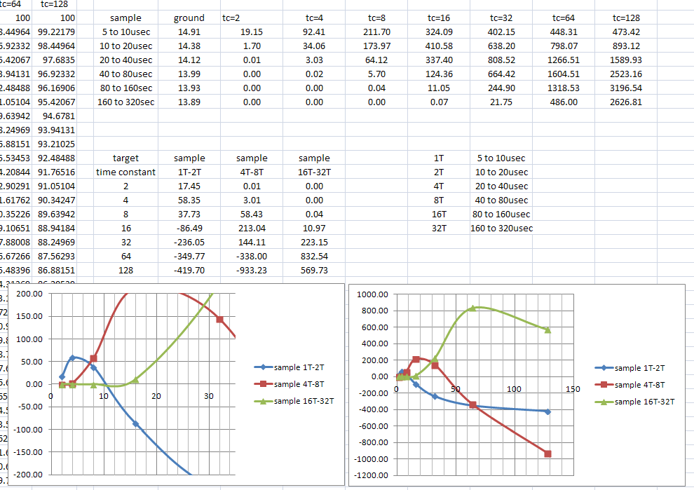

                      An attempt at charting it. Used same data that was used for #1 and reply#3. Forgot to label X axis (target time constants) y axis (amplitude)
                        OK, now just add those 3 traces together and see what you get.
                          Chart with 3 traces added.
                            Well, that's as far as this concept goes. With 10us as a time base, you'd get a hole beyond 100us, a flat response for nearly all targets, and meaningful ground balance as well. What you don't get easily is EF, which is 1+4+16= 21T ... unless you go for alternating pulsing and get rid of EF altogether.
