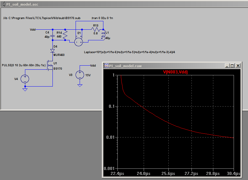

Regarding modeling, LTspice has controlled sources that take a Laplace transform in their definition. It would suffice to insert such a controlled voltage source in the coil circuit, one that depends on the I in the coil and the transform.
Problem is L{1/t} is not defined. But 1/t is just an approximation of the integral -exp(-t/tau)/tau between tau = t1 and tau =t2, where t2>t1, so you can use a finite sum of exponentials with a range of tau's like Davor did.
Syntax: Gxxx n+ n- nc+ nc- Laplace=<func(s)> + [window=<time>] [nfft=<number>] [mtol=<number>]
Would look something like: G1 n+ n- nc+ nc- V = i(L1)*1e-2 Laplace=(s/(s+1/1e-6)+s/(s+1/1e-5)+s/(s+1/1e-4)+s/(s+1/1e-3)-4)/4
but using more tau's.
That said, I haven't tried this yet

What I see in your model is that there is a little offset which is easily remedied by removing it from a plot, say, V(N003,Vdd)-0.005
Also to confirm the 1/t behaviour, you should put log time scale as well. If it runs linear from 10us to 1s you're on.
My model is a little too perfect, as it is reported that 1/t works as advertised only up to 100kHz or so, and for any practical purposes you'd need to go down to 1Hz, not more. I added a few taus too many upwards from 100kHz.
I used Laplace in LTspice before to play with some all pass filters. Their only problem is that you can't do much more than by using common components. 1/t is one example of a function that wouldn't come peacefully, and the only sound way of doing it is by combining several taus, as you noticed.
I also use voltage and current sources for some clever models, say vari-L. It is handy for testing a circuit with a coil in varying permeability conditions. I even tried to model viscous ground that way by applying equations with powers, but the problem came in form of infinite values at zero time which is not what happens in nature. It served its purpose for a time, but it was not that good.
The model I came up with uses lumped elements, and is easy to build and tune. Using Laplace functions of s should lead you in a same direction, yet in a bit cryptive way for a less seasoned engineer.
