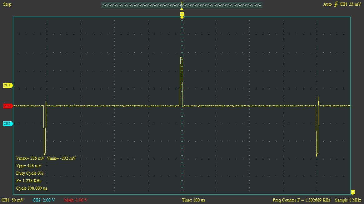

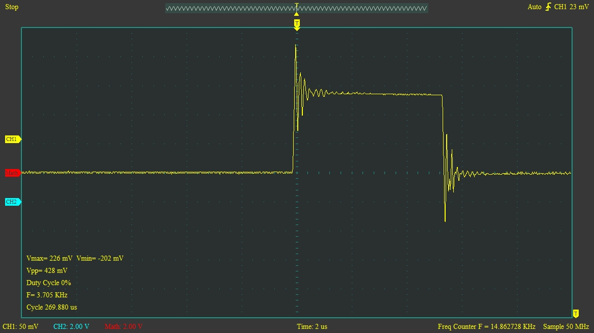

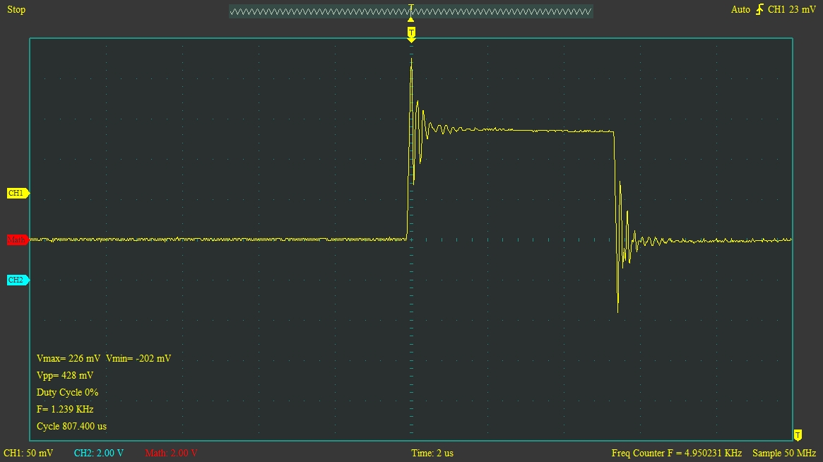

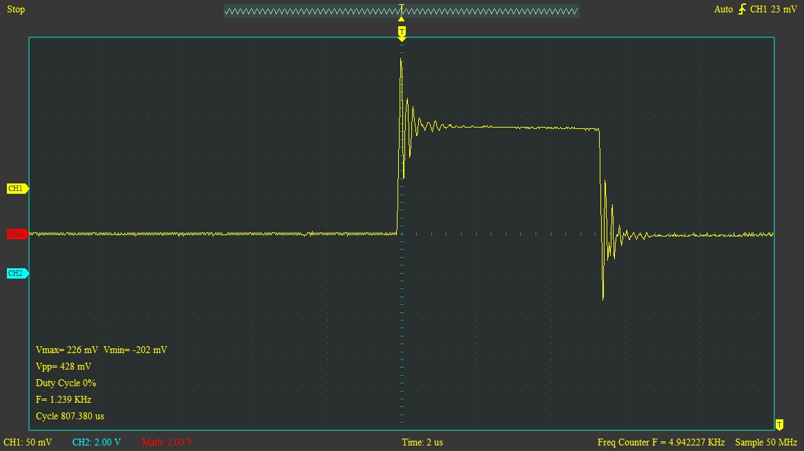

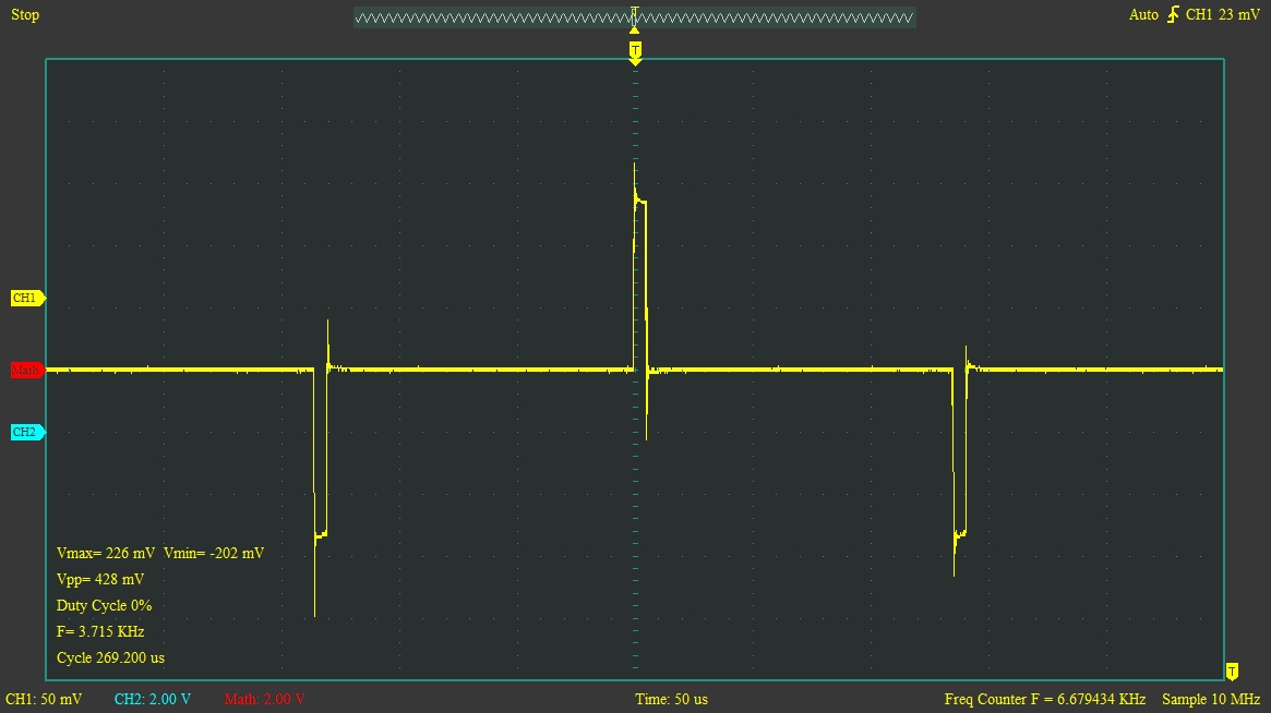

                    Ho,
                    Some may find these interesting,
                    At around 6 Watt hour, there's a lot of power jammed into those very short pulses.
                    No physical difference between pulses for Extra Deep and General timing, must be in the processing.
                    Sorry for cruddy scope images, also no damping or true magnitude.
                    Cheers
                    Kev.
                    High Yield Pulse
                    High Yield Waveform
                    General Pulse

                    Extra Deep Pulse

                      Thanks for posting up those images. Very nice scope you must have. It is intriguing to see such alternating short duration pulses. When viewing the pulse train from afar, to my uneducated eyes, they almost look like flyback periods. Reminds me of something PiTec posted once. For years MikeBG spoke of an old "gradiometer-like" coil and principle. Seems to follow similar pattern, measuring the difference between two receive signals.
                      From videos and reports, it displays some astounding depths for the smallest of targets. Horrible machine. You lucky fellow.
                      • #41
                        Yep Lourie there's nothing new under the sun, either natures done it, or someone else's thought of it before.
                        How it's applied in real life is what makes the difference...........yeah horrible machine indeed, maybe if some of deemon's ideas make their way into the next revision, it'll then be a real beastie, and not a heaftie only.
                        I think the DOD coil maybe the Achilles heal of this machine.......when you consider the whole TX energy is released in such a short duration, the grounds got to complain wildly me thinks.
                        cheers Kev

                              What is the scope measuring?
