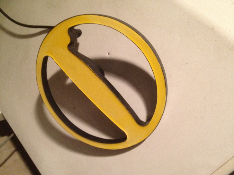

            If your making a PI coil, any PU resin should be ok
            I got mine form here http://www.maragon.co.uk/arts-and-crafts.html#Print1
            I used the casting resin, mixed with about 40% fillite powder to lighten it - certainly didn't melt or warp my coil shells (from Don)
            I even used some colour paste although if using a scuff cover thats not needed

              Sinclair user; It takes between 1 and 3 days to cure.
                yes the poly resin i used took about that long, which was ok since it was an ib pi coil and allowed me to tweak the balance as it set.
                i mentioned the heat issue since from experience i have found fast cure resins can get quite hot when curing.
                i have recently made a small ib dd coil, and used wonder gel(mentioned in another thread) it seems ok.
