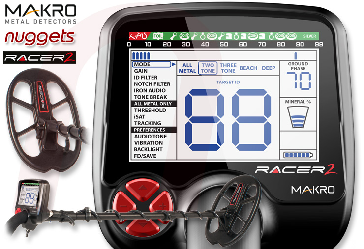

        Makro Racer 2
        Racer2 is out now!
        I checked this out by pure coincidence,
        because its available only since a few days!
        Again, of course, the Racer is with the 40cm coil compatible (but we still need a 70cm !!!!)
        Very important! Small coils are often just ridiculous and absolutly in no relation to the
        size of this world! Usually every MD must have a 3m coil which finds every little nail!
        More info here:
        Overview:
        http://www.makrodetector.com/racer-2...-detector.html
        Manual:
        http://www.makrodetector.com/download/KKR2120216EN.pdf
        Brochure:
        http://www.makrodetector.com/download/BRR2090216EN.pdf
        new Makro Racer 2 air-test video:
        http://www.makrodetector.com/racer2-...e-videosu.html
        21 inches (over 50cm) on an american Quarter coin !!!
        this ist still the old Racer but it's a cool clip:
        https://www.youtube.com/watch?v=bV6qd9qurfg
        here the new one:
        http://www.nuggets.at/Makro-Detector...Metalldetektor
        Makro Racer 2 Deep Mode (with slower sweep speed):
        https://www.youtube.com/watch?v=vJ4U3Xrf28c
        and attached picture
        What are the improvements compared with the original Racer?
        - high material and electronic signal stability! (superior quality!)
        - further improvements are the find identification
        - special beach- and deep-search modus
        - standard 30cm coil (nice, because it is still ultra-sensitive for super small stuff)
        - still vibration (perfect !!!)
        - improved notch filter
        - selfadjusting threshold (auto-silencing)
        - save your settings
        - improved coil overload problem (caused by the Racers ultra-high sensitivity)
        - advanced discrimination
        - improved detection on high mineralized ground
        - extra long shaft (improved stem lenght for big search width)
        So far I don't have this detector but when I have it I will give you the
        exact details about it and how it compares with the first Racer!
        Anyway - the Racer is fantastic - you might double your finds so far
        within one or two years with it !!! This is really possible !!!
        And it's no mistake if you support
        the turkish MD-manufacturers a bit because they have not the
        easiest time at the moment in this land full of fanatic terror attacks.
        And they really do their best to produce and develope the
        greatest MD technology they can. And the Racer is King, for
        beginners but also for professionals!
        Lightweight, easy to use and uuultra-high-sensitive !!!
        Get it as long Turkey still stands! *just joking*
        Price: around 700 Euro or Dollars and incl. 40cm coil: ca. 850 to 900 bucks
        and last but not least:
        Listen to loud music or radio or your favorite audio-books while digging
        and running around! The Racer has vibration!
        This is a whole new treasure-hunting experience.
        Of course the Racer 2 should have already some mp3 player inbuilt
        but I hope this will come in Version 3, together with 70cm coil.

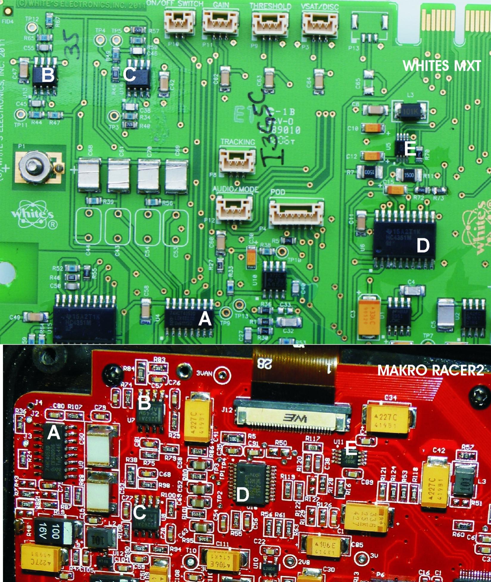

                • #53
                  Find to difference...
                  Connect the lines of the points A to B and C, B and C to D, D to E
                  A - 4053
                  B - 2262
                  C - 2262
                  D - 4351
                  E - ADS8320
                  Carl what do you think?
                  • #54
                    I find the use of a 16-bit ADC interesting. The Tektronics T2 / Fisher F75 have a 16-bit converter, but use pseudo-random noise injection and oversampling/averaging to extend this to 19 bits. As a result the Tek can resolve small signals, while still coping with extreme ground signals, and not being over-fussy about coil nulling. If only a 16-bit ADC is used, it seems likely that more system gain would be needed and this puts pressure on overload capability, and needs accurate coil nulling, that hopefully doesn't drift with coil ageing. As the Turkish machine has a history of coils causing overloads, and related 'easily-overloaded' operation, it makes me wonder if the lower bit converter is part of the problem.
                    Makro could be using oversampling etc, it's not possible to tell from the circuit board.
                    Obviously there are ways around this, like using compression to squeeze up large signals whilst keeping small-signal sensitivity, as used in lower-end machines.
                    • #55
                      Ok. But why Macro uses the hardware solutions © Whites?
                      • #56

                          "But why does Makro use the hardware solutions © Whites?"
                          Every manufacturer likes 4053's, they're dirt cheap and are proven to have better characteristics than similar (4016/4066 etc) parts. There's heaps of 'better' analogue switches, with lower on-resistance, faster operation, less charge-injection etc etc, but if top-of-the-line machines don't need them, why use them? I can think of why you might use other switches, such as for low supply voltage operation (3 V, single Lithium cell power) and maybe some of the single-gate SOT23-5 type parts may be handy to keep size down?
                          The ADC may be chosen because of the combination of power consumption, low cost, with 16 bit conversion. There's probably not a huge shortlist of suitable parts, so it's not unsurprising that Makro agrees with Whites choice.
                          I'm sure it's a common industry practice to see what other manufacturers are doing, and taking inspiration from non-copyrighted design ideas is fair game.

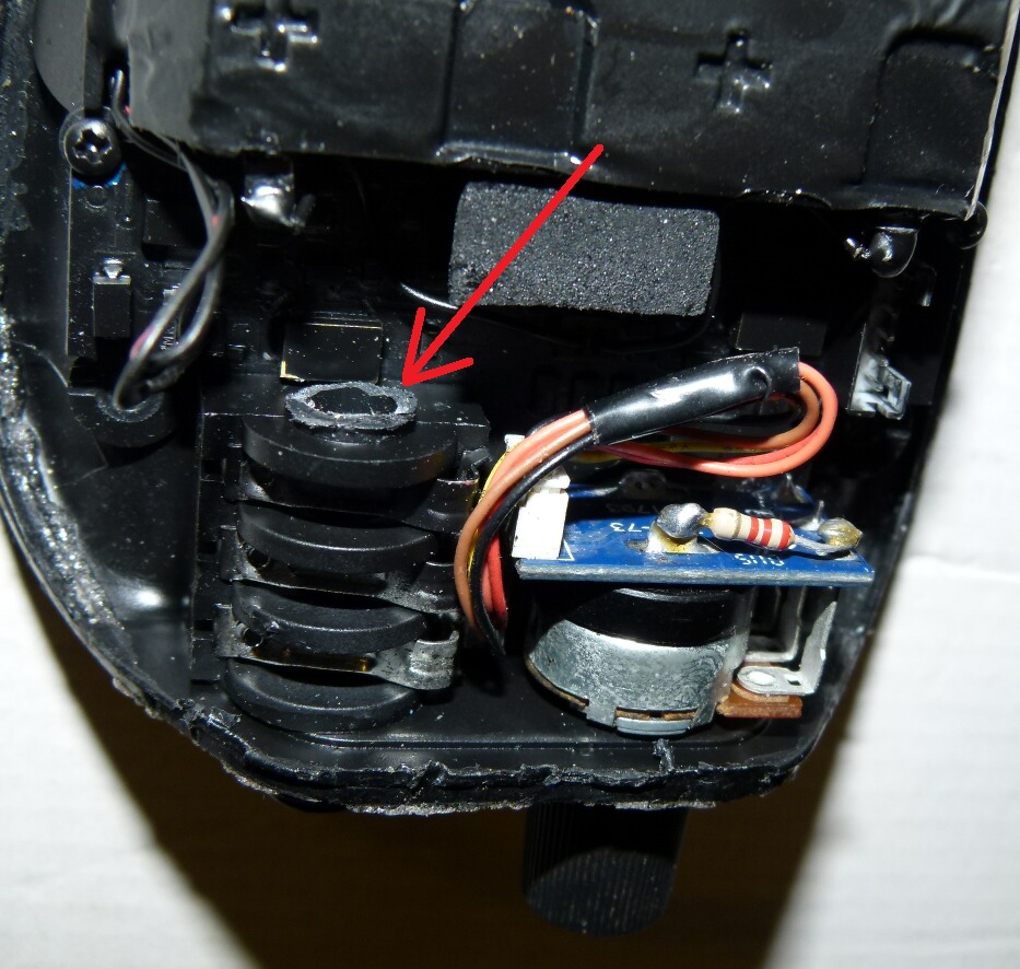

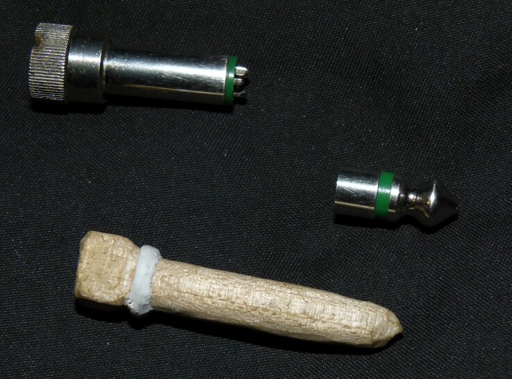

                              Audio jack dongle
                              So far I've used a 3,5 to 6,3 mm adapter when working with
                              vibration for turning off the audio-signals completely because the
                              Racer is not totally silent, if the on-off poti is turned to lowest volume.
                              And with some "luck", that knob turns to louder by itself while searching !
                              Now this crappy adapter plastic thing did break and it's tip was unremovable.
                              Here's the solution:
                              Opening the housing and cutting off the edge of the audio-jack!
                              And from now on I'm using some wooden dongle with water isolation.
                              It's more lightweight and will not break.

Name:	Racer audio jack opened.jpg
Name:	Racer audio jack dongle.jpg
