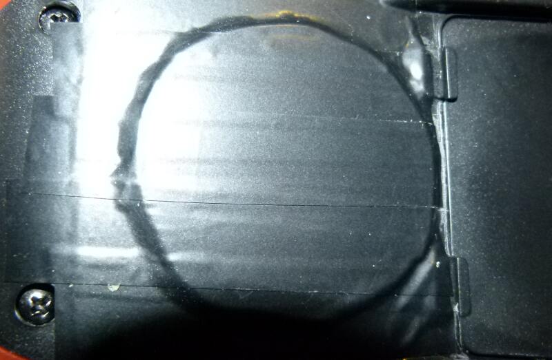

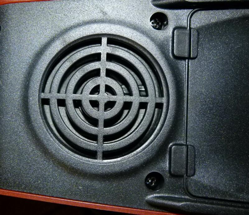

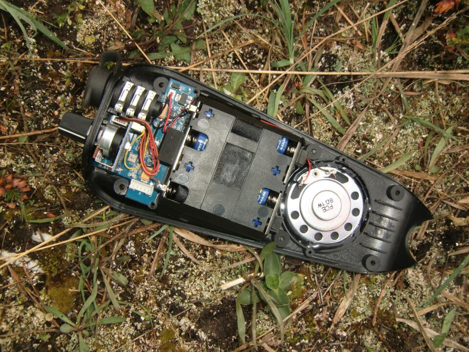

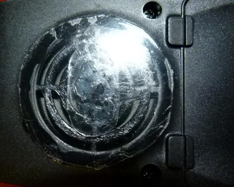

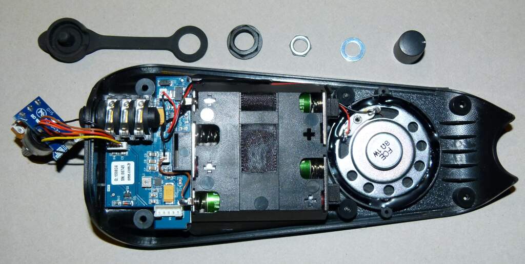

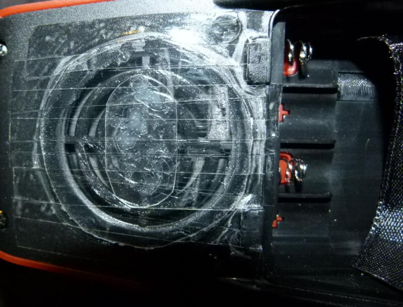

    The only thing is that the speaker-gaps on the lower side have
    to be closed from water by default because this is the region
    where the detector stands on the floor while digging and
    if there is wet grass etc. the moisture can easily penetrate the housing.
    See the pix below - the solution is very simple, even some stripes of
    tape are enough but of course I made it as perfect as possible.
    The Pro-Package comes with a special cover for that housing
    but neverthless any Racer should be directly secured from water!
    You even can see the paper of the loudspeaker behind the gaps.

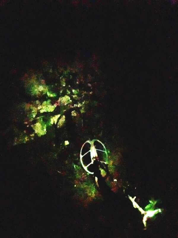

    and LED-lamp plus backlighted display for perfect cave or night-search.

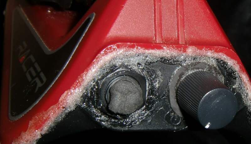

    Just close the speaker-hole with some tape or glue some plastic-sheet
    over it and everything is fine. This is important technical info because
    otherwise the detector may get serious problems if the grass is wet etc.
    Save is save, no matter with or without additional protection-cover.
    If someone is unlucky even some thin branch etc. could stick into the
    speaker hole from below and destroys its membrane or even water could
    run into it. So its important to prevent all such dangers in the first place.
    btw. the 6,3mm headphone jack has its own waterproof rubber-gum-cap!
    Of course the speaker still is loud enough if you make it water-protected.

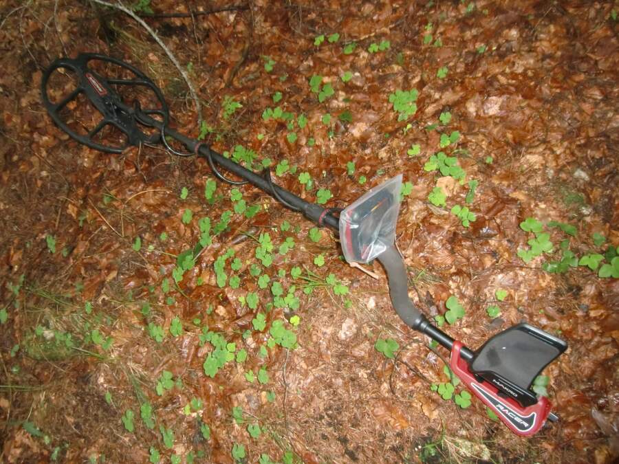

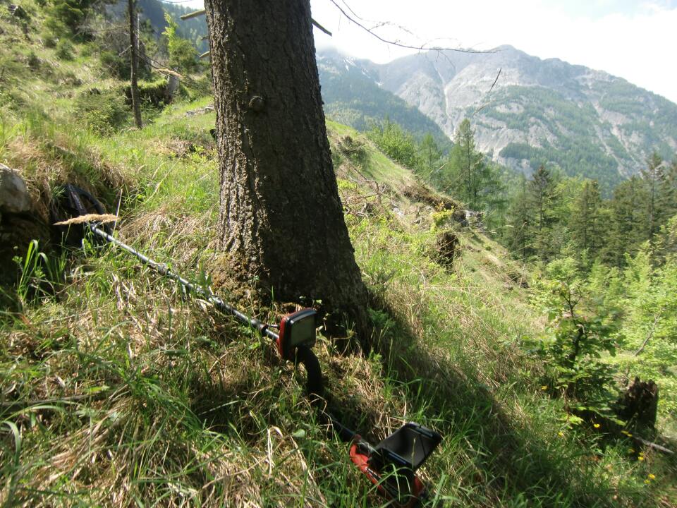

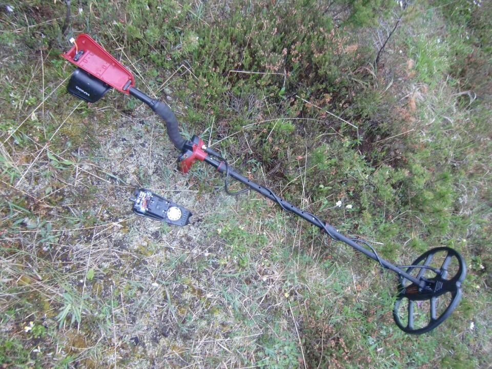

    Heres a first field test overview from yesterday @ pretty steep wood region (see pic) :
    1. The lightweight just 30cm coil detects in air a bike from ca. 1,5 meter !!!
    This was really astonishing to me - compared with other detectors!
    2. the Racer uses a special slow-motion circuit which seems to combine motion with nonmotion
    (if you sweep the coil into direction metal the signal already shows where exactly the find is
    like a nonmotion circuit and even very slow sweeps will create a very good detection signal)

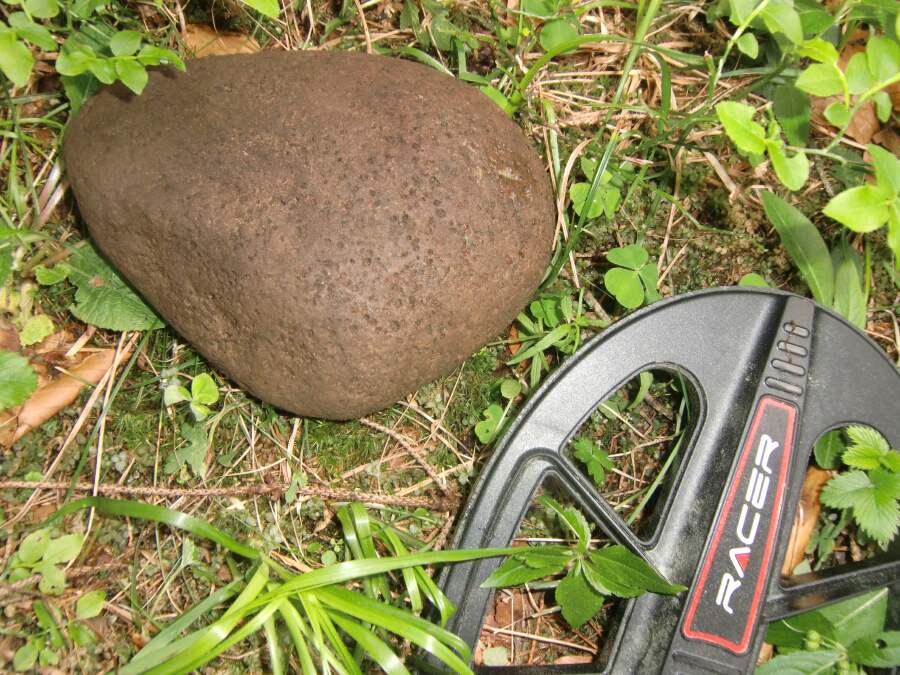

    3. detecting mineralized stones or meteorites:
    Set the detector to allmetal, press the pinpoint switch to ahead position and set the Ground Balance to zero.
    This is an undocumented feature I found out myself and it works perfect.
    Of course the usual ground should be medium to low mineralized (humus, meadows, woods etc.)
    so you will detect the special mineralized stuff with a good signal.
    (by default the ground balance value is at ca. 50-60 = medium mineralized soil, the Racer also has
    a special wet salty sand beach setting)

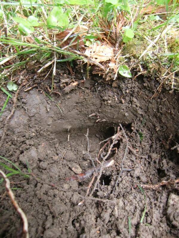

    4. Depth and signal-to-background-noise ratio is fantastic even if some high-voltage e-smog is nearby.
    You will detect 15mm musket-balls, 20cm buried, already if the coil is 15cm above surface.

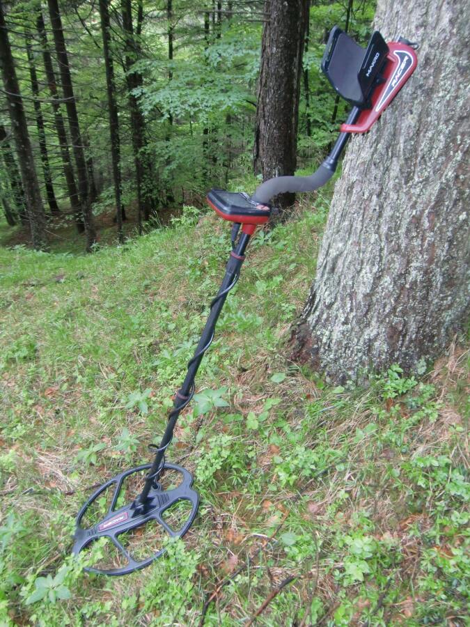

    5. Also the lightweight construction of the whole detector is absolutly great.
    Even kids can use this detector for many hours without geting exhausted.
    And of course this is perfect if the terrain is very steep or dangerous.
    But the main advantage of the lightweight construction of course ist using it
    with the 40cm coil - no prob for the whole day long.

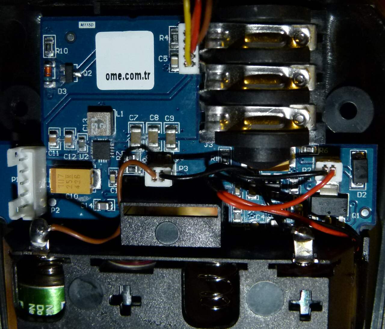

    7. I can't believe that its possible to reach such a depth with only 4,8 volts!
    Because it works perfect with just 4 x 1,2v NiMH accu's (or usual 4 x 1,5v batteries, too)
    It has a fantastic signal-processing to amplify the real metal signals by using
    a very battery-saving amount of coil- and detection-circuit energy.
    And such a set of 2500 mA rechargeables fur shure will lasts for 20-30 hours.

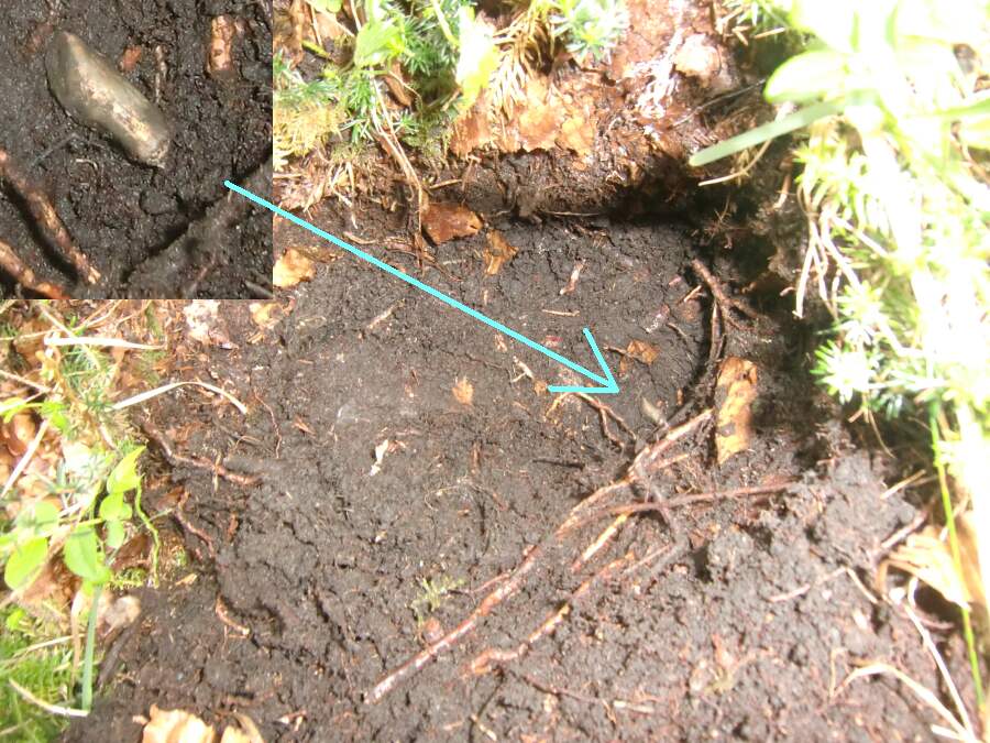

    Yesterday I could already detect at the first time a little 2cm nail 10cm deep while
    sweeping the detector 10cm above ground.
    I found out that the vibration method works the best if the coil gets swept medium fast.

      Quote:"I can't believe that its possible to reach such a depth with only 4,8 volts! It works perfect with just 4 x 1,2v NiMH accu's"
      Perhaps it has a boost-mode switching regulator in it, like the Fisher F75 & Teknetics T2. Or maybe it uses a centre-tapped TX coil, like the T2. Or a dual-resonant TX drive circuit like the F75. There's lots of ways to get 'power' performance, you could easily achieve it with 2 x AA NiMH's, or 1 x LiPo/Li-Ion cell. The XP Deus only uses one LiPo foil-pouch cell in its coil, for example.

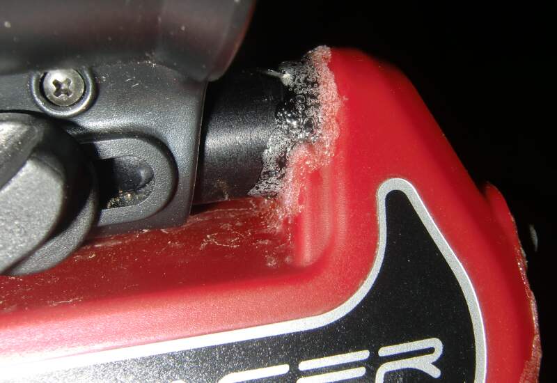

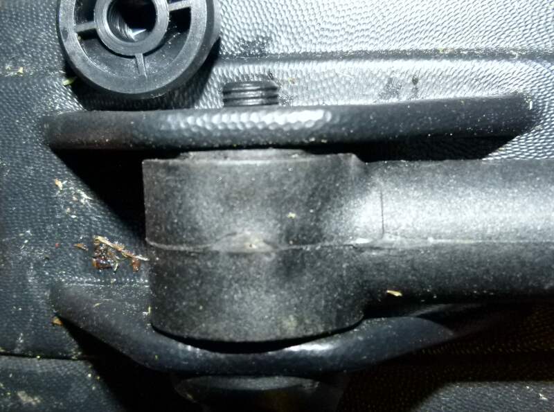

        in german Forums i heared that the first Racers has problems with overload Signal, especially at wet grass and low temperature
        and the coil Shells material seems to brake fast at the clampings

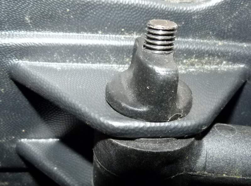

          You might be right - the coil shells clamping region might be not thick enough or could be thicker
          (actually its ca. 2-3mm thick for the standard coil and 4mm for the 40cm),
          but I guess usually there should be no problem with breaking if the plastic screw was turned tight enough and
          if the coil doesn't crush with full power into stones or other hard stuff.
          So far I had no troubles with it so I can't criticize it.

            40cm coil and rain test
            This was a really interesting & also successful hunt today:
            1. The Racer with 40cm coil detects a bike from over 2 meters !!!
            This is the best result I've ever got with a motion detector, its even better than the DeepHunter with 45cm coil.
            2. Signal stability while hunting is very good (low background noise or ground signals)
            3. the vibration-detection is not good enough for sweeping the 40cm coil very fast as I do always.
            But it works at sensitivity 40-50 and with medium fast to slow movements and 10cm above ground.
            4. The weight of the 40cm coil is light enough to sweep it for a long time 80cm ahead of the feets.
            This is important to cover a real huge area with just one sweep.
            5. depth and recovery speed is unbelievable - within 5min I found 3 musket-balls.
            6. the waterproof is really a problem:
            I have opened the Racers battery region just because a few drops of water went into it by capillar-effect.
            Because of the directly nearby PCB and circuit it made the volume totally silent and the detector even
            created signals when the potentiometer was turned to completly off.
            (this means removing the batteries or clamping a plastic-sheet between the contacts to switch the Racer totally off)
            After drying everything was fine again but this can't go on!
            I had already the right intention by closing the nearby speaker-holes but I didn't think the water
            will run directly into the 6,3mm headphone jack! The gum-cap is pretty useless because it
            opens every time by itself and the gum-ring around the jack is absolutly not tight enough!
            This means that there's really the need for additional water-precaution-measurements!
            The easiest solution is to cover all the dangerous regions with enough water-resistant glue.
            And put plastic-bags over the electronic-parts even if it starts to rain a little bit.
            It's also a good idea to secure the openings of the battery-case with some tape.
            From the inside or outside.
            And instead of that gum-cap its better to shove some tight fitting gum-part directly
            into that 6,3mm audio-jack while the ouside has been secured by glue.
            Otherwise this will be the No.1 entrance for water, together with the open speaker gaps.

              It does look like there is a switching regulator on that PCB, based on the small multi-lead IC and the square inductor next to it. Probably set to give something like 6 Volts or similar, like the Tek T2 has.

                  thx for the info, a highly stable regulated voltage of course is very important so its good we know now that it's there.
                  It was just positioned at the wrong place. This PCB should have been placed where little drops or penetrating films of water
                  can't reach it. And I also guess that the PCB had some salt-remainings on it - that's why the water got higher conductivity.
                  btw.: Always have some screwdriver with you to see what's going on, even while treasure-hunting...

                    I agree with your observations about the location of the electronics in the armcup assembly. It's very likely to get wet from dew-covered grass, sea-water, puddles etc.

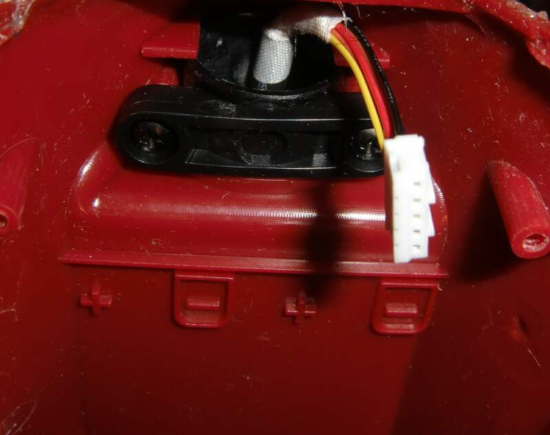

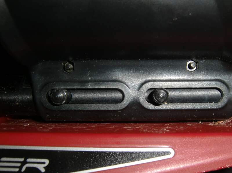

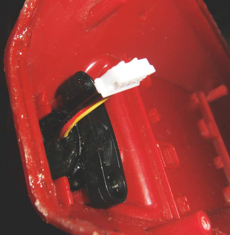

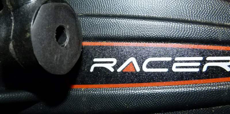

                      1. Water protection:
                      Below you see the pix - there are 6 "holes" that have to be closed:
                      1. Speaker gaps
                      2. headphone-jack & on-off knob region
                      3. holes that go into the alu-pole to adjust the arm-rest
                      4. the region where that pole is connected with the plastic
                      5. the hole where the cable comes out !!!
                      6. the small gap or line where the black lower plastic is in contact with the red plastic
                      You may need some gum-stuff, water-resistant glue, scotch-tape or whatever
                      or simply wrap the whole region with a plastic-bag if the grass etc. is not absolutly dry
                      or if it starts to rain.
                      I don't wanna make you paranoid - I used this detector while heavy rain and I protected
                      the display-part with a small fridge-bag which worked well enough but of course
                      its much better if this all the time with ground in contact battery & speaker part
                      is as water-proof as possible.
                      2. hunting by light signals !!!
                      This also is a fantastic newity !!!
                      If you set the LCD display light to on (brightness 1-5) the display will automatically
                      switch on if you get a strong enough target!
                      If there is no signal or just weak ones the display will automatically switch to off
                      for saving battery-power.

                        Here a short info-update:
                        - its possible to detect high mineralized stones by default settings
                        if they are very "energetic" and close to the ground by the
                        Racers "coil overloaded" siren signal

                        - if the speaker is water-protected it's too quiet
                        (solution: use just a thin plastic foil for water protection or headphones)

                        - the detector finds stuff deep at clay regions with a very good
                        signal and my meanwhile most smallest find was a 15mm bullet
                        ca. 20cm below with the 30cm coil and the signal was
                        available already 10cm above ground which also is important.

                            The standard plastic screw for the 40cm coil is too short! (see pix below)
                            There are just ca. 3 windings left which do not provide enough strengh
                            over longer time. If they wear out sooner or later the 40cm coil has no more stability.
                            The inside space for the stem's screw hole part also is ca. 1mm too broad.
                            This results in bending the "coil-ears" which is not the best.
                            Solution: Some thin gum-part as a washer inbetween.
                            Seen from the weight together with ground-covering performance
                            the Racer is the same good as the DeepHunter with the 45cm motion-coil!
                            It feels that holding and sweeping the complete Racer with 40cm is the same
                            as sweeping the 45cm DeepHunter coil only! This is very convinient and
                            its very practical also at pretty steep wood or hill regions.

                            At the moment I just have a little problem:
                            After some moisture found its way into the battery- and speaker-amp-circuit
                            the volume remains pretty silent even if the poti was turned to full.
                            Perhaps someone can see from the PCB pic above what may burned or happened.
                            Skippy?
                            However this is a good warning for everyone absolutly using moisture- and rain-
                            protection for all the electronic housing parts !!! Of course I even could add some
                            extra amplification circuit to get the volume to loud again but for others its better
                            if such problems never occure in the first time.
                            As long as the speaker-gaps are open and there is not much noise around
                            I still can work good enough with those pretty silenced audio-signals but
                            of course its better if I have the volume back as it was before.

                              I'm unsure what exactly your problem with the audio is. No sound from the loudspeaker? No sound from headphones? Both? It seems you may have oxidation of the contacts inside the headphone socket. Turn the volume to maximum, have the detector screaming, (eg. pinpoint then move it near metal) then plug/unplug repeatedly the headphones. Hopefully the loudspeaker will start working again when the oxides are burnt away.
