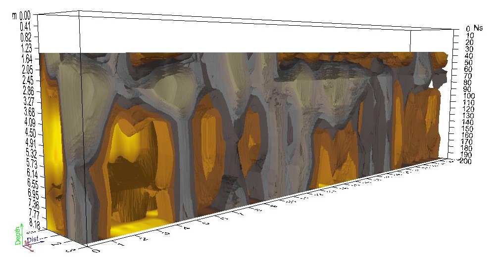

large mass detection system and cavities with a manufacturing model and rendering 2D.

            hi bigstarman
            thank you for the picture, it looks very good! Also the 8 meter depth is amazing.
            I was already as a child an interested cave-explorer and even have leaded tourists there!
            For cavity the Easyrad really seems to be the best detector for an accaptable good price
            and even better than magnetometers with their color-spots on the screen.
