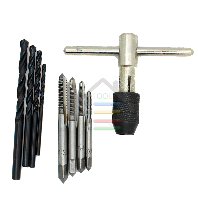

    what sort of tool would i need to tap the holes ???
    Drill and correct drill bit size and tap depending upon your pot threads you purchase.
    I have a special set of drills made for plastics that I use if I am not tapping. Otherwise I just use standard high speed steel bit because i don't have a set of numbered drill bit sizes made for drilling plastic.

      i found the taps on ebay in metric sizes and some have different pitch sizes...and found goop from uk source...the pot i ordered is a 6mm metal shaft with slot...can a splined control knob be used with this or would i need screw type knobs to go with slot shaft ???

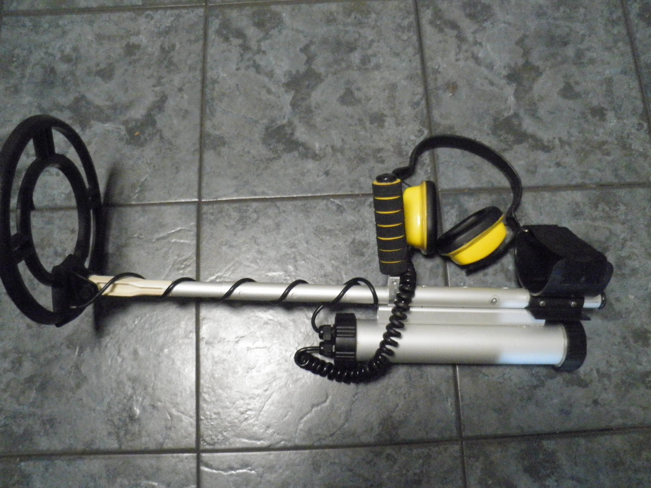

                  Continuing on building a better Mirage PI. Making small improvements all the time.

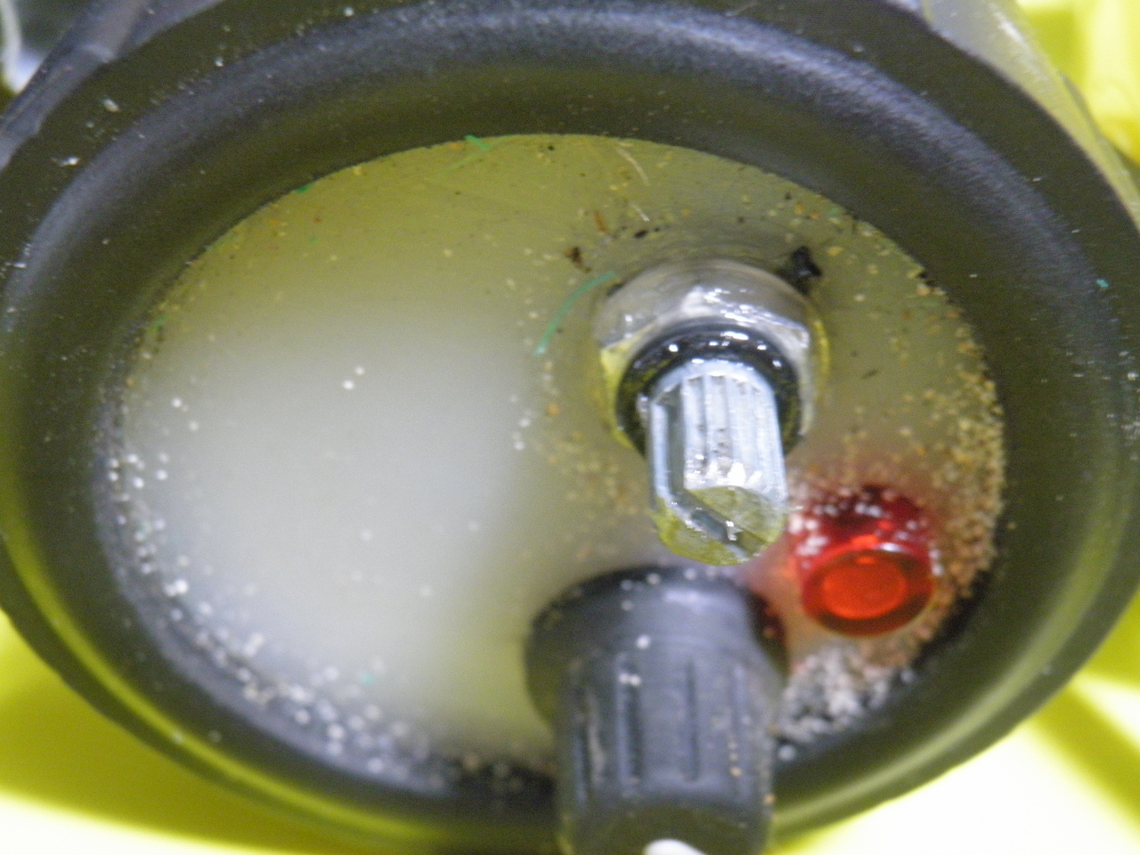

                    put a o ring between the join on the pot and fill the knob with lithium grease works for me under water never had a problem added a pic

                        did you use also hex seals ????
                        • #72
                          just o rings one on inside one under nut and washer outside and one on shaft as seen
