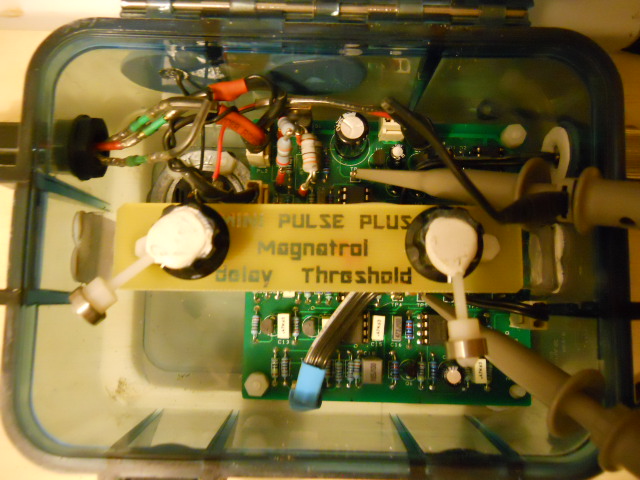

              • #82
                Hi Dave,
                I used this box at big five for 7 dollars. Its has a outdoor products and has a nice seal. It has room for batteries if you wanted.
                I opted for magnetic pots By placing little roller bearings in the box on a lever. The bearing pressure against the underside of the lid is adjusted by using knobs that have a set screw. I use a small rare earth magnet I keep on my scoop to adjust them. Works great you can make very small adjustments just like normal. You just gotta have some extra room, and a box with flat surface. If I can find some sliding pots that will be the next version.
                For Power I just made a diaphragm for a rocker switch.
                I do not have the seal in in the picture.

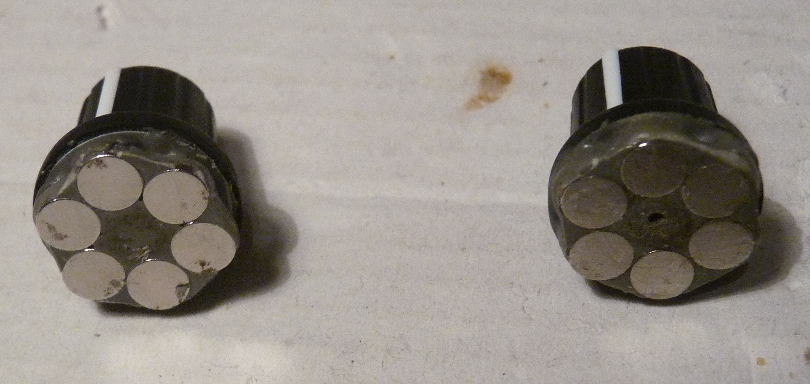

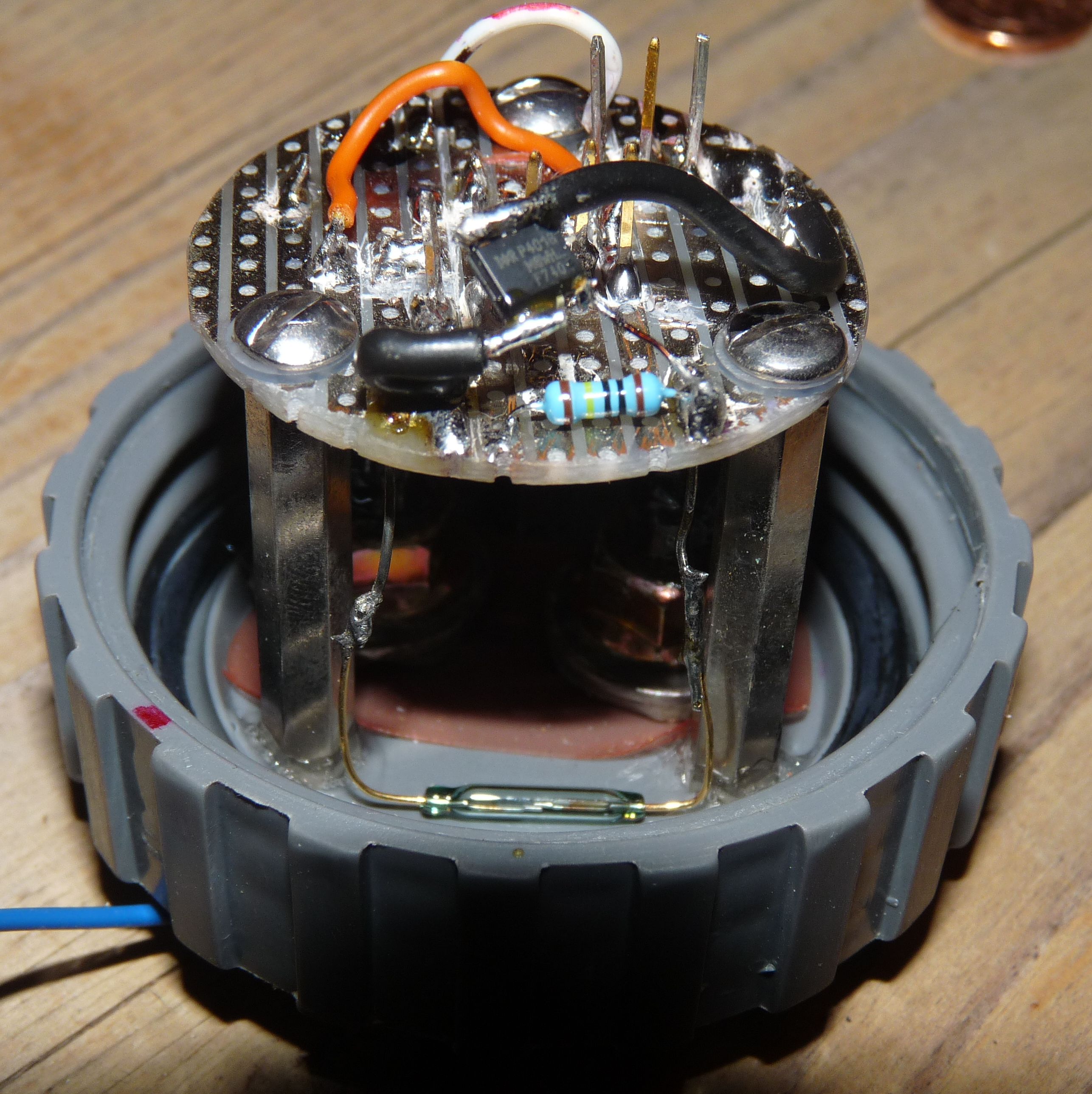

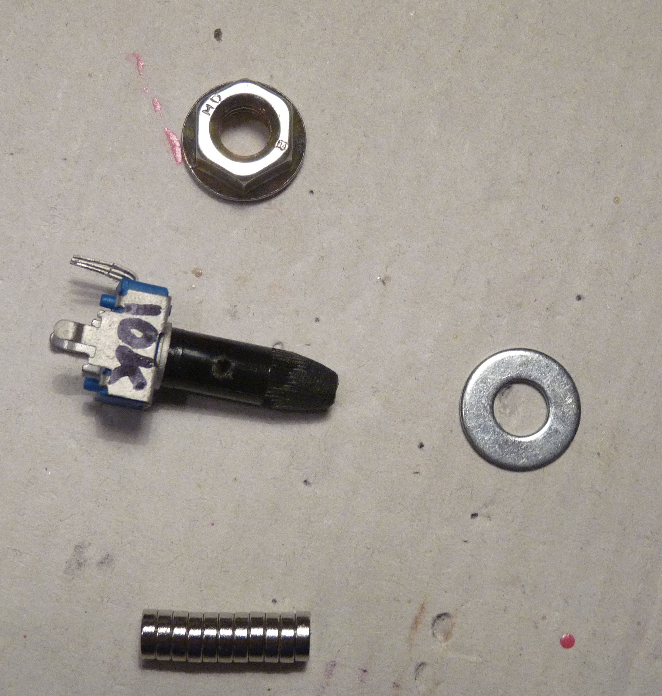

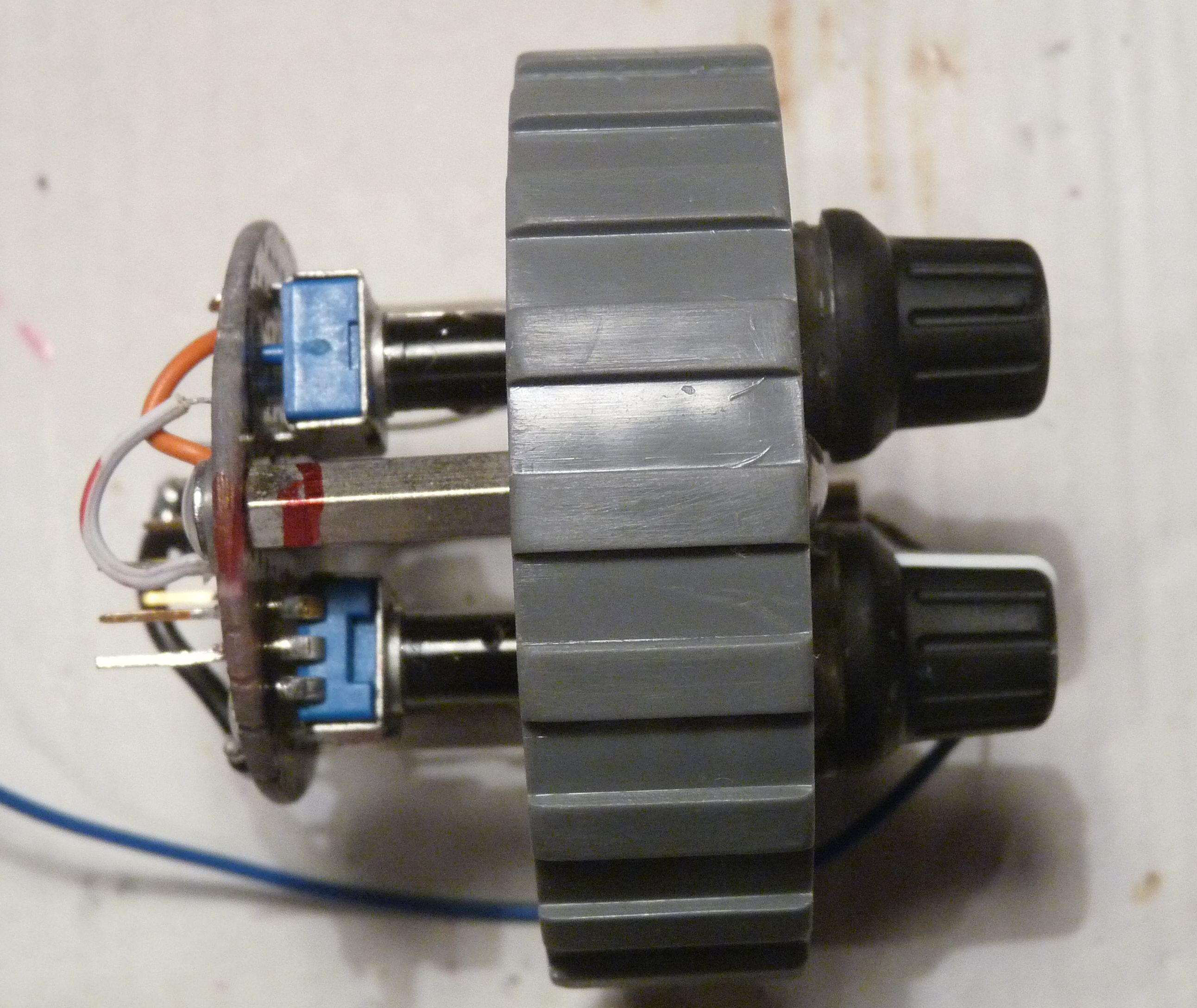

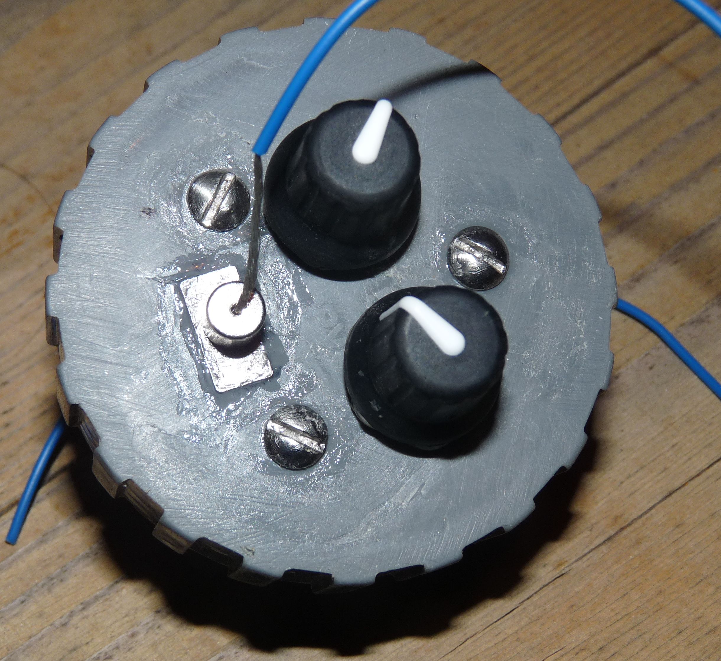

                          • #88
                            Hi daverave,
                            Took some pics today. The magnetic parts on the inside are like the ones on the outside knobs. The circular magnetic direction is n-s-n-s-n-s.
                            The reed switch powers off with a magnet via mosfet, so no worries if I lose it, I can still go detecting
                            The orangy tape inside is teflon sticky tape, makes it extra slippery. This is my first build. Next one will be cleaner.
                            Hope the pics give you some ideas ...
                            Cheerio

                              • #90
                                Hi Polymer
                                I like your magnet system I tried something similar with the magnets on a wheel inside and magnets outside. It worked ok except for the stiffness of the pots. and ended up kinda heavy.
                                I opted for high carbon steal bearing and a stack of magnets just like yours in the picture. I had the room in the enclosure so I went for the levers, I didnt think of a magnetic switch though that would have saved me a bit of time on engineering and a hole in my enclosure. So with a magnetic switch and magnetic pots you only have to install cable glands and its waterproof. Right on
                                Sounds like the recipe for my next project.
