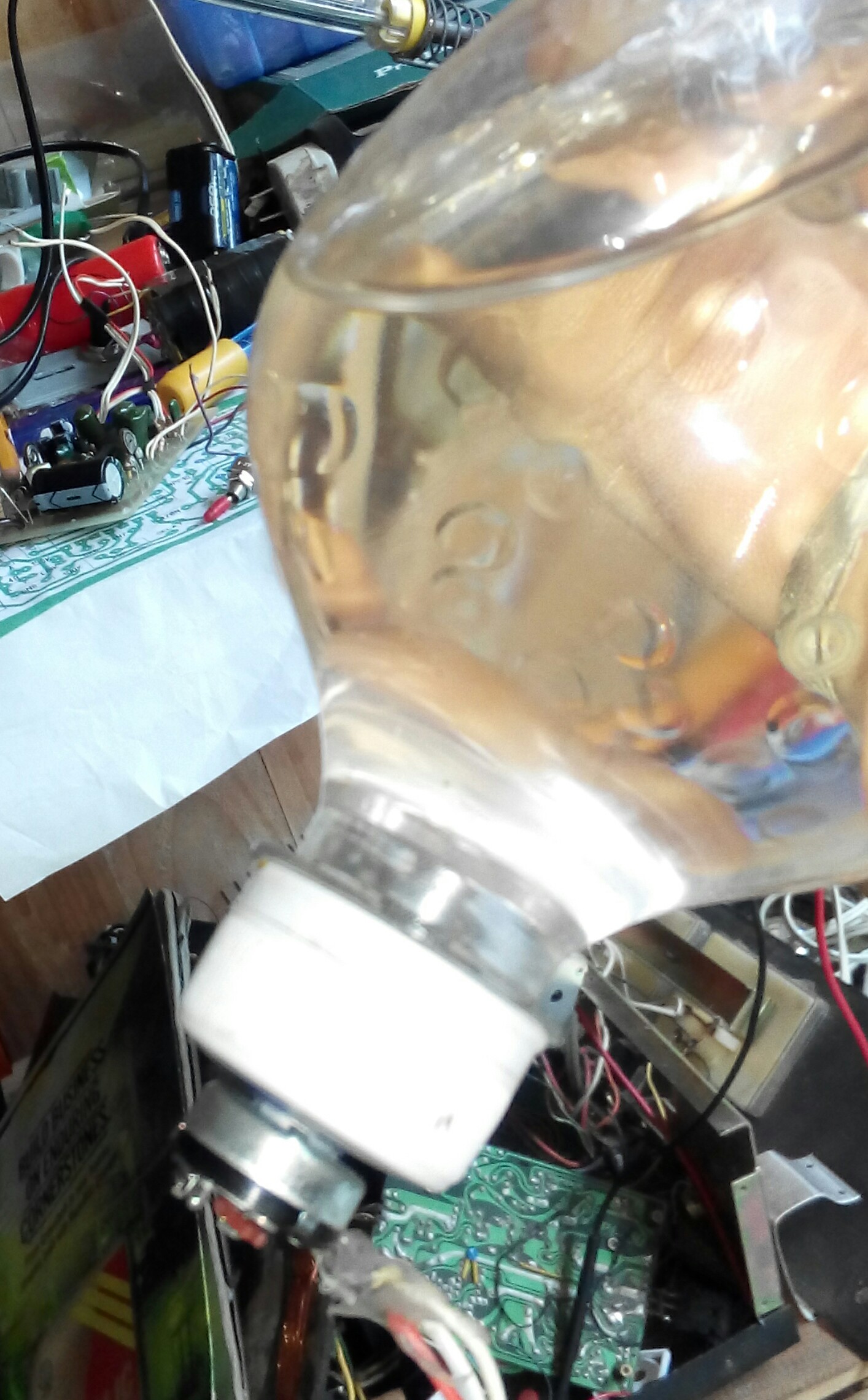

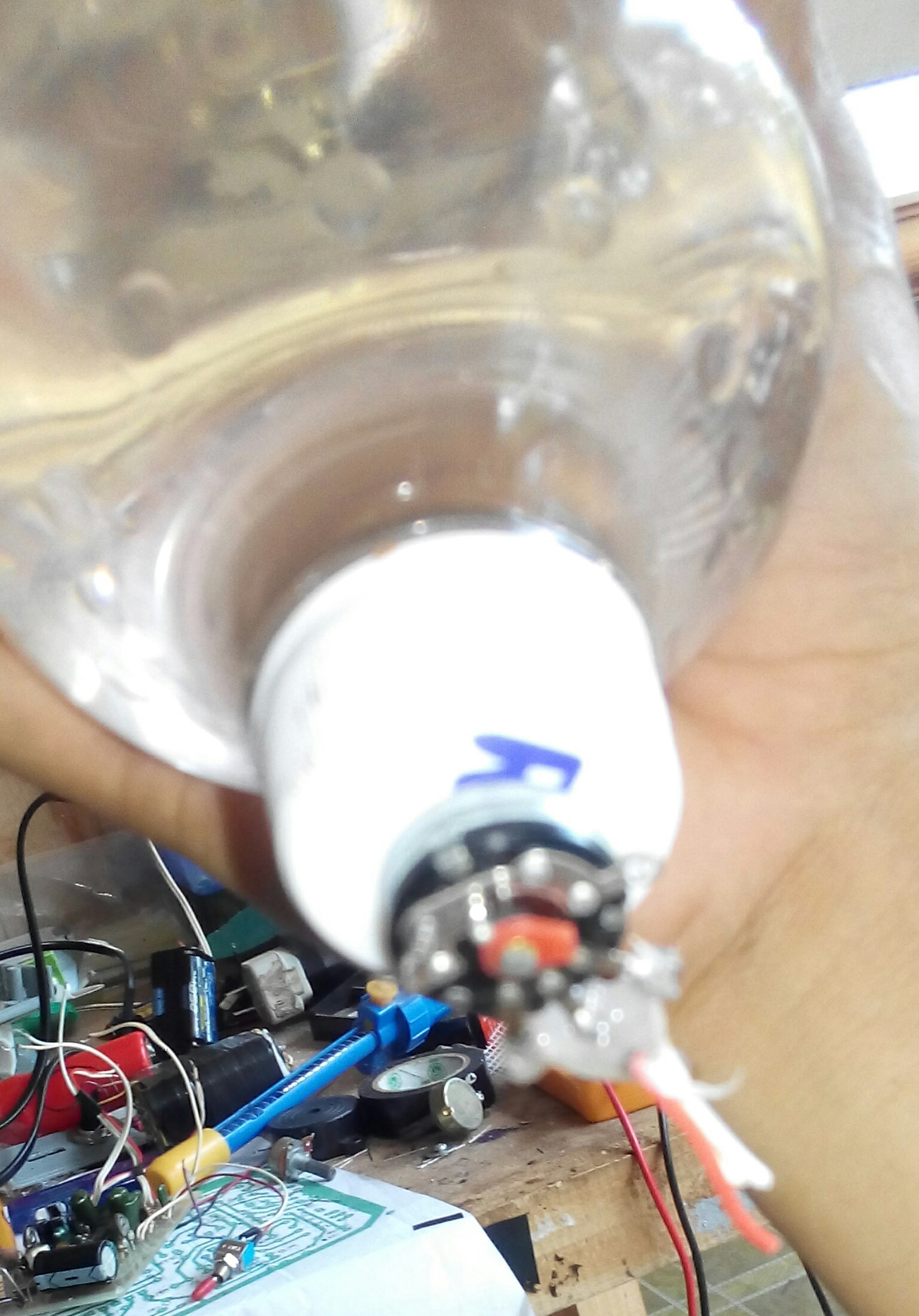

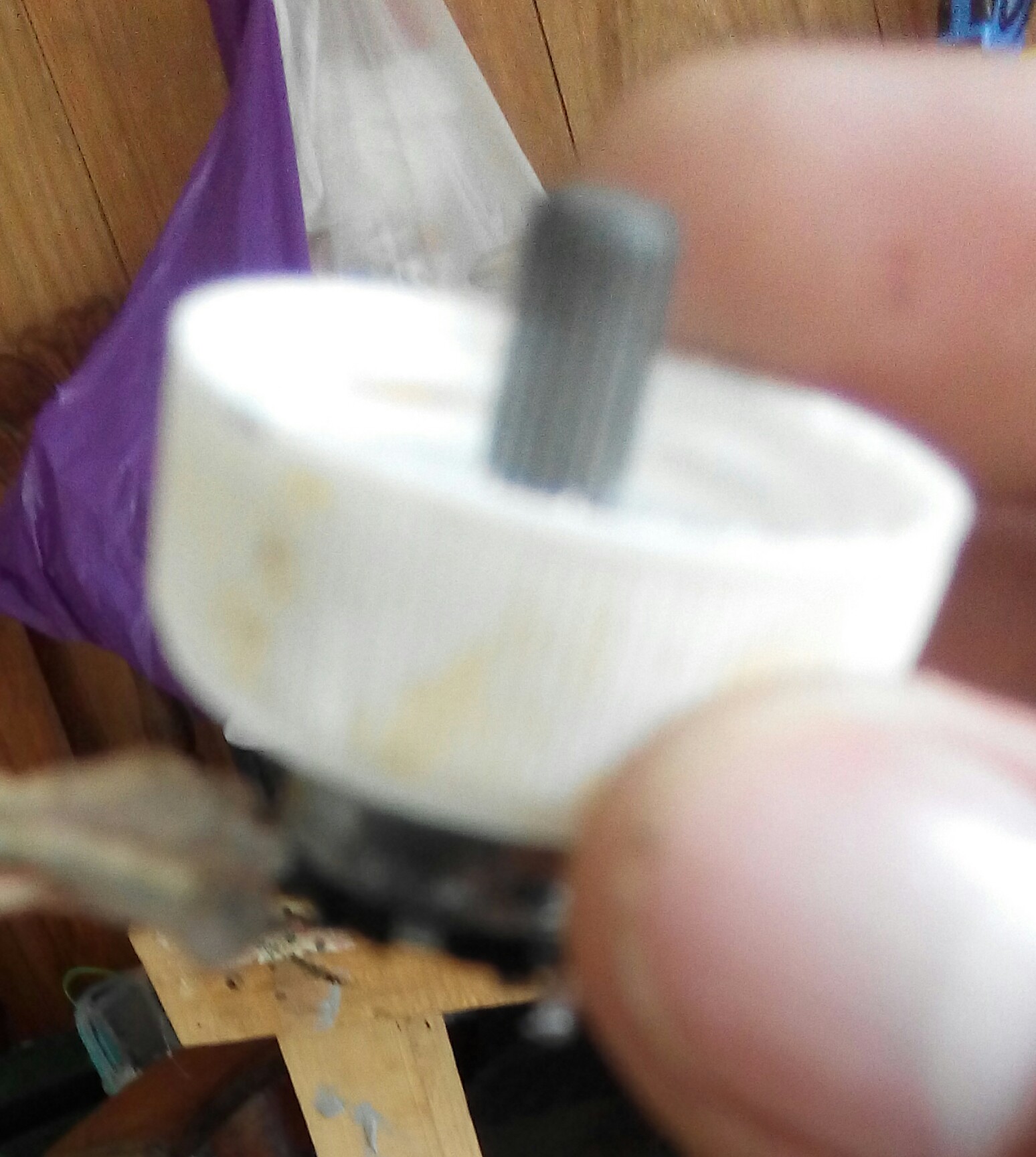

                I got some test on ordinary external pot and found that it survive my water pressure test..

                            • underwater from ordinary how to do
                              • Thanks kt315. I'll definitely try that. I have some APM Hexseals coming to try too. Looks easy to make most potentiometers IP67 or better.
