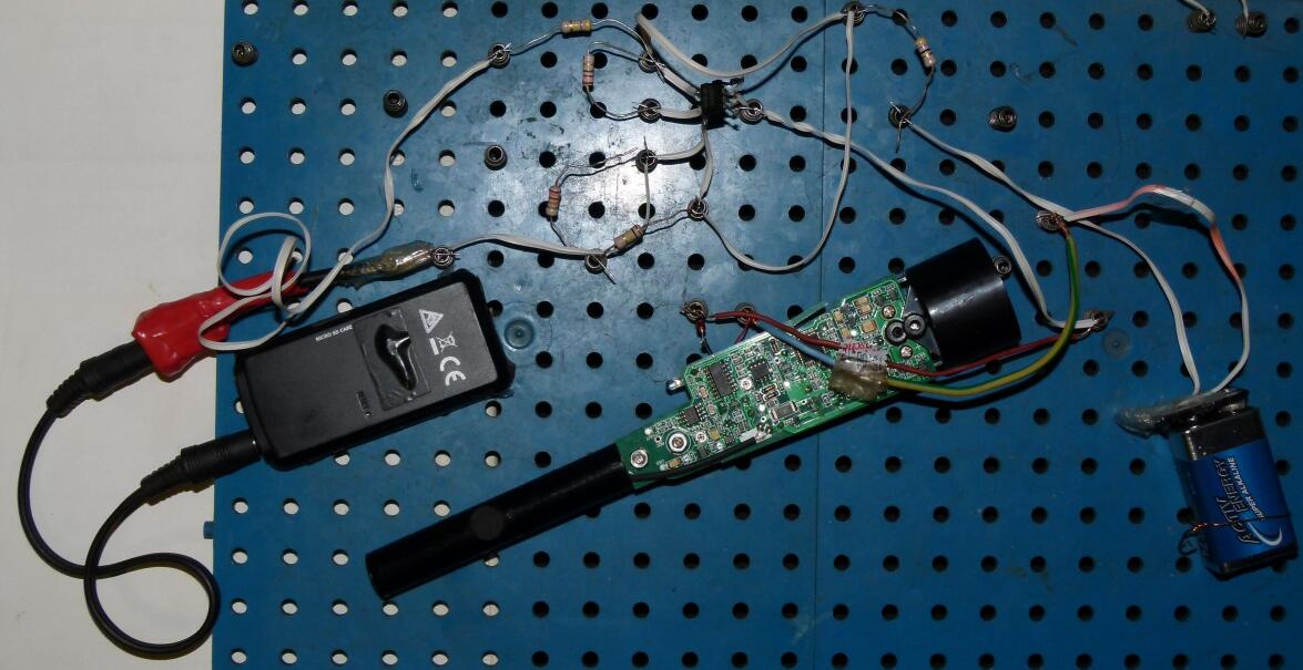

            here it is: Audio to vibration circuit!
            Good news!
            Today I was successful in creating that circuit.
            All whats needed is a common LM358N op-amp and a few resistors!
            It works already with pretty quiet audio-output from some not very
            loud mp3 player - it was at volume 16 of 32 when the vibration started.
            The crazy discovery:
            Before it starts to vibrate the motor works as some very silent and
            distorted speaker!
            No joke, its possible to listen somehow to the music via mini-vibration-motor!
            Because of the windings and magnets inside which work like an usual speaker.
            However this circuit so far is not perfect even if it works already
            fantastic to convert not amplified audio-out signals into vibration.
            If the audio is not connected it vibrates by itself all the time as long as there
            is not some 100k resistor connected between non-inverted input A and ground.
            But this reduces sensitivity alot (50%).
            And it doesn't work with all audio-devices because then it vibrates
            even if the audio is completly silent.
            Hopefully I'll will find out what's the reason for that
            but so far I'm enjoying my little cool invention anyway.
            Schematic will follow and perhaps its already clear for the experts here
            how it works.
            The pinpointer is not connected, only the vib-motor of it,
            the diode is not needed and instead of the 47ohm resistor
            also 10ohm works which makes the circuit even more sensitive.
            If you have any improvement ideas you're welcome.
            Enjoy!

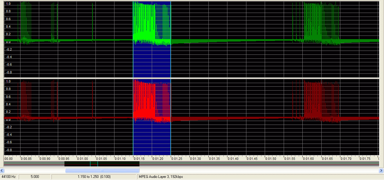

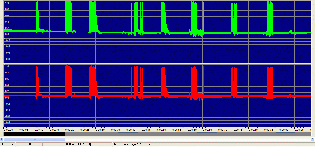

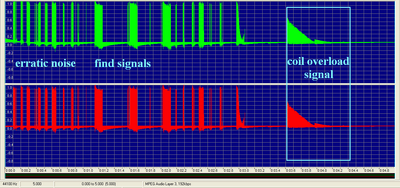

                        The timing method would be great to start the motor only if the audio signal
                        has a certain lenght. Those most of the time worthless erratic noises are
                        extremly short, perhaps 0,01 to 0,05 seconds.
                        Fainting signals may start from 0,1 second and real good ones may give some 1sec beep.
                        Motion detector signals - the non-motion beeps all the time as long as the metal is present.

                        At the moment the status quo is:
                        The vibration circuit works - but how high sensitive
                        in terms of metal detection depth etc. we can get it... ?

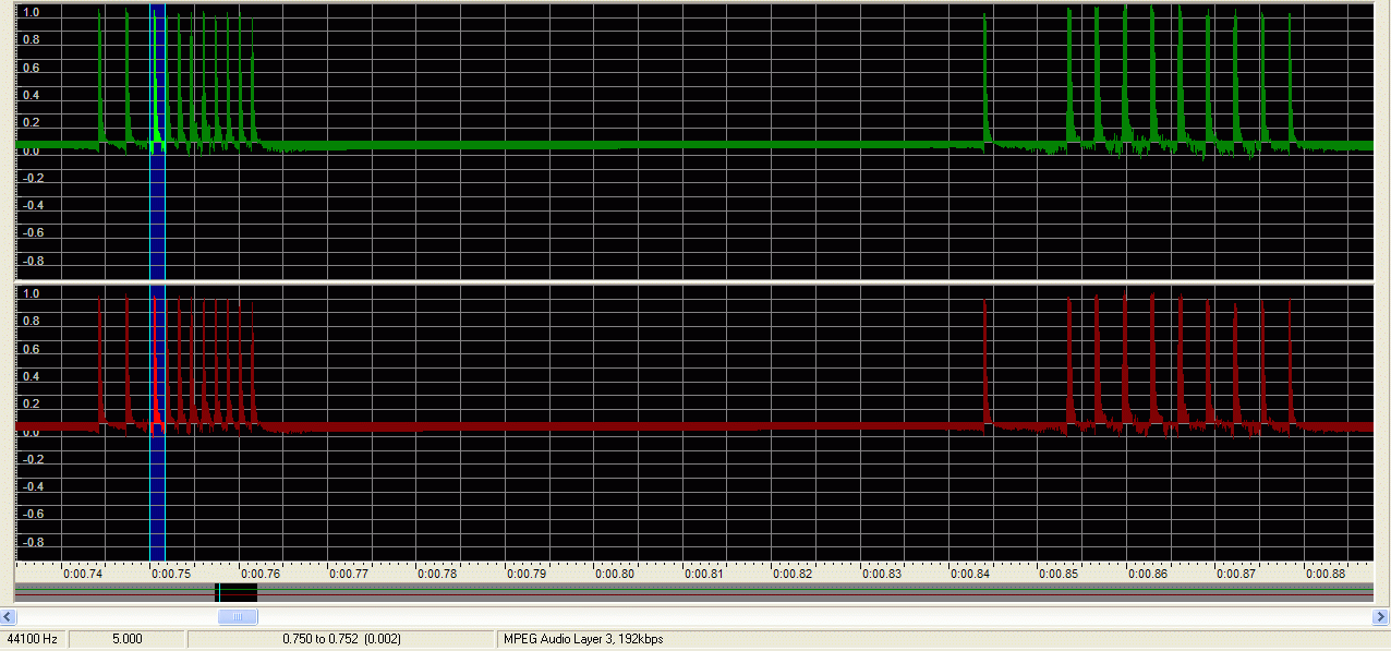

                          Attached are the audio captures of the Makro Racer with 40cm coil at higher
                          e-smog level incl. some usual detection signals which shows pretty good the
                          signal situation which an audioplug vibration circuit should be able to handle.
                          The 5sec mp3 is the recorded audio-output and the pix show the short timings.
                          One erratic-noise cycle lasts 0,002sec (2msec) with amplitude peak of ca. 0,5msec.
                          A find signal is exactly 100 millisec. long. Compared with alot other motion-detectors
                          there is not much difference.
