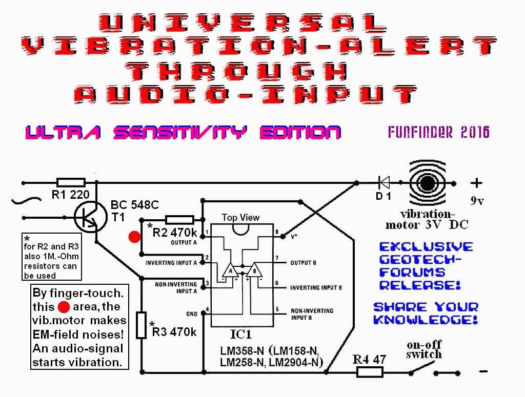

    Ultra Sensitivity Audio etc. Signals Vibration Circuit
    Thx to bernte I started again working on this stuff
    and that's why I can proudly present you now
    a real hell of an amplification circuit!
    Welcome to the Ultra Sensitivity Edition:

    I guess it's already too sensitive for the MDs audio,
    or better said:
    It needs additonal parts to receive a much better signal-input-contrast!
    The signal should become non-linear spreaded, so a 0,01mV audio signal
    remains that low, a 0,1mV signal gets amplified to 1V while some
    0,2mV "clear MD find beep" in the end shows up as 4v and
    only this one starts the vibration-motor.

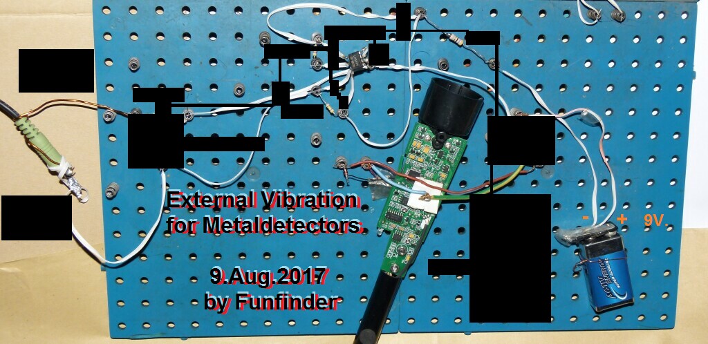

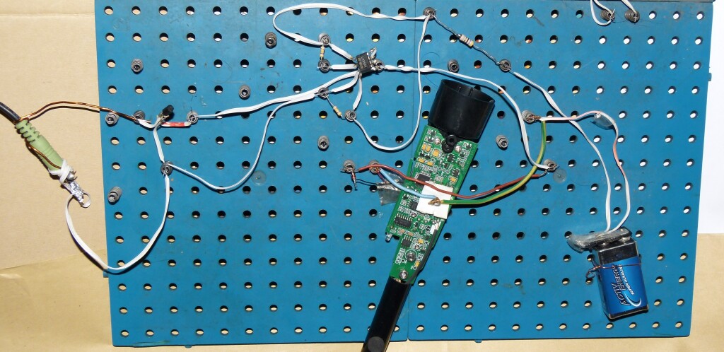

          Only 2 years later since I've started this thread
          .... and after another 20 hours of tinkering (yesterday)
          my genius mind finally figured out how it works!
          Bingo!
          It's great because from now on I can go treasure-hunting with the Jeohunter and
          DeepHunter including 1 meter coil and - drumsolo - I can listen to music nearby!
          But now comes the best:
          This circuit not just works with Audio On - Audio Off signals - no no ...
          It even works with the Garrett ACE beeps and pinpointing signals !!!
          As long as the signals are not to short and weak it might work with every detector!
          And it works also with very weak signals as long as they are clear enough.
          But I'm not sure if I should post the schematic here because patent-reserving and copyright
          greedy idiots could grab it and make big business out of my invention - which is very unfair!
          It has to be at least protected as open source or something like that.
          If we compare it with Red Bull - the guy who invented this surely not pretty healthy crap
          meanwhile is multi-millionaire (but of course it's not the only energy-drink on the market).
          And many MDs are completely overpriced, too! So we need some better solution.
          Perhaps Carl (here) wants to patents and afterward provides it at the forum for free.
          Anyway - at the moment I'm super happy that this project is successfully finished!
          Another disturbing "long time ago"-problem thrown out of the way to lust and pleasure!

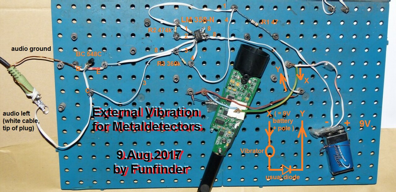

Name:	tinkering setup.jpg

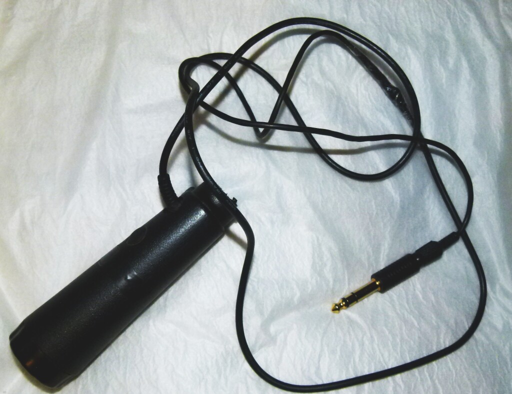

              You can start with the already above posted schematic:
              http://www.geotech1.com/forums/attac...chmentid=33552
              and add a transistor as input stage.
              Don't let yourself get tricked by the field effects - this thing while building also reacts
              if you just come with your hand near the audio cable!

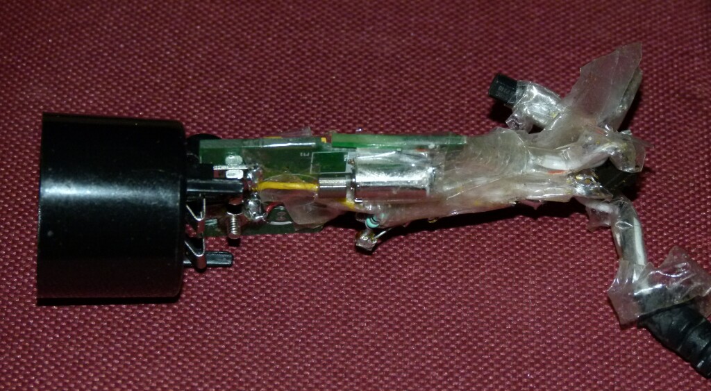

              And as a housing with vibration motor already mounted on the PCB
              you can use some old or faulty pinpointer:
              I have removed only the 2 vibration-motor cables from the PCB, did cut it
              into half and made the battery contacts stand alone (no longer PCB powering)
              The variable resistor really has to have 500k or you better
              use a fixed one with something from 100k upwards.
              You have to find the limit at what value the circuit doesn't
              vibrates just by itself or just when 1 audio cable is connected!
              This "vibrating-by-itself" was an absolute motivation-killer for me
              and I needed some drinks to remain calm and patient!
              In the outside the circuit was self-vibrating with a 220k while
              inside the housing all of a sudden this resistor made the circuit too insensitive
              (vibrating only with strong signals).
              But you should get it working since I've told you now what is to consider.

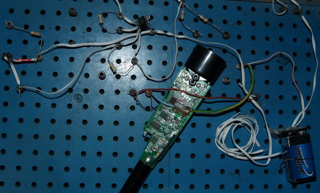

              PS: And if you got it to work with (or without) my help you can make a big business out of it!
              That way at least it's someone from us and no damned patents-greedy rip-off-company!
                And, so that it works:
                Only connect ground (shielding wires) plus the tip of the audio-plug
                which represents - if stereo - the white cable alias the left channel.
                  Forget that schematic - after checking out what transistor I have in use
                  (because this project was paused for 1 year) I saw that the layout
                  meanwhile has changed a lot - only the chip is still the same.
                  Connecting the plus pole only to the chip was a not good enough signal contrast solution.

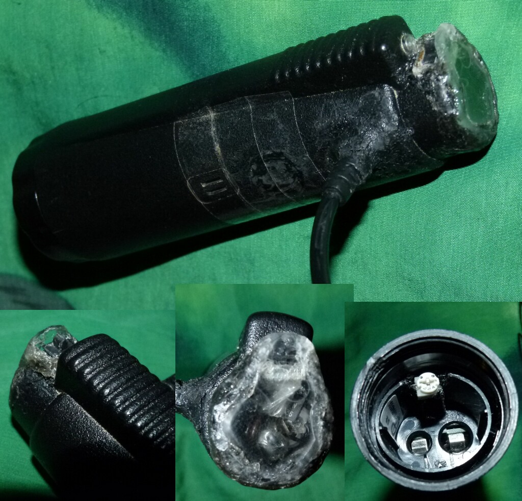

                      Some more hours of work and: the vibrator is ready! Yeah!
                      On-Off switch and variable resistor for fine-tuning added.
                      Tests - so far (living-room with much electro-smog) :
                      works with: Jeohunter, Makro Racer, Euro-Ace and Ace 250
                      works pretty bad with: Blisstool
                      works not with: DeepHunter
                      weight incl. 9V block, without cable: 125grams
                      cable length: ca. 125cm
                      There exists 2 detection options:
                      1. Lower sensitivity:
                      The motor is off and starts to vibrate if the signals are strong enough.
                      2. Higher sensitivity:
                      The motor is running super slow and silent all the time and if the signal-level
                      raises just a little bit, the vibration becomes directly really intense.

                      So if you hear the vibration-motor singing, you're on the right track!

                            External Vibration for Metaldetectors
                            OK, you had enough tension and suspense . . . . .
                            ... on the psychological torture-rack!
                            Hope you enjoyed it!
                            Meanwhile the copyright and all rights reserved are settled.
                            Which means primary the idea of any external MD-vibrator itself,
                            because this is my invention. But naturally it's still possible to
                            improve the circuit, add dongles, making it wireless etc.
                            Of course my circuit is free to built for private persons
                            and if you wanna give it to your friends, just do it.
                            This is a market-niche product anyway!
                            Its for pretty fearless treasure-hunters who wanna enjoy
                            hearing interesting audio-books or loud music while hunting,
                            its for those who wanna have a total different experience!
                            I've created meanwhile the schematic and made it exclusive.
                            But you may get it later nevertheless.
                            For now: I'm sure you like a reverse-engineer challenge!
                            You can draw it on your own, post it here and I will tell you
                            if its correct. This gives you much more success-feelings!
                            And now finally - DRUMMMMMMS - here it CUMMMMMMS:
Name:	External Vibration for Metaldetectors 9.Aug.2017 by Funfinder.jpg
                            Additional technical info:
                            - "usual diode" means: fast signal processing glass-diode
                            (not the black ones, often used for power-adapters)
                            - the variable resistor for fine adjustment is placed
                            directly before or after R3 and has 200k
                            - Vibrator means: usual pinpointer vibration motor (DC, ca. 6-9v)
                            - IC pin8 has no contact with pin3
