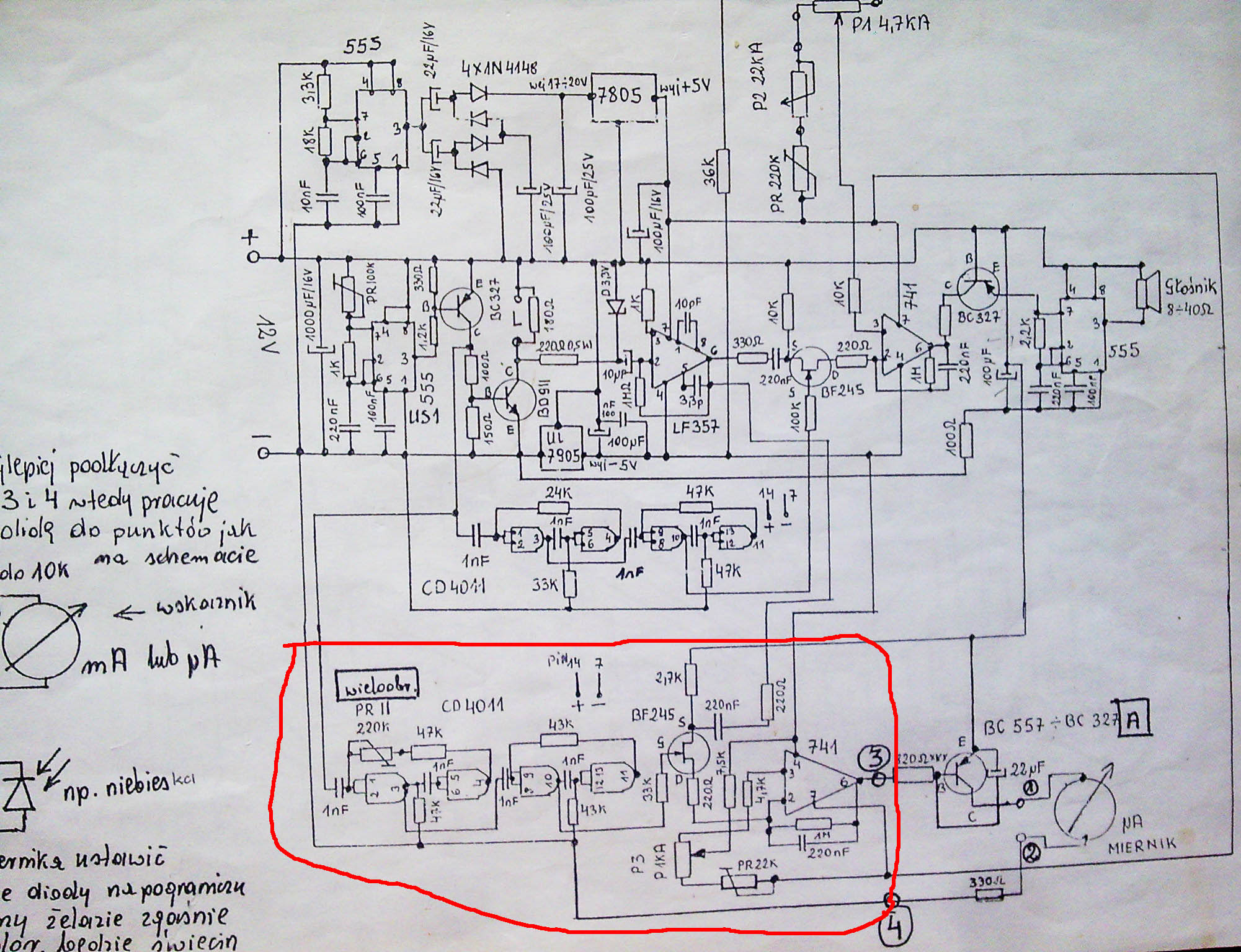

warning - do not connect a probe of the oscope to a coil, or to DRAIN pin of mosfet, another way you get a trouble. connect on output of preopamp. but better would beOriginally posted by daverave View Posti just ordered the mini oscilloscope kit that you showed...i dont really have extra room in my surf pi housing for extra electronics for another sample circuit...so i will try the oscilloscope method but i will have to get a project box with a transparent window for the scope...not sure if i can a ready made one ???
connect to schema i uploaded -- phasevariator + BF245 + opamp, then you get a possibility to choice a optimal point on the decay for the discrim.
at first connect to output of NE5534. if you do not see a result (no visual lucid disc) then add this circuit. you can take
the similar part from surf PI schema (phasevariator U4C/D/B + BF245 + opamp).
or only add U4D/B, also be connected to U4C and change R28 on a pot, i think ~470k.
hi Dave, not mine matter. alien schematic, alien issue. i am not pole to be in the subj and answer to you.
alien issue always is suspecting full lack of detailed data. this is rule. registered in polish forum to find up something http://www.poszukiwanieskarbow.com/F...4183d17cffce0f
be cause the forum is closed from aliens and no access to threads simply clicking.
NOTHING. as exspected. looks you have to experiment yourself learning a reaction on metal on pocket o-scope screen.

i got my mini scope today just got to build it....it only cost £15 uk pounds which is very good value...just got to find a box now with a window for the display...which will not be easy cause of size of pcb...i may build that disc circuit on verro board and experiment as you said.
