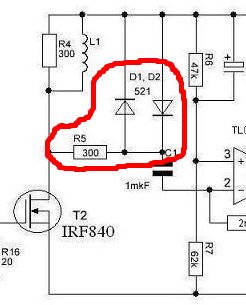

    An aspect of PI design has been stuck in the same place since 70's. I'm talking about the series R-D combination for probing the decay signal at the coil.
    Examples:
    This design suffers from many drawbacks:
    - the R-D acts as a delay line because of the diode's capacitance, this adds several usec. to the earliest possible sampling time.
    - the damping resistor is lower than it should be because it's in parallel with R during most of the transient (when D is conducting). This adds further usec. to the decay (and sampling) time.
    As a result, sensitivity and signal/noise is horrible.
    The use of this deficient solution to this day shows the lack of commitment by competent designers to PI technology. Where are all the brains?

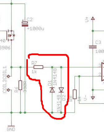

    Here's the frontend I've been using for a while. Need to redraw it at some stage.
      You replace R by a controlled switch SFT1440. The gate-source capacitance is large, the rising edge of the switching pulse will inject a sizeable charge into the source, which charges the capacitance of diode 1N4148. This charge will slowly decay. In fact you're adding a second transient to the coil's own transient and won't be able to sample a meaningful signal until this added transient decays. Whether you're better off in the end with this design remains to be seen.
      See "Clock Feedthrough and Channel Charge Injection" here.
        Works fine for me, easily able to sample at 8us and has less noise than the normal RxD method.

          I believe 8us is achievable with your solution. That leaves a lot of room for improvement though.
            Here's a pic at the output of the amp.
            TX is powered with 8 volts and is 120us wide into a 0.5ohm ML coil. The first sample can be taken at 8us.
                  Examples:

                    Well if I change out my circuit for the traditional resistor + diodes frontend I can't sample any sooner than 12-13us.
                    If you think you have built something better, post it here so we can see.
