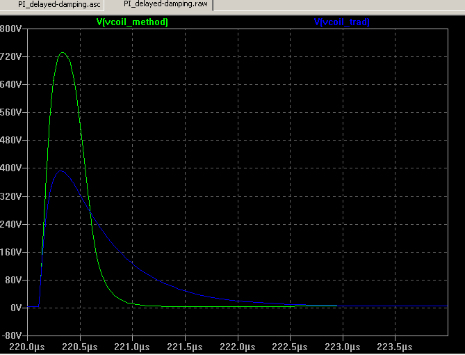

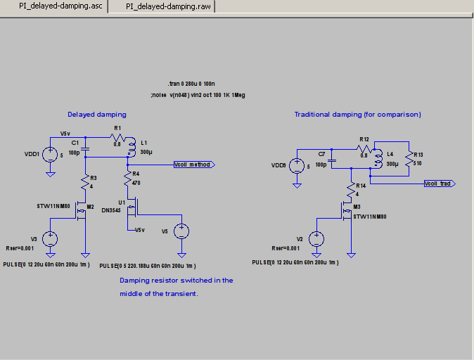

            - Delayed coil damping. The damping resistor is connected to the coil somewhere in the middle of the transient, not from the beginning.
            Advantage: the first part is a fast oscilation half-cycle (a little less), then the voltage lands softly (critically damped) during the second part. Since the eponential starts at a lower level, it decays faster.
            Here's the idea simulated on LTSpice. Green: my method, Blue: traditional damping.

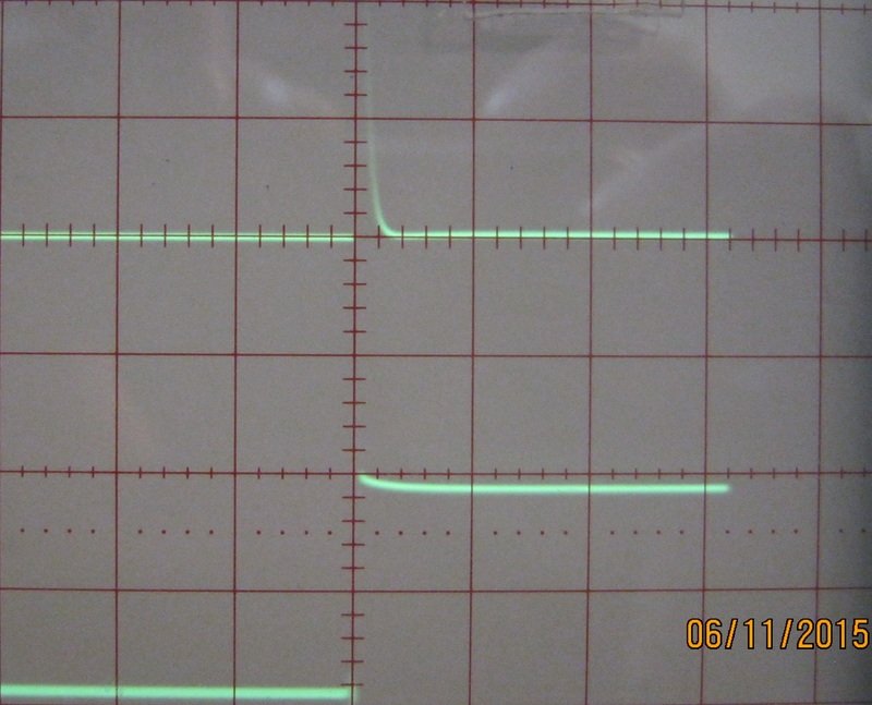

              Hi Teleno, real life sim. Similar implementation to your circuit but not exactly the same.
              First PIX damping resistor only.
              Second PIX my version of switched damping.
                Teleno and mickstv. Thanks for the discussion. Focusing on the transient that occurs at tx off is important. Sharing ways to shorten the duration, will hopefully sink in amongst members and encourage movement away from traditional kilohm R input and diodes - that does nothing but hide and mask so much target response. Far better to learn how to deal with the problem at "source".

                    Interesting idea.
                    Can you please post the LTSpice files?

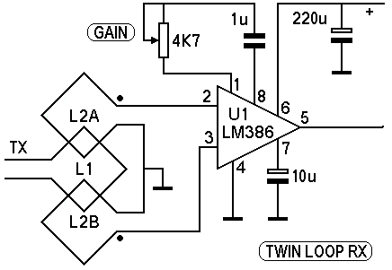

                        Just one example; PI detector with two separate coils, separate coil for TX and separate coil for RX. Now, the RX part is done in different manner.
                        No need for resistance and also no need for clamping diodes if RX coil is projected in a way to attenuate induced current by it's morphology (less induction). Or balanced with RX coil in a way to achieve less induction.
                        Now, such two-coils approach is open for more ideas, special ultra fast clamping diode still can be presented there since it will not produce delay as in traditional approach.

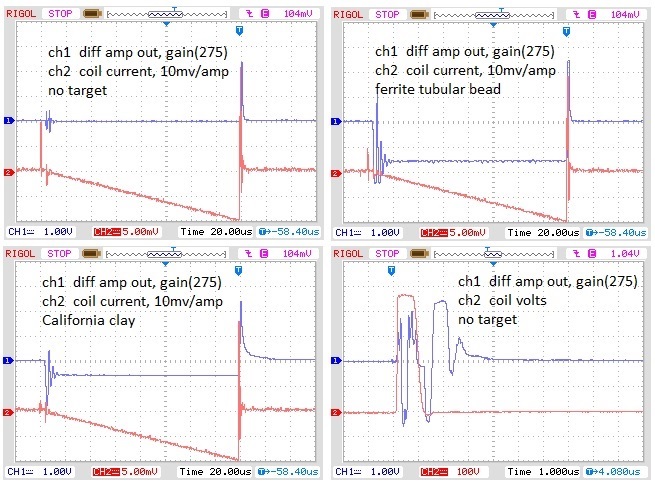

                        Made a small o0o coil for charting short time constant targets. Two Rx coils side by side(wired inverted to induction balance) with a Tx coil wound around them. I can adjust the coils for zero out during coil on but not during coil discharge. Should I be able to get zero out during discharge? So far using a diff amp and induction balance seems to work best for me. No diodes or series resistors. Back to back diodes across the coil don't seem to work, probably because I can't get zero volts during discharge.
                          Interesting test Green, MikeBG proposed something like this a while back, if you are useing a 5534 as a preamp, according to the data sheet the ne5534 actually has internal diodes across pins 2-3.
                            Using diff amp in http://www.geotech1.com/forums/showt...967#post205967. Some improvements were suggested. Haven't tried them yet, still using the first one. Mike shows the center tap of Rx grounded. Tried both grounded and open. Don't remember seeing a difference, maybe I should.
