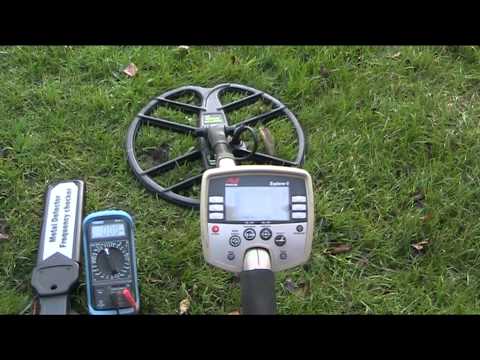

              There are some failures in frequency of Minelab Explorer SE, E-Trac and Quattro. They can´t rich 100 kHz It is from 12.57 to 16.16 kHz. See this video around 3:00 minutes.

                      There are some failures in frequency of Minelab Explorer SE, E-Trac and Quattro. They can´t rich 100 kHz It is from 12.57 to 16.16 kHz. .
                      and what you want to tell me about??? peak voltage in PI delta pulse has 1000000xxxx Hz reached by harmonics. we say and mean about ONLY WORKING/USED/PROCESSED RX signalfrequencies. not about your dreaming. NOT ABOUT THE HARMONICS. be MORE grounded in this matter and not be so zombie.
                          Thank´s for your nice words kt315.
                          To you kt315 I wanted to say : "Thank you for this data´s of different frequency-detectors." Not more.
                          To gl1945 I wanted to say: "Attention, if you will buy a 100 kHz-detector you can not buy a minelab, because it has only between 12.57 to 16.16 kHz."
