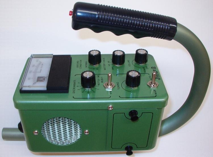

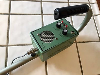

    Compass Yukon series,77b,77b automatic,94b,judge,judge2 etc. I believe were all 100khz detectors. Some of them were made as hipmount which would really look good hunting on a farm not to mention light on the swing.

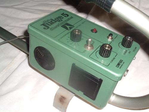

      I have a 94b and a Judge5. The 94b is slightly more sensitive to gold, but the Judge5 ignores iron slightly better. 94b is a very simple one-sided, single board. It is small, simple, and very light. If I were to mod/re-manufacture either, a more sensitive handgrip-mounted tuning pot would be a benefit. This is affected by ground effect. The 94b auto may have overcome this problem somewhat. The Judge 5 is a 2 board design. It is slightly simpler than the Judge 1/2, which has auto-tune, but the Judge 5 does not.

      I think I read on Compass forum that the Judge is 5.5kHz(??)
      The 77b apparently is the ducks guts of the early Compass's.
      The fact that there is a whole forum dedicated to these detectors is an indication of their popularity.

              100kHz, Button reset, ground balance- Maybe Compass 94b auto, 99b, 77b auto. And some of the Judge series(think these are 5.5kHz though).
              The Judge series may have better depth than the 100kHz. They also have a discriminate knob that can dial out bottle caps and other iron composite metals.
              They don't call these things "iron killers"for nothing.
