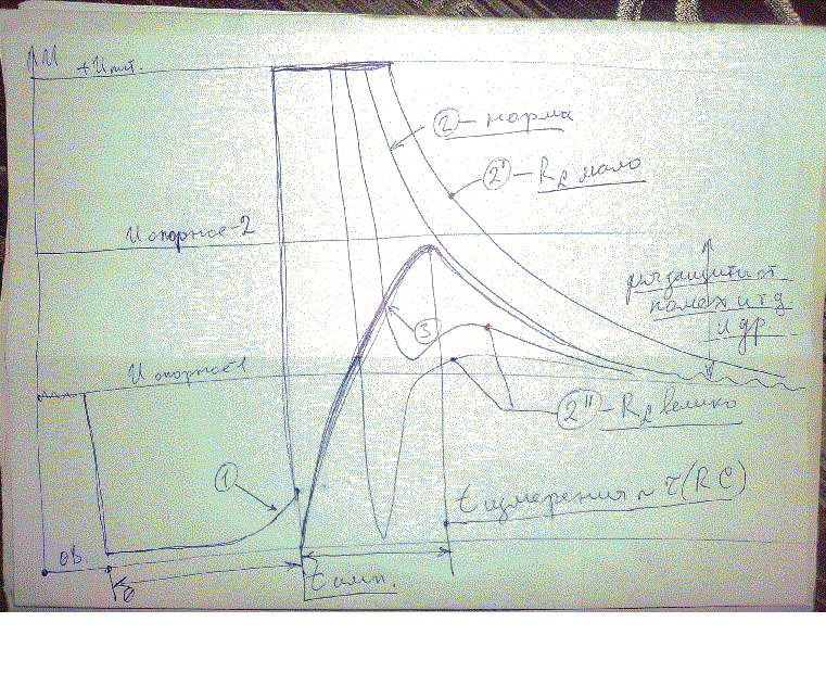

            russian sketch, not mine. all damping R values vs the signal

                Most of the information is here. However, it is scattered everywhere and is normally only brought up when there is trouble. I am not having any trouble so to speak, was mostly curious what higher/lower values of the dampener resistor signified with the coil. I am enjoying the learning experience! It would be nice to see a write up of using the scope to test and check these pi machines out. Test points, screen shots of what it should look like etc.

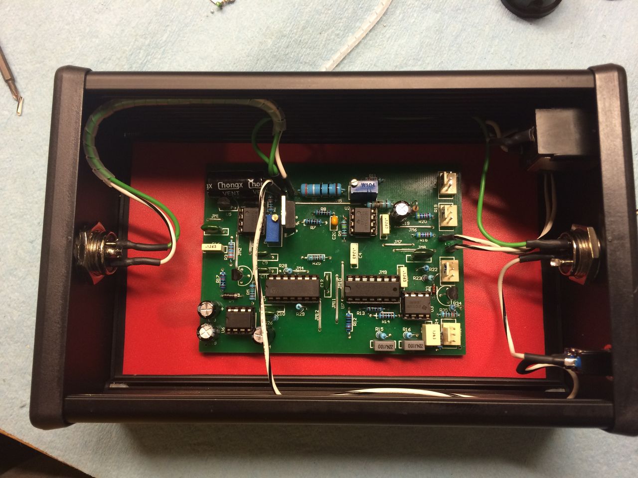

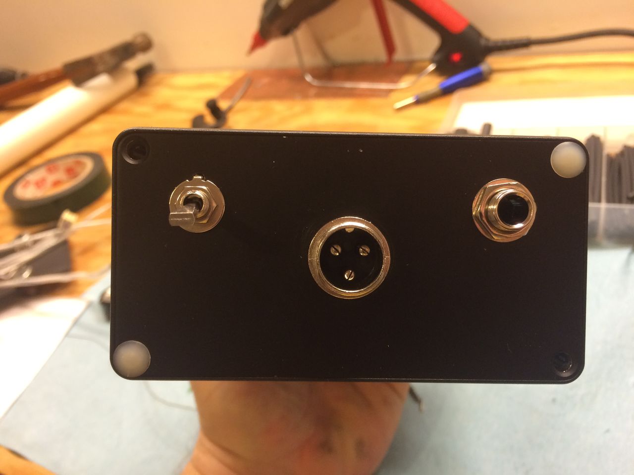

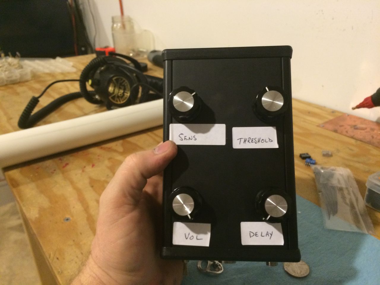

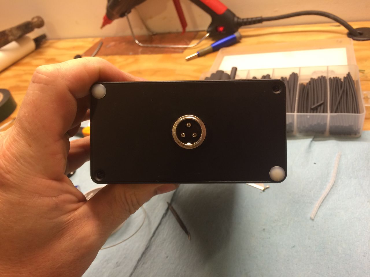

                            May as well post a few more pictures of the build, not sure what I am going to do with it, have too many detectors already.... just something to pass the boredom. The labels are temporary. As far as messing with the coil dampening too much I am going to finish the coil off first. Just wound a 9.5 inch spiral, gets 14 inch on my wedding band for now.
                            Used a 3 pin connector so I could use the battery pack from my Macro C77. I will make another when I get a chance for 3 x 18650

                              By the way, comparing the TX oscillator output with the preamp output allows you to determine the earliest possible sample time. You should then move the channel 2 probe from the preamp output to U7a pin13 (which is the main sample pulse). You can then adjust the delay time to the required value.
                                hello cddz,
                                nice build, which type of Hammond enclosure do you use 1455xx?
                                at first look i think the is enough space too but one pack o 3*18650 with internal charger bord you could add a siwtch on/off/on to selct between detector on or charger on
