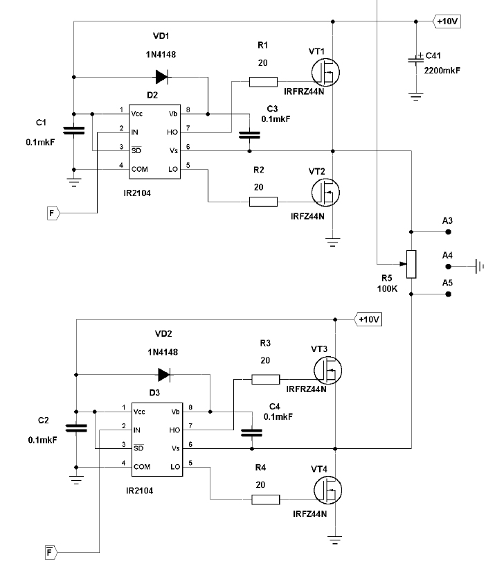

        • half brigde + half bridge you get a bridge
          this driver from Koschej. you can use it with resonance coil or un-resonance coil. you may call your detector either PI or hybrid - on your choice.

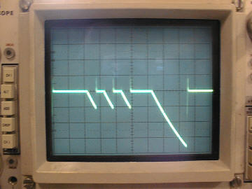

                              For those still interested in what BBS/FBS is, here is the voltage & current waveforms:
                              I've posted this a few times in the past but it doesn't seem to make much of a lasting impression. Look closely at the current waveform... see any 'off' time? Pretty continuous-looking, eh? This is why I posted that 2-frequency sinusoid and asked what is it? and how would you process it?
                              P.S. -- if you think my Visio art might not be an accurate representation, I've also measured the waveform with a current probe on an oscope. Same thing.
