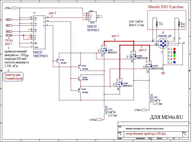

              Fisher Impulse is not PI. it has halfbridge TX driver like you can see it in CZ5/6. if fisher impulse is PI then CZ5, MXT, DFX,
              Elite::GT, Explorer, Vision v3, etc are too PI, but they all are not PI.
                kt315, the Impulse is pulse induction. The CZ is IB VLF technology.
                I know what they are. I designed them and my name is on the patent which describes both technologies. The Impulse circuit is posted in the schematics forum, and I think the CZ circuit is as well.
                I also designed the circuit (but not the software) for the White's DFX and Surfmaster. Also IB VLF technology. And, the MXT (circuit and software) which is sinusoidal single-frequency.
                The Minelab multifrequency technology that began with the Sovereign is not pulse induction, it is induction balance sequential multiple frequency.

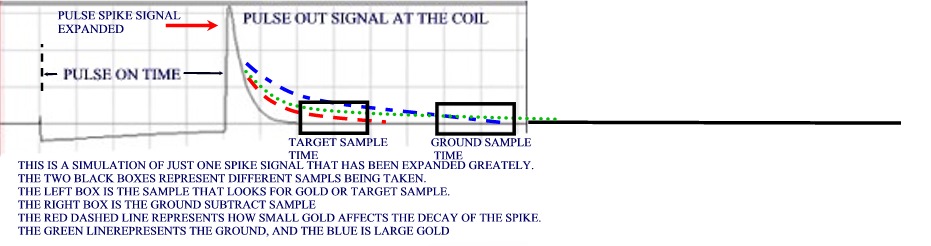

                  ok. let me look on tx o-scope pics from the fisher on a coil i could REALLY see what you mean. if there is the "delta pulse" - you win.
                  anotherway - satisfaction.
                    pulse induction signal
                    I reminder WHAT is THE pulse signal.
Name:	EXPANDED PULSE SIGNAL simulation.jpg
                      this is FULL-bridge TX driver of Sovereign XS. in your logic it is not PI, but HALF-bridge driver in firsher impulse is PI.
                      nonsense, Dave....
                        un-sinusoidal. driver is working in impulse mode, a coil is un-resonanced. if you insist that is not let me see your schematic.
                        • #42
                          KT315, what you post, is only one of very classical PI design presentation.
                          Signal shape on TX coil could not be only decisive, if some MD design suit to PI or CW.
                          Decisive is how signal is processed in MD Circuits.
                          If we have Time Controlled Receiver (Time Domain), then we are talking about PI technology.
                          Does Fisher Impulse has Time Controlled Receiver? From my point of view (apart from that I 100% believe in inventor), yes.

                            in your logic any VLF is PI just cause has the TCR )))

                              pi transmit page 143
                                Nearly all single-frequency metal detectors are sinusoidal. If you don't know what the MXT is, I know with absolute certainty it's sinusoidal because I designed the thing and it's still being manufactured that way, so why are you arguing with me about it? I usually expect smarter behavior on this forum.
                                The Minelab circuit and waveforms and patents have been around for more than 20 years. The "BBS" etc. technology is not PI. It is sequential multifrequency. Has nothing to do with half-bridge or full bridge, I've done both PI's and VLF's both ways, there's a full bridge switching nonresonant VLF sitting on my desk right now. I've been doing this stuff for a living for 35 years with successful products under a whole slew of different trademarks, it's not like I'm clueless.
                                If you don't want to believe me about anything, there are other folks here who also know their stuff, you can learn from them.
