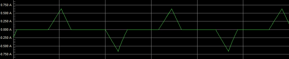

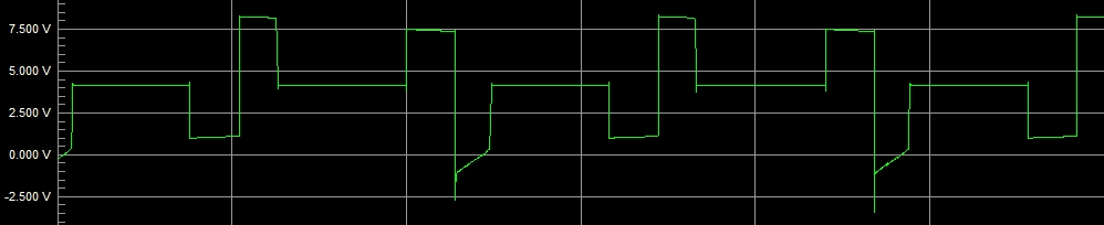

    hello all..............
    just thought i'd post a picture,
    I simulated the TX of the fisher impulse a while back,
    hopes this is a close representation dave.............

    • #47
      That looks about right, DOOLEY. The current waveform is alternating polarity triangles separated by off periods. The receiver gates on during the zero current periods. Searchcoil is mono, although I've done induction balance with similar transmitters.

        First of all, congrats for your successful career doing things that you love to do.
        One question... the triangular wave has a much slower decay than the usual high-voltage transient. How did you manage to get decent signal from small targets with such a sluggish decay? It's counterintuitive.

          ah,
          coil current picture below...........
Name:	FISHER IMPULSE CURRENT.jpg

          yes,
          I was wondering the same,
          thought FAST switch off would give a better target response ???

            Good question, there's a lot that the circuit does that's counterintuitive. But alas..... since I'm still on the payroll there's only so much I'm at liberty to divulge.
            Part of the answer that's not counterintuitive, is the high rep rate. The emphasis on low conductors (our representative target was the U.S. 5 cent "nickel" coin) made the Impulse target response really muddy on high conductors like silver dollars.
