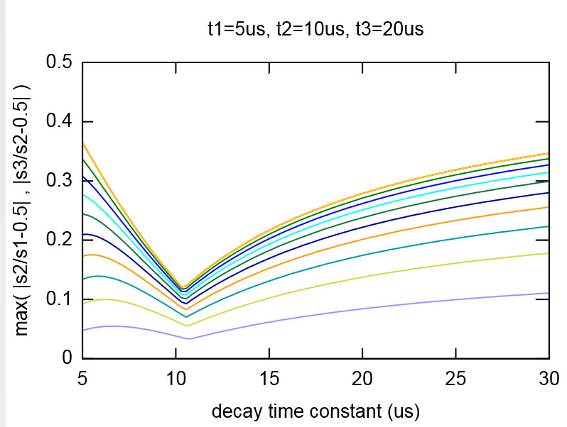

        Holes can be avoided by processing 3 consecutive samples as follows:
        where
        and
        Plot for different ratios of target to ground signals (orange: 100% target, green: 90% target, 10% .. and so on).
        • Yes, I saw this in the other thread on GB holes and it looks very interesting. In a practical system, I presume all three samples are narrow and of equal width. Am I correct in thinking that movement of the coil in earth's field is cancelled in the s2/s1 and s3/s2 operations? It looks to be so as the amplitudes will all be the same over that time span. Target ratios could be extracted for target ID of coins. Ratios should be fixed for non-ferrous objects when scanning coil over them, and variable for ferrous?
          Eric.
            EF should be subtratced form each sample before the calculation.
            I guess ratios could indeed be used for target classification. In any case that's beyond the purpose of this method which is simply to cancel the ground signal.
            Ferrous response in the time domain appears to be in the form of a power function in early time and a decaying exponential in late time.
            See eq. 8 in this paper: Subsurface discrimination using electromagnetic induction sensors.
            Still not figured out how to handle this.

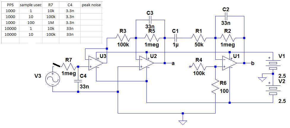

            • Wondering what effect sample rate and % sample time has on integrator output noise level. Thinking of doing an experiment. Including schematic of test, replace V3 with input amplifier. Test with amplifier input shorted and with a 8inch mono coil connected to input(Tx off). Any thoughts on the test or what I should expect? I've searched but haven't found anything, maybe someone knows where to look.

                Integrating many RX signals improves the signal to noise ratio. See this web link: http://www.thinksrs.com/downloads/PD.../AboutLIAs.pdf Also do a web search on "lock-in amplifier tutorial" to see other on line resources. Since the integrated RX signals are synchronized with the TX signals, a PI detector that integrates many signals while the coil is over the target takes advantage of the principal of the lock-in amplifier. The limitations and trade offs are (1) the diameter of the coil, (2) TX frequency, and (3) sweep speed that all determine how many pulses are integrated while the target is being detected. If your TX pulse rate is 3K PPS to 10K PPS then you could be integrating from about 1000 to 3000 pulses depending of how fast you sweep over the target. Target size and coil size then also become critical variables.
                Eric Foster used this method to beef up the RX side of detecting rather than just pump more energy into the TX pulse to make a more sensitive PI machine while still operating at a low delay.
                I hope this helps?
                Joseph J. Rogowski

                  If the pulse rate is increased from 1000 to 10000, how much less is the integrator out peak noise level(1/3, 1/10)? Does taking a 10usec vs a 1usec target sample lower integrator out peak noise level and if so by how much?
                  [Lock-in amplifiers use a technique known as phase-sensitive detection to single out the component of the signal at a specific reference frequency and phase. Noise signals, at frequencies other than the reference frequency, are rejected and do not affect the measurement] from above link
                  What is the reference frequency and phase signal we are looking for with a PI detector?
                    The RX signal is delayed until the TX flyback pulse and damping subsides that is at a constant phase with the TX signal which is also the reference frequency in a lock-in amplifier comparison. Noise is a broad band signal source but the integrated RX signal is only detected consistently in the same location on each cycle. It is the number of integrated signals that determines the ultimate improvement in signal to noise ratio. Once you lay out the TX and RX signal on a pulse train drawing and create a good mental model of how and where the PI detector senses a target, you will see the similarity with how a lock-in amplifier works to extract a signal in the presence of noise. Repeated for emphasis: how many samples are integrated indicates the potential signal to noise improvement.
