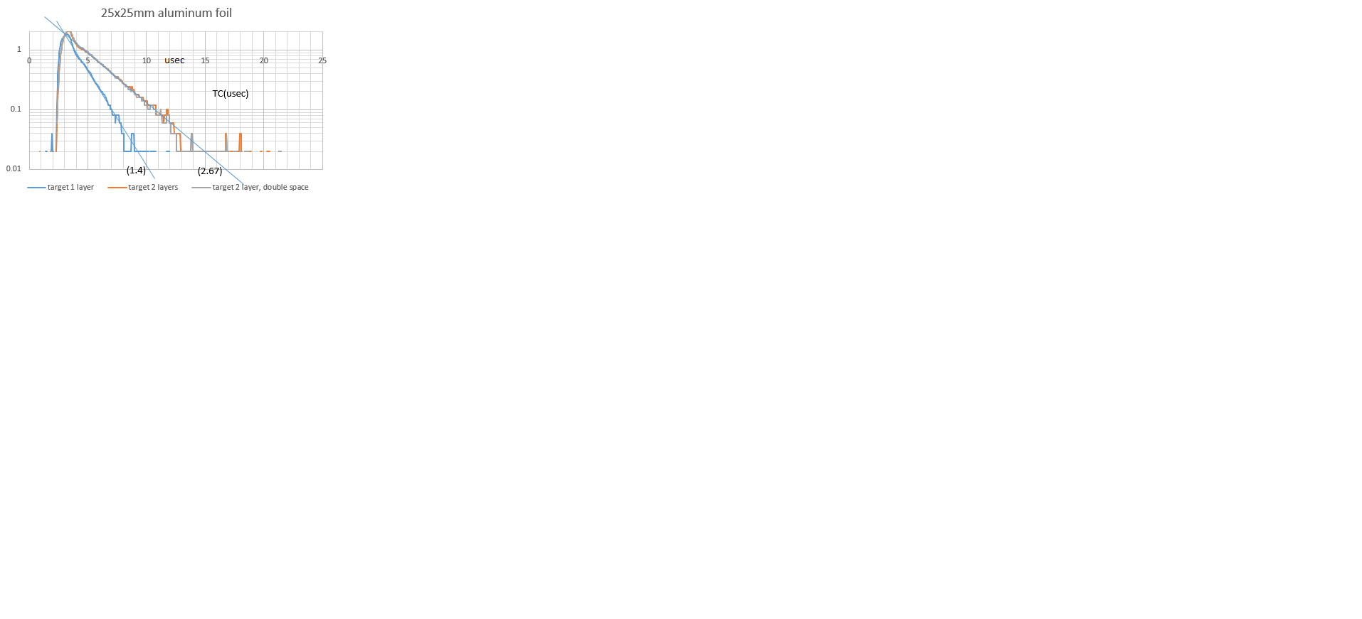

        • Glued household aluminum foil to some poster board(.28mm thick). Cut two pieces 25x25mm. Charted one piece, two pieces(foil touching) and two pieces (poster board touching) all same location about 55mm away from center of coil. Expected to see a greater TC difference with poster board touching.

            If I understand correctly, the two squares of foil were in surface to surface contact (foil touching). The electrical contact between the the two would have been anything but good unless the two were mirror flat and pressed tightly together. The points of contact would be such that the resistance would be relatively high between the two with the result that the eddy current pattern would be exactly the same as if they were electrically separate (poster board touching). By contact resistance being relatively high we are talking tiny fractions of an ohm across very tiny inductances. The contact resistance would be large by comparison.

              The squares were stacked with foil touching or poster board touching. Reply #120 you replied three coins stacked touching were the same as three coins stacked with cling film between them. Do you think foil twice as thick would be different than the two pieces touching? I wondered if a thicker space(.56mm) between would be different. It wasn't but maybe foil twice as thick would be.

                  On the spacing issue, you probably won't see much difference with only 2 layers and 0.28mm space. More layers with small spacing, or few layers with larger spacing will show a TC change. Try taking 2 pieces of foil and space them at 0.25, 0.5, 1, 2, and 5 mm. When I make my stacked target standards, I sandwich them pretty tightly in clear packing tape. There is no vertical current flow between the layers (during flat detection) so getting a low resistance contact isn't important, but minute gaps do matter as you get more layers.

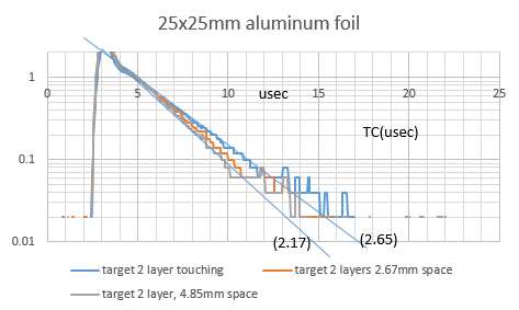

                      Another test with thicker spacing(2.67mm and 4.85mm) craft foam + poster board spacer. Including chart(test 1) with .56mm spacing.

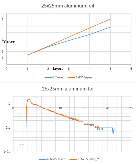

                          Thanks, I tried glue method reply #129 this morning with 1 thru 5 layers to see what it looked like. Charted TC vs number of layers and a line(TC of one layer*number of layers). Tried your method this afternoon with 5 layers to see if different. Same TC, I think your method is easier. 5 layer_2 is your method. Was looking at 5 layer_2, looks like I got some air trapped inside when I covered with the clear tape, could be more space than the glue method.

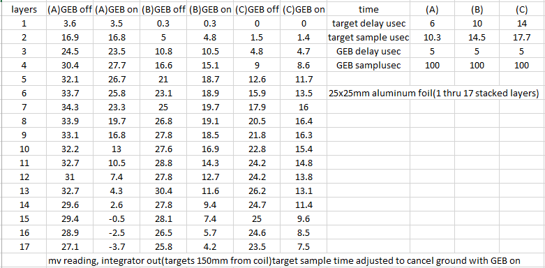

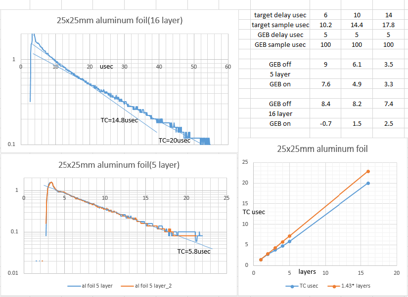

                            Made one with 16 layers, minimum trapped air. Thick enough that it doesn't chart a straight line on a lin log chart. With the right Tx waveform it might. TC depends on where the samples are taken, 10 and 20usec(TC=14.8usec) 20 and 40usec(TC=20usec). Not sure it matters, try each target to find which one reads the lowest(hole). Need to make the rest including some over 16 layers. 16 layers isn't enough for longer target delay times. Including chart with some data for the 5 and 16 layer targets. GEB(off, on)data, integrator out mv with targets at 200mm from coil.
                            • Made more layered targets. Charted integrator out at three target delay times with GEB off and GEB on(aluminum foil_5) One and two layer(1.4 and 2.8usec TC's) are a lot better with the 6usec target delay. Eight layer(10usec TC) about the same as a US nickel is a little better at the lower target delays. TC chart,(aluminum foil_4)
                              • A couple numbers to help use data reply#134. Bigfoot style coil Rx(two 8 inch round coils), Tx(oval coil surrounding Rx). Increasing the target distance by 30mm at 200mm start distance reduces the signal in half. Ball park(lose or gain about 30mm detection distance each time signal is reduced in half or doubled). GEB on doubles peak noise level with my circuit, lose about 30mm detection distance. Wondering if typical for GEB to double peak noise level. Lot of numbers to look at. Trying to make sense out of them. It would help to know what real targets would fall in the holes for the different timings(A) (B) (C).
