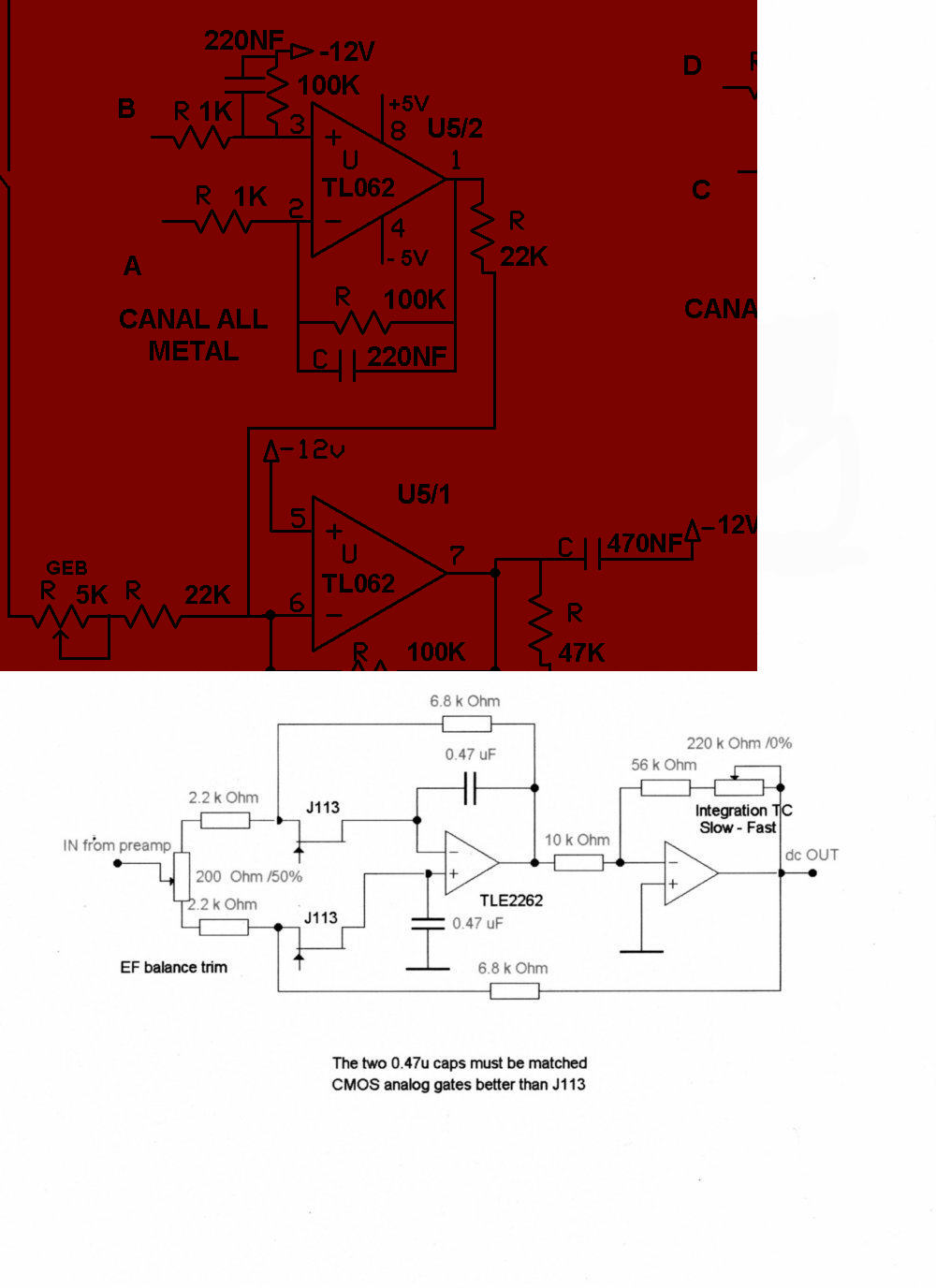

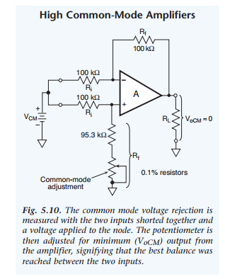

    The other 20% reason you have excessive noise is probably due to low CMMR on your diff integrator ... this can be fixed using the advice as per attached picture ...Click image for larger version

      The other 20% reason you have excessive noise is probably due to low CMMR on your diff integrator ... this can be fixed using the advice as per attached picture ...[ATTACH]36755[/ATTACH]
      Thanks for the suggestions. The circuit boards are copper clad on one side and used as the - rail for the control circuits, common for the analog card. The circuit was built on the un clad side when I didn't have SMD adaptors. With the adaptors I can build on either or both sides. Was thinking the adaptors were acting as standoffs. Maybe not. Been using punched boards because that is what I had and the holes allow connecting circuits from side to side. I use a 1C integrator.

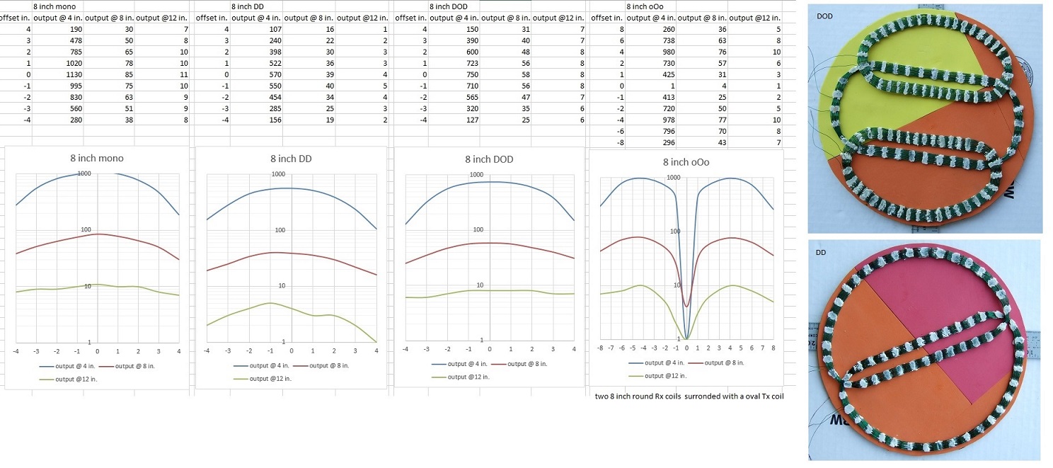

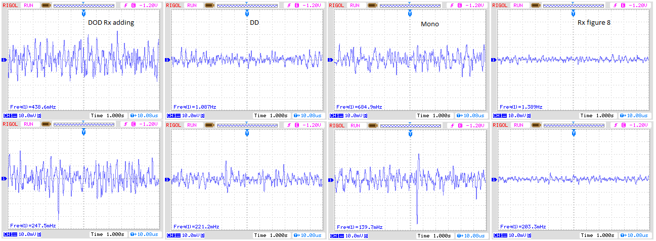

      • The diff amp has less noise than the resistor input inverting input preamp for me. Requires a separate Rx, Tx IB coil. I had made a DOD coil awhile back. Connected it to the detector, the noise looked higher than I remembered the figure 8 Rx oval Tx looking. Ran a noise test comparing four different coils. Each connected to the diff amp, all circuits working except Tx command off. GEB switched off. Recorded 5 scans for each coil. Posting the lowest and highest p-p noise scan for each coil. Including some information I posted awhile back for the coils + the noise data from today. The 8 inch o0o is what I called figure 8 Rx oval Tx when I made the chart.

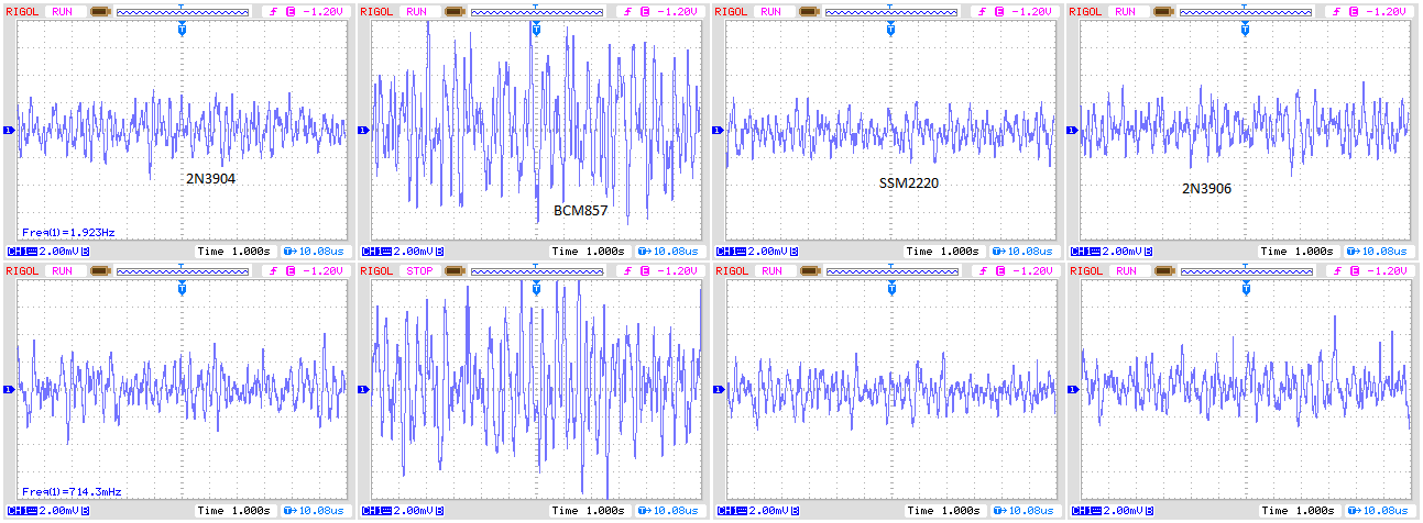

          Using a dual transistor matched pair for the preamp input. Tried four different transistor pairs. I had tried the BCM 857 vs the 2N3906 in LT spice, the 857 was better. Wondering if I might be doing something wrong. Scope pictures of post amplifier out, preamp input shorted, target and EF sample(no ground sample). Recorded 5 scans with each transistor pair. Posting the lowest p-p(top row) and the highest p-p(bottom row) of the 5 scans for each pair. I had tried a different npn pair vs the 2n3904 awhile back that didn't test as good, don't have the data. Haven't tried the new switches yet. The test pendulum_9 reply #51 shows need S/N increase of about 3 times to gain a detection distance of 2 inches. Not much difference with 2N3904, 2N3906 and SSM2220 with the SSM being best.

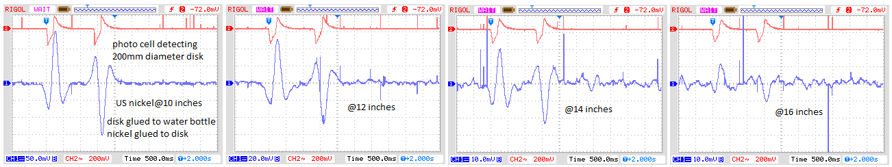

            Some more scope pictures with 2N3906 matched pair. Integrator and post amplifier same as above. Nickel swinging end to end across both coils(Rx two 8 inch round coils figure 8, Tx oval surrounding Rx). Photo cell to show when target crosses coil. Target and EF sample, no ground sample.

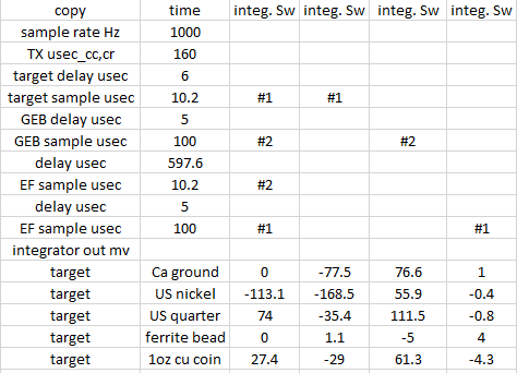

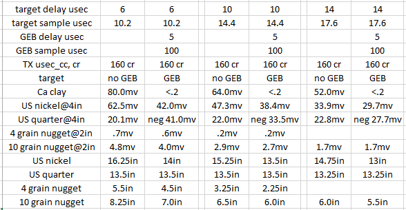

                    Some test data. Recorded integrator out change for different targets(target distance, 2 inches for the nuggets and 4 inches for the coins) with and without GEB. Target sample time was adjusted for no change in integrator out when a quart zip lock bag about 6x6x1.5 inches of California ground was placed flat on one of the figure 8 Rx coils. Post amplifier out was monitored with a scope, targets were lowered on a pendulum until a definite change could be seen in the noise trace. Integrator out mv and detection distance for each target with and without GEB was charted. Preamp feedback TC=.2usec. The nuggets might chart a little different with a different feedback TC. The US nickel looses some distance with GEB. US quarter shows an increase in signal(opposite polarity) with GEB but the noise is higher so the detection distance stayed the same. Not a big difference in detection distance except for the nuggets with the change in target delay time. Another test could be leaving the target sample at 10usec and adjusting GEB sample to balance ground or repeating above test at different GEB delay times. After looking at the test results don't think it would get much if any better. The shorter target delay time is needed for the 4 grain nugget and is a little better for the coin targets.

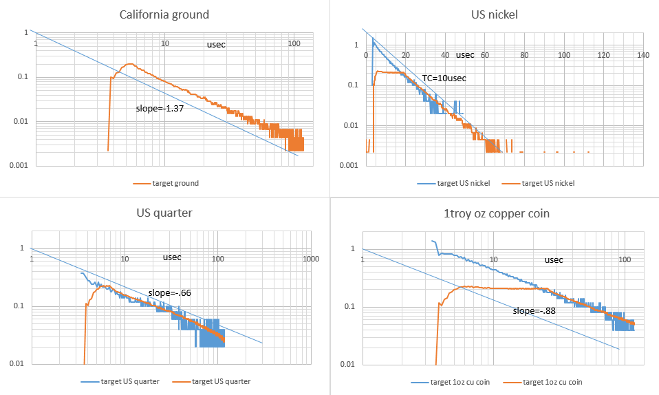

                            • Decay charts for the Ca ground, US nickel, US quarter and the 1 troy oz 99.9% copper coin. Tx=160usec constant rate(6250 amps/sec). The nickel decayed close to a straight line on a lin-log chart. The others close to straight on a log-log chart. Charted target recording-no target recording.

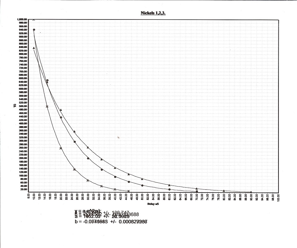

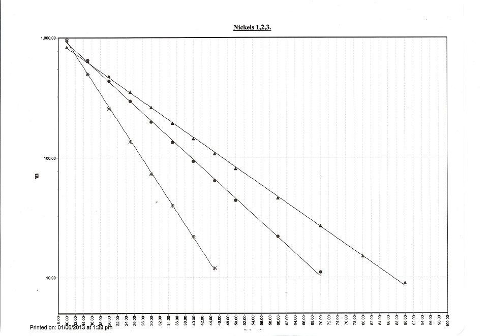

                              • I finally found some of the plots I did in 2013. First is a Nickel test that I did with 1 coin, then a second laid on top, and then a third. This demonstrated an interesting effect that three identical objects sitting on top of one another have a longer decay. This is true even if there is no electrical contact between them. Try it with cling film between coins and the result is the same. Linear time and amplitude followed by linear time/ log amplitude for this one shows a good single exponential fit.

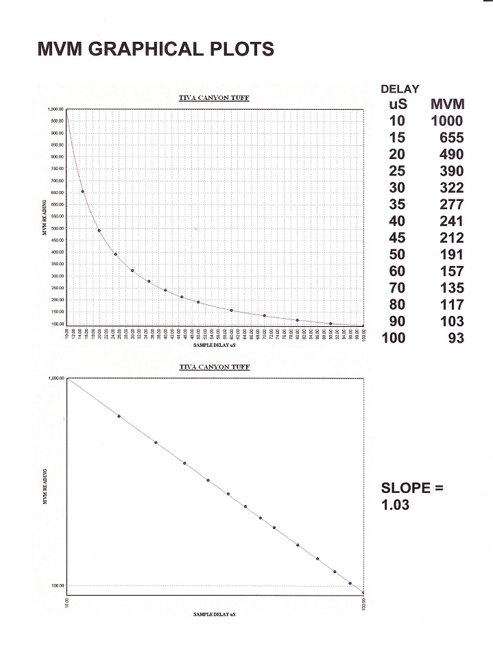

                                Next is a non-conductive volcanic ash, so the signal is purely a viscous magnetic decay. This is plotted on linear time/amplitude and log time/log amplitude scales and has a slope close to the theoretical t^-1.

                                Any other viscous material from fired brick, volcanic basalt, to Australian ironstone, has a similar decay and when plotted will run substantially parallel to the Tiva Canyon material. Soil from Chico in California or Red Hill Virginia, is the same. The only major difference is the amplitude, and somewhere I have a plot of six or more samples from these different sources on the same graph. I will post this shortly.
