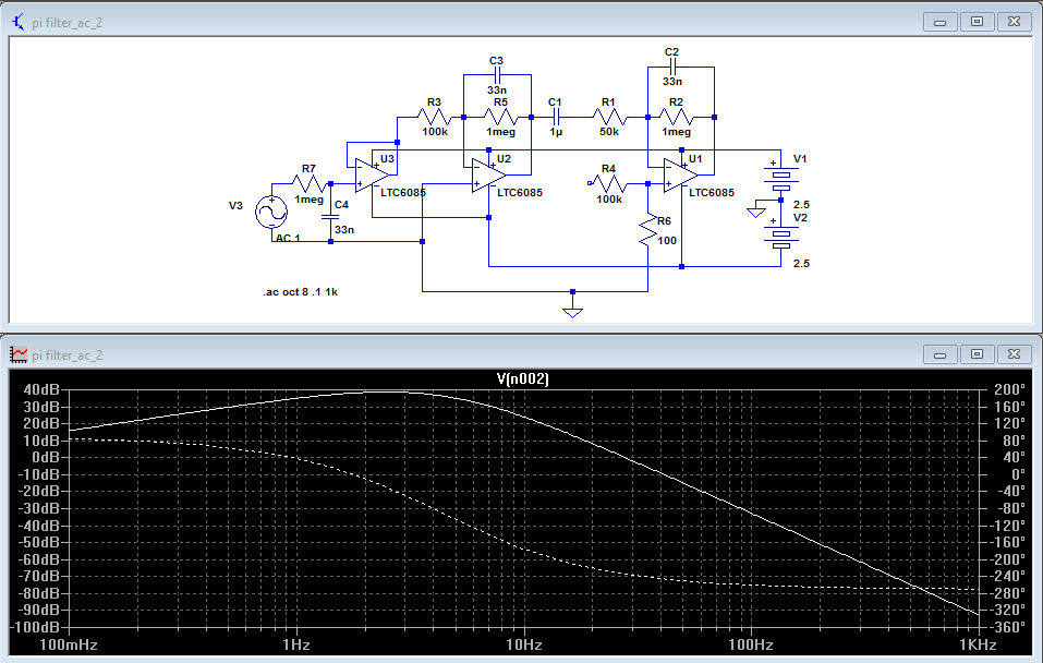

    Lately I've been using an integrator and two post amp stages with a .01usec feed back TC each stage followed by a negative absolute value and a 2.3Hz 5pole butter worth filter. Recorded some scope pictures with the integrator and post amp feedback TC changed to .033usec without the abs. value and 5 pole filter. R7 and C4 are the feedback RC for the integrator, 10k input resistors in series with input switches(1C integrator). A photo cell was mounted 8 inches above the coil, a 200mm diameter disk was glued to the bottom of the water bottle swinging from a pendulum, US nickel stuck to the disk. 200mm/.2second=1meter/second. The nickel swings across one end or from end to end across both. Bottle was pulled back about 18 inches and let go then caught on the rebound, crosses coil twice, I think I like the circuit without the absolute value and 5 pole better.
    • #92
      1C integrtors require a fast op amp, or otherwise they can't cope with charge injection pulses. I'd expect this to be noisy. A minipulse differential integrator is an interesting solution, but it requires a fast op amp, as it combines 1C (inverting) and 2C (non-inverting) paths. Charge injection may be flattened a bit by adding gate resistors (gate stoppers) so that garden variety op amps may work well here. Otherwise, aim for op amps with well over 1 MHz gain bandwidth product.

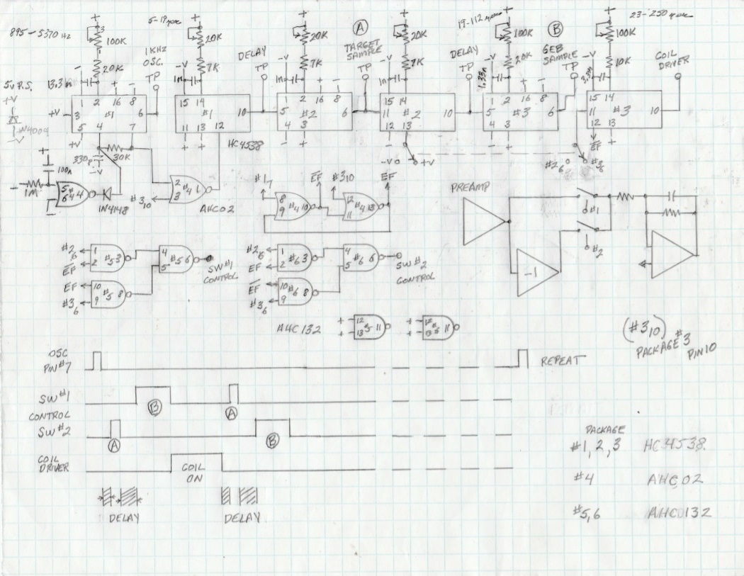

                        Schematic I posted awhile back. There have been some changes but operation is the same. 1kHz oscillator starts sequence, take (A)target and (B)ground EF samples then turn coil on, then take (A)target and (B)ground samples. Switch to disable GEB samples if no ground problem. Target delay and target sample time adjustable, GEB delay and sample time fixed, adjust target sample time to cancel ground signal. GEB delay maybe 1 to 5usec. GEB sample 100usec.

                          • Can you draw a timing diagram that starts with the TX pulse (coil on) and then all sample pulses, delays and widths from that point. Just a typical setup will do. I want to see the relationship of each part of the cycle along to the next TX pulse, particularly how far out your GEB sample is from the 'off' edge of the TX.
                            Eric.
                              Eric.

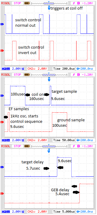

                              Some scope pictures. The 1kHz oscillator starts the control sequence. Takes EF samples before turning coil on. Target sample time was adjusted to cancel some hot ground. Times are what I've been using, not saying they are optimum. 1C integrator
                                Eric.
                                Got a PM from a member reminding me I didn't start the sequence at Tx on. All scope pictures are external triggered when Tx command turns off, T at top center of screen. Tx on starts when second EF(100usec, normal out) sample turns off. Using the upper picture, time between Tx off and first EF sample is around 750usec. Lower picture, GEB sample starts 20.7usec after turn off.
