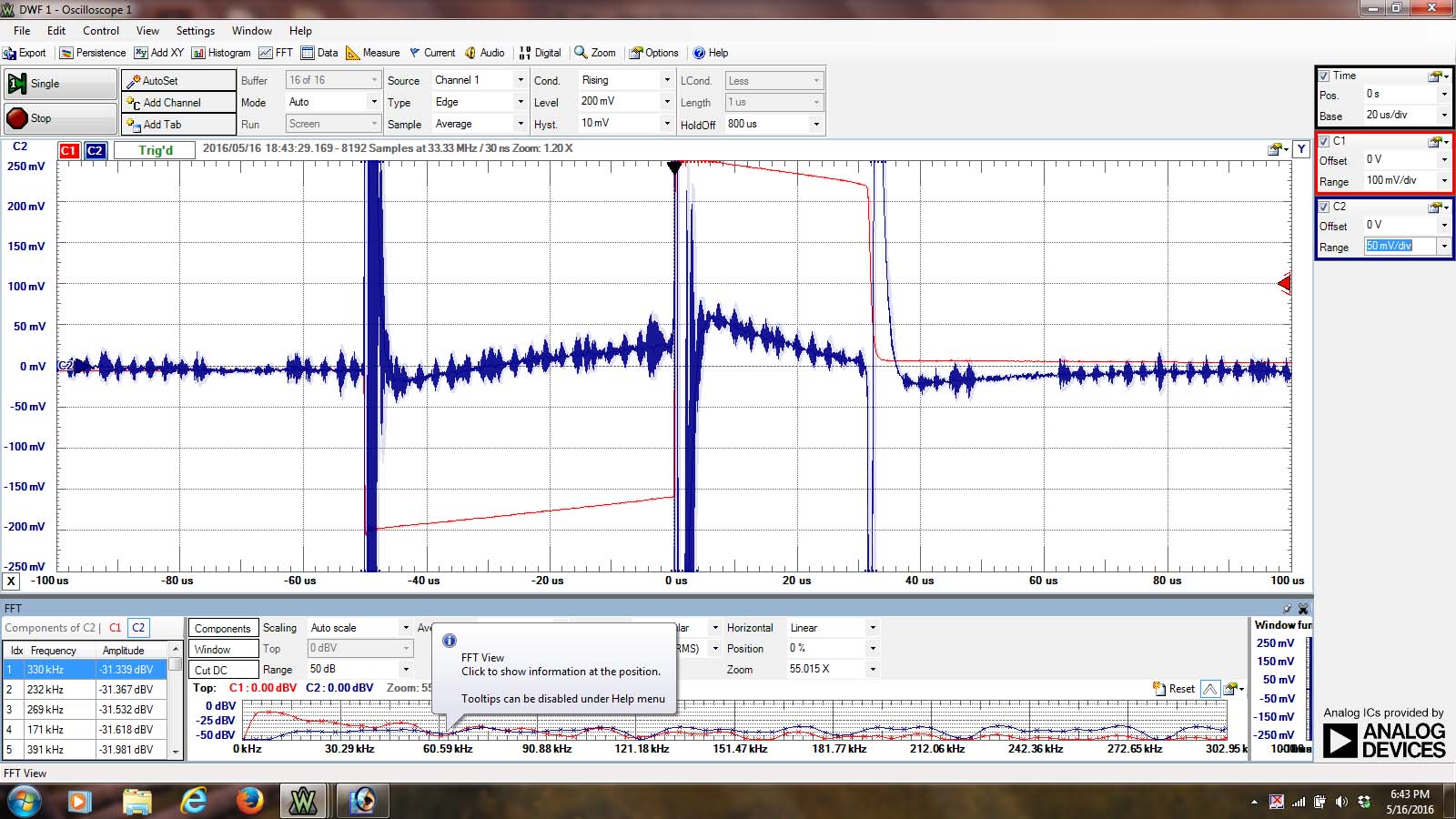

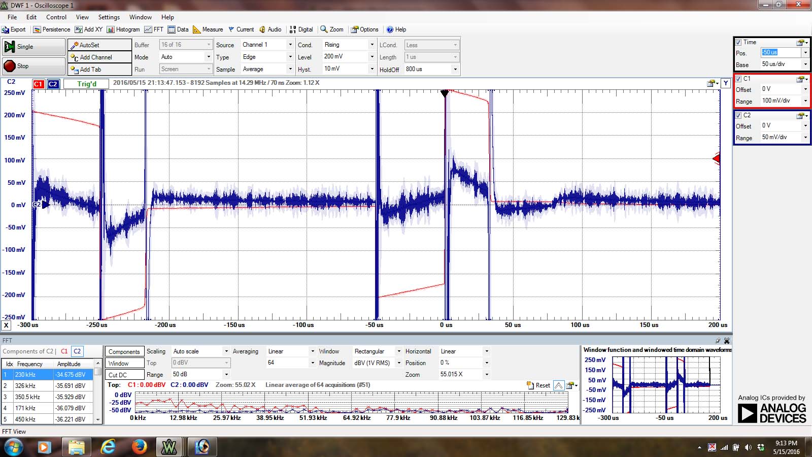

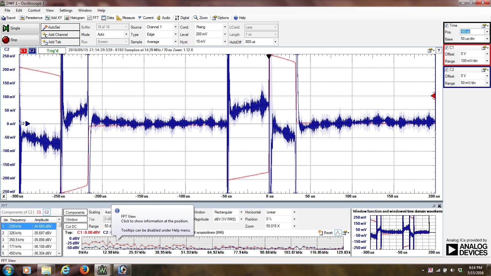

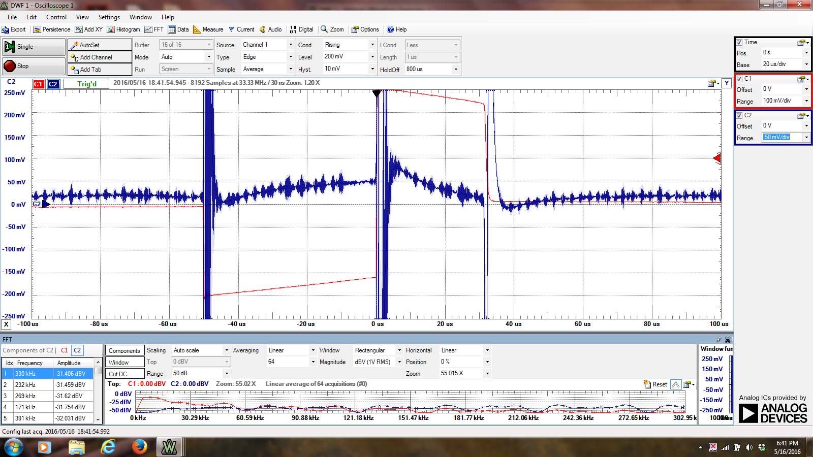

    While balancing the 10" concentric coil and subsequent quick tests to see the coils functioning, I have come to the following conclusion.. balanced IB mode, is where this platform is going to shine. The time while the coils current is collapsing shows the highest signal sensitivity. These signals are gain jumper disconnected ( G=64 ).
Name:	steel response.jpg
    Next step... get my FPGA platform and code the TX and ADC sample timings. Based on my simple visual observations, I feel confident that the 18 bit ADC and FPGA controlling 9 samples and 3 different 8 channel digital filters will yield superb sensitivity. Initially, I am going to allocate 4 sample channels to the falling coil current timeframe, and 4 sample channels to the traditional PI sample period (immediately after coil current ceases), and one sample for environmental cancellation taken 5 usec before the TX perioid.

      I applaud you for your outstanding project and results. You have provided great documentation and oscilloscope shots.
      I have a couple of questions. Will you use the falling current samples for discrimination? What amplitudes are the signal spikes/excursions that go off screen?
      Thank you for sharing this project with us.
      Have a great day,
      Chet
        Not sure yet... Discrimination per se... probably not. But general target charactaristics are definitely a possibility.
        If you are talking about the vertical spikes on the blue trace, they are the leading/trailing edget of the coil voltage wave form. These edge can never be completely canceled out because of slight distortions to the rising/falling edges as seen in the three coil windings. Also, however slight, there is a minute time difference for the magnetic field of the main TX coil to reach the bucking coil for cancellation. The amplitude of the spikes is about 400 mv peak.
