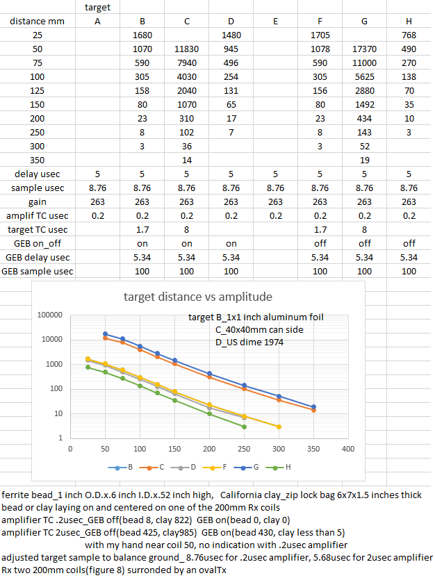

    Haven't been able to reduce the noise yet. Tried to chart amplitude vs distance for some targets with the .2 and 2usec amplifier. The 2usec amplifier looked better with the swinging target. Wasn't as stable looking at integrator out with a voltmeter and had other problems. One being a change in output when I placed my hand near coil which I didn't see with the .2usec amplifier. B and F, C and G, D and H are the same targets.

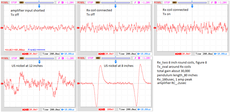

      Good thought, I'll include a photocell on my next order. Been trying to increase signal to noise. Using a difference amplifier with separate Rx and Tx is working best for me. Including some scope shots. I read detecting a US nickel at distances far greater than 12 inches. I could try a larger coil and or higher peak current to increase the signal. Does someone have some scope pictures to compare or tell me how low I should be able to reduce the noise?
      • #78
        Green, great job! Are you using the bandwidth limiter on the Rigol when you take these shots? Looking at your signals it looks like the actual target signal closely resembles the amplifier noise so simple filtering is not going to help you much. One thing that may be causing the noise is the supply lines. What are you using for a power supply? Highly regulated and filtered supplies are important for the first stage or two. See here for some recent suggestions:

        It looks like the noise you are seeing is centered in the band at about 9-15Hz. What op amp are you using? Look for op amps that have low 1/f noise at the impedance you have with your coil and feedback resistances. Note that if your scope can do FFT's this can be very useful technique to see just what the frequencies of the noise are.

        In an actual detector, as opposed to a test fixture, it may be possible to use long integration times to minimize this noise. Alternately it may be possible to use a micro to analyze the static noise and eliminate it using DSP.

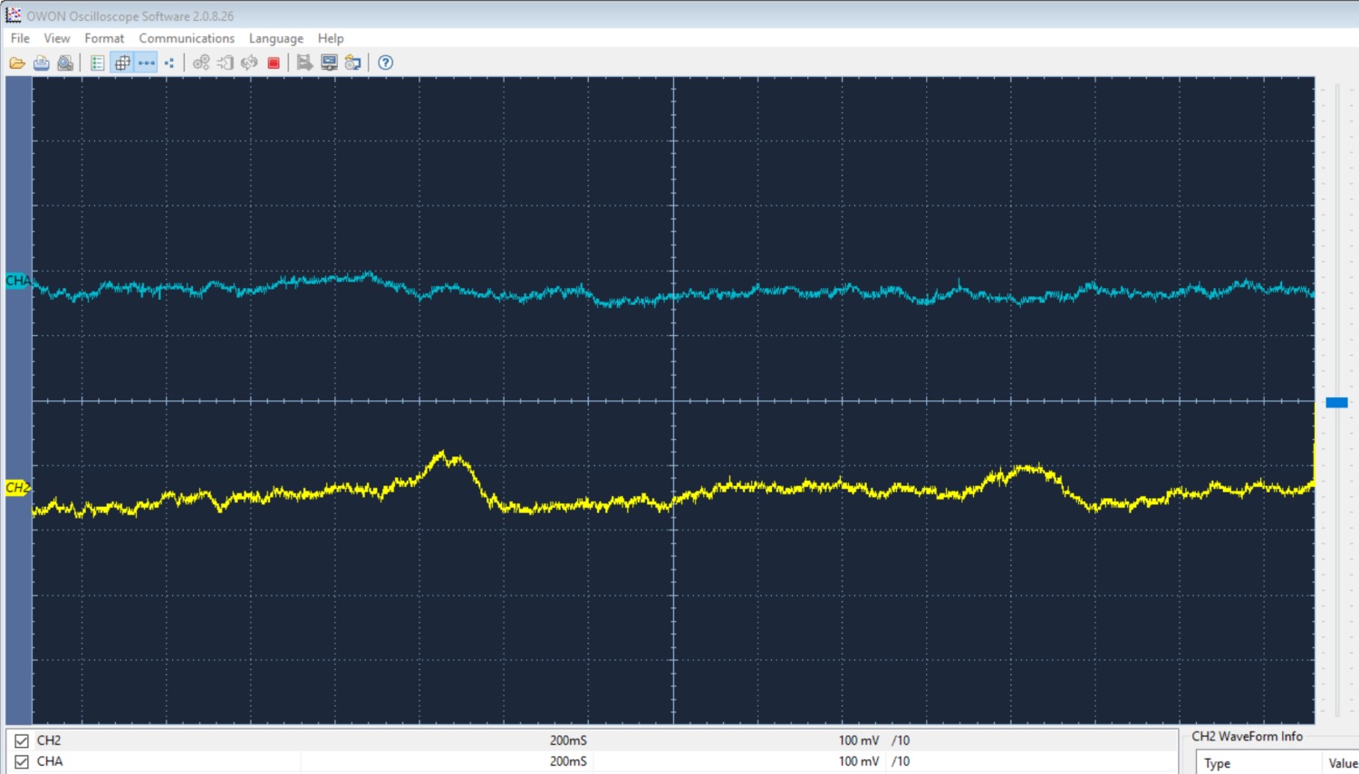

          You are doing great.
          Attached a scope shot of my signal of a Nickel at 8 Inches.
          Blue trace, no target.
          Yellow trace, Nickel on the pendulum, swinging at 8 Inches above the coil.
          The coil is 24cm diameter, 1944uH, 60 turnTX
          RX is 426uH, 19cm diameter
          Gain, Preamp=68, sample window, 5us, integrator opamp gain 100, band-pass 2Hz to 15Hz, level shifter gain 45.
          Total gain will depend on how you calculate the integrator gain. PPS is 2500.

                    There are 3 main noise frequencies.
                    1) 50Hz mains noise, normal, considering the virgin forest of air wires on the bread-board. It will disappear once the circuit is on PCB.
                    2) Noise at 0.5Hz, do not know where that comes from.
                    3) Noise at about 2Hz. No idea where from.
                    Reading your links now, hoping to get enlightened.

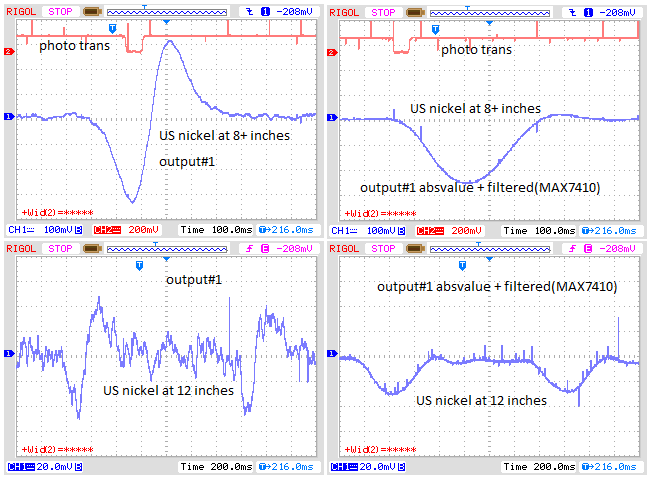

                      Found a photo transistor. Glued a 3 inch diameter cardboard disk painted black to the bottom of the water bottle. Added a absolute value circuit + a MAX7410 to filter the absolute value output. Looks like it might do some good, maybe more filtering than needed. Peak amplitude delayed about 1/2 second. Some high frequency glitches that came be eliminated. Still working on the OPA1612 instrument amp.

                        Finished and tested the OPA1612 instrument amp. Noise about the same as the dual 2N3904 input. Seems like it should be better, maybe some thing I'm doing or something else is causing the noise. The peak amplitude is delayed by about .25 seconds not .5 second with the max7410 output, must have been looking at lower scope trace for time/div.(reply #85). If I make the disk 100mm in diameter, peak velocity(mm/second) would be 100mm/photo cell pulse time(100mm/.1second=1000mm/second), good indicator of velocity for comparing output amplitude at different sweep speeds. Photo cell mounted on top of a 8 inch spacer. Thanks (Old cart) for the photo cell suggestion.

                          What cutoff frequencies are you using on the MAX7410? The 250mS delay you are experiencing is probably just due to the group delay of a very low frequency Low Pass filter or it may be due to the witched cap filter or a combination of both. If I am interpreting your graphs correctly the cap coupled trace has the photo transistor peak very near the negative going target peak. At 12" though the signal to noise is much better that the unfiltered signal.
                          Maybe you could design the circuit so that when doing searching the SC filter is in the loop. Once the target is found a pushbutton would take it out of the siganl path allowing more precision in pinpointing.
                          With the MAX7410 in the loop you might benefit from a 1st order passive low pass after the SC filter to get rid of the SC or maybe AC line noise. it is hard to tell at the sweep speeds these were taken at.

                                Calculates 2.25 Hz(.1 and .033 in parallel). The thought has been to use the capacitor coupled output to find the target and look at the last direct coupled stage with a voltmeter to pin point. Offset shouldn't matter non motion, just looking for peak change.
