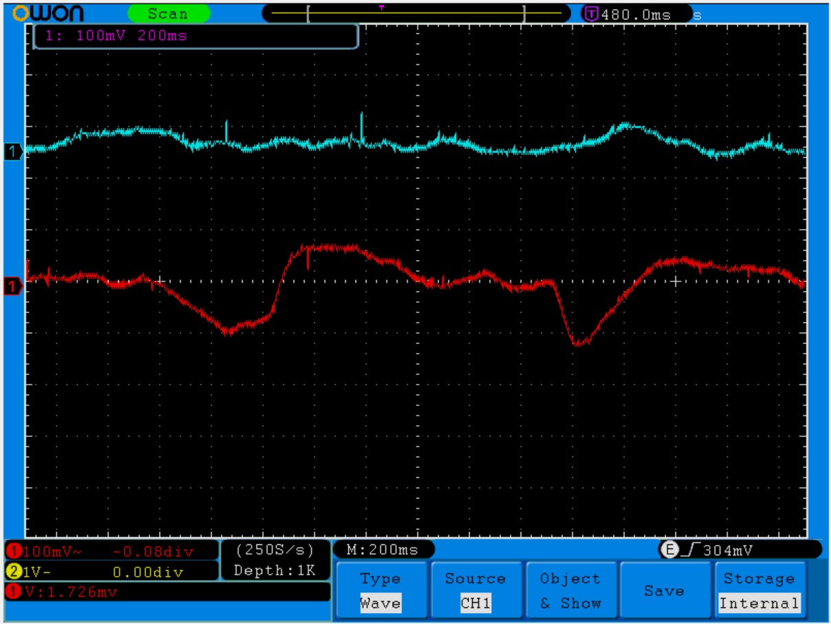

          Target is best at the center of the bottle bottom, because the bottle sometimes gets a light spin.
          The red trace shows the 5x5mm can-side target swinging 20mm above the coil, distance measured between the rim of the TX coil bundle and the target. I stuck the target on a piece of transparent PET foil to make it easier to handle.
          The blue trace is with the bottle fixed above the center of the coil, showing the noise at the same scope setting, 100mV/200ms/div.

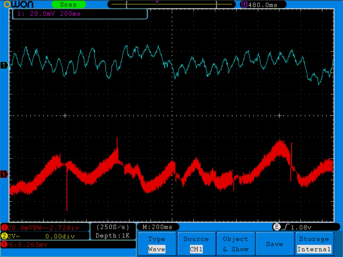

            The red trace shows the system noise at 20mV setting, probe x 10, with TX ON, RX coil disconnected and input grounded with a 39 Ohm resistor.
            The blue trace shows the system noise with TX OFF. Several noise frequencies are distinguishable.
            The job, now, is to find the origin of each of the noises and find a way to eliminate them.

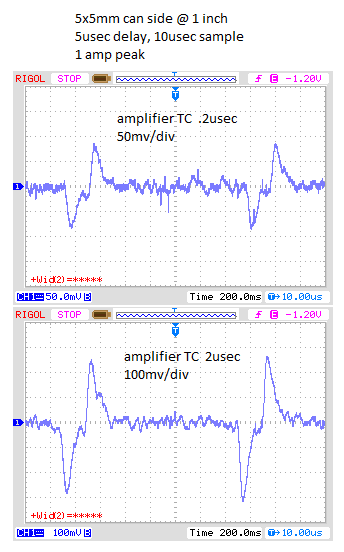

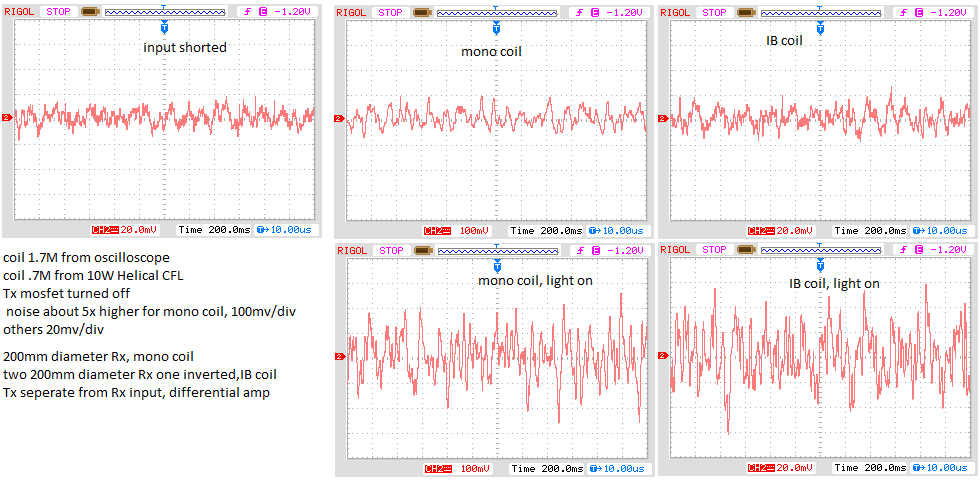

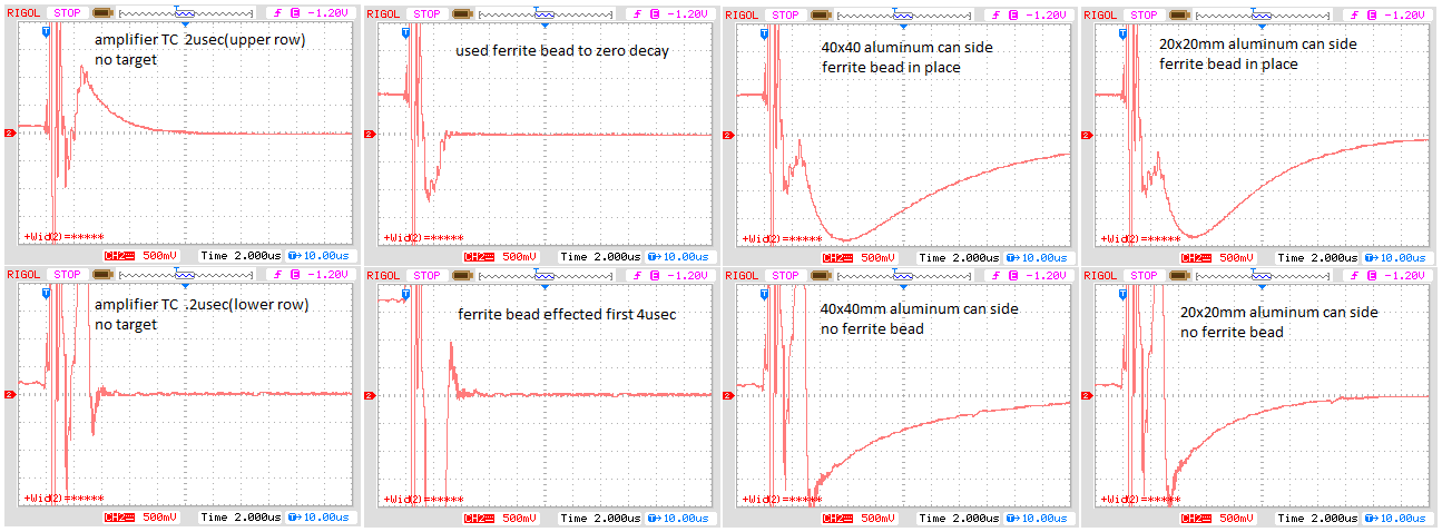

                      A couple experiments. The pendulum setup works good. Repeatable target height and sweep speed. Used a 1 inch spacer to set target height. Pendulum_2 noise compares a mono coil with a figure 8 coil(Tx turned off) amplifier TC .2usec. Pendulum_3 compares amplifier feedback RC time constant at .2usec and 2usec. IB coil.
                      • #71

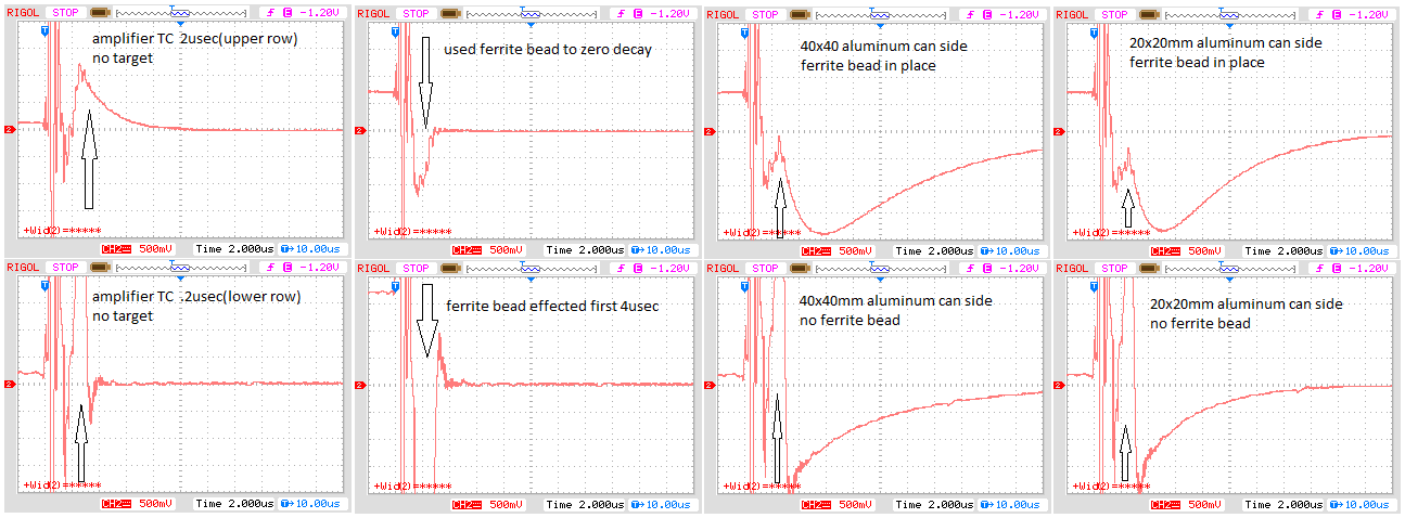

                        More .2 and 2usec amplifier TC tests. The coil decay information gets shifted into the target sample with the 2usec TC amplifier. Would be a big problem if trying to chart target TC's. Think it might be a problem with ground balance but don't know. Other problems or no problems? Scope pictures of amplifier out, IB coil.

                          Hi Green
                          Thank you for more interesting charts. Is chart Penduim-3 capacitive coupled? Penduim-3 shows a great improvement on a very small 5x5mm target by using a 2usec amplifier time constant. Do you think that the amplifier feedback time constant needs to be adjusted for different size targets and different sweep speeds? Are the waveform overshoots / distortions in Penduim-4 caused by capacitive coupling? Or maybe a small change in the damping resistor might smooth them out? Where is the ferrite bead installed?
                          Have a good day,
                          Chet
                          • #73
                            Hi Green
                            Have a good day,
                            Chet
                            Hi Chet,

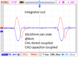

                            Pendulum_1 shows integrator out direct coupled with the last stage gain about x10 capacitor coupled. The trace in pendulum 3 is the capacitor coupled output. The direct coupled signal would go + only(opposite end of figure 8 coil as pendulum_1). I'm taking a 10usec sample after a 5usec delay so the 2usec amplifier filters and moves more of the signal into the sample period. I think taking a 1usec sample after the 5usec delay would be better with the .2usec amplifier. The 2usec amplifier moves what happens during the coil decay into the sample window which seems like might be a problem, maybe not. Pendulum_4 is the output of the amplifier, direct coupled, no capacitors. The upper traces, 2usec amplifier a ferrite bead was positioned on the coil to zero out the offset at 4usec and left there for the can target traces. The ferrite bead is detected during the 10usec sample with the 2usec amplifier but not the .2usec amplifier(can see the ferrite bead change in the first 4usec). I think my first problem is minimizing noise and then seeing if moving the signal during the coil decay into the target sample window is a problem.

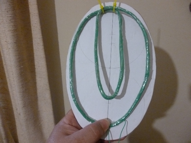

                              Its called a folded eight.
                              its just an 11 inch bunch wound coil folded back on its self, can be an ellipse or round they are supposed to be noise rejecting, and still sensitive to small gold, see attached picture
                              the inside loop can be adjusted for various lengths and sizes etc. It was invented by Reg.
                              If its not something you want to experiment with thats all ok.
                                One other addition that might be very useful would be to add a photocell pointing toward the ceiling. If this is hooked to the second channel of the scope it could sense when the target blocks the light as it would when the target is directly over the coil, this would allow you see coil response delay relative to target position.
