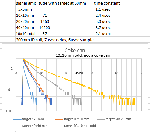

      A chart of some targets I posted awhile back. Didn't get the same on two 10x10mm targets cut from the side of the can. Maybe because I didn't cut them exactly the same, maybe one cut closer to the end than the other, one was a coke can the other something different. When we decide on size I could try to find out why. I like the 5x5, 10x10, 20x20 and 40x40mm targets. Gives some different TC's. The larger sizes are easier to cut to size. Target distance can make up for the smaller size. Do we need a way to determine EMI pickup vs circuit noise? Looking at your test in reply#41. I assumed 200msec/div and the bottle crossed the coil twice. Calculated pendulum length. Got about 43cm different than what you had. What am I doing wrong?

        Let's settle on the 5,10,20,40mm sizes for alu can.

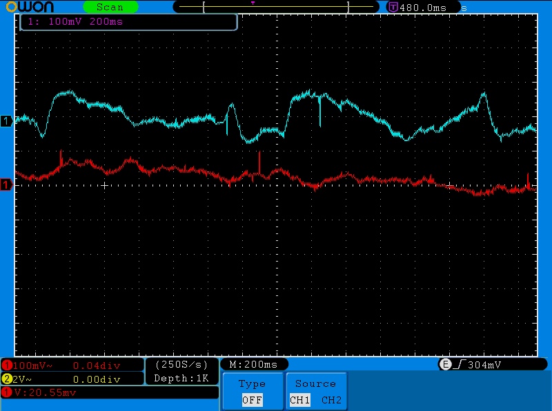

          I calculate 2.92 seconds for the pendulum period. Can you explain where sec/div is on your scope picture and what the numbers in the lower left screen mean. Thanks The test is showing signal to noise. Everyone is going to have different EMI, I think it would be nice to show noise level with and without EMI. Maybe a resistor across the amplifier input instead of the coil for circuit noise?
                Thanks for the feedback.
                The numbers on the left: The positions of the cursor lines and channel 2 are of no significance on the picture. The red trace is the static signal, at 100mV/div, the blue line is the same red trace signal, saved, when the target is swinging above the coil.
                Time is 200ms/div, (M:200ms) acquire setting on sample, no averaging.

                            The blue trace is the 5x5mm alu can target swinging over a 25cm coil. Distance to coil TX wire, about 8mm. To the coil RX wire about 11mm. The target is only visible when passing the coil wires.
                            The red trace is the no target signal. Very noisy.
                            Next thing is to clean up some noise.
