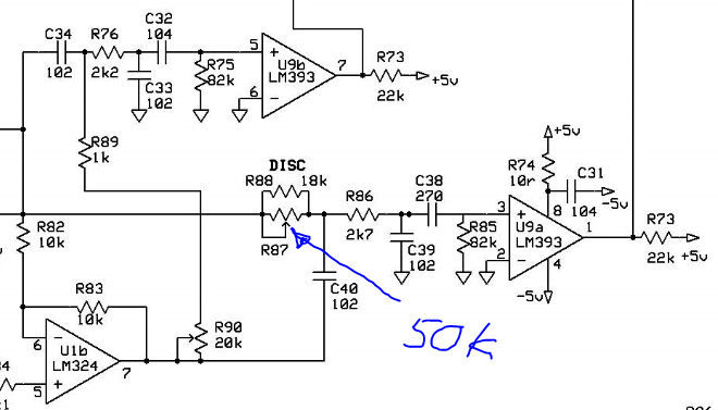

          • Good evening! There was a problem with the device. Discrimination does not work. If you turn the handle by 20 percent, copper is cut out. This occurs only at a high frequency (18 kHz)

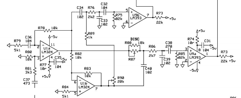

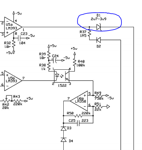

                • Originally posted by Jakson30 View Post
                  Check the zener diode for 4053 and 358 microchips.
                  Which capacitor is on the diskrim?
                  • Originally posted by vlambers View Post
                    All according to this scheme
                    Please show in the diagram what I need to check
                    Thank you so much
                    P.S.
                    This diode?
                          This diode?
                          Yes, it is this diode and from it to 4053 and beyond to 358.
                          The discriminator should be set to B50K.
                          Condenser C38 - what's it worth?
                            Capacitor 270 p
                            I have soldered 50k
                            • Do you have a device for 1 or 2 frequencies?
                              You can try changing the value of the capacitor, the scale will change, you can set it at 470p - see what happens.
                              • I devices operate on 3 frequency: 8 (5) -12 (10) -18kGts.
