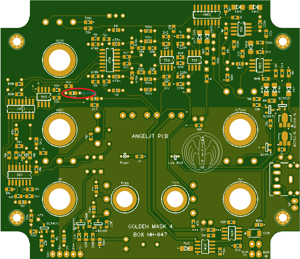

    • Good day. Would it be interesting to place gerber files or links for self-ordering boards?
      • gerber_mask (1).rar
        • I'm talking about my board )
          • I will not argue, just lay out for those who wish - the board is fully working, collected by all and all ....
            link to google drive https://drive.google.com/drive/folde...lNsa3dMVU9BLU0
            and link to psbway https://www.pcbway.com/project/share..._Detector.html
            Please who should take it)

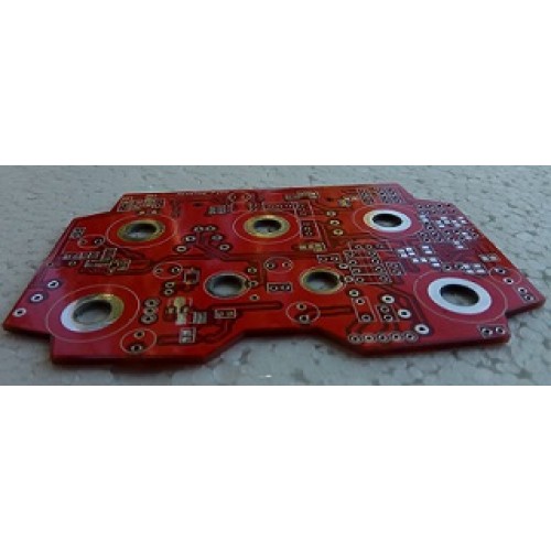

              • Greetings to all . I made this detector, but I have a small question .The board is SMD, not redu - full variant 2 4053 . Discrimination is normal, distance is about 30-32 cm 1 euro coin .The coill is 26 cm with suitable inductance.
                But there is something like a skin effect , when touches the cable or housing MD this gives false signals . Not yet tested in the field.
                Is this normal in the building ?
                • Hi
                  It is the capacitive effect of your hands! Make a proper electrical shielding or grounding connection for cable and for the pcb plastic housing, search forum for detailes!
                  good luck

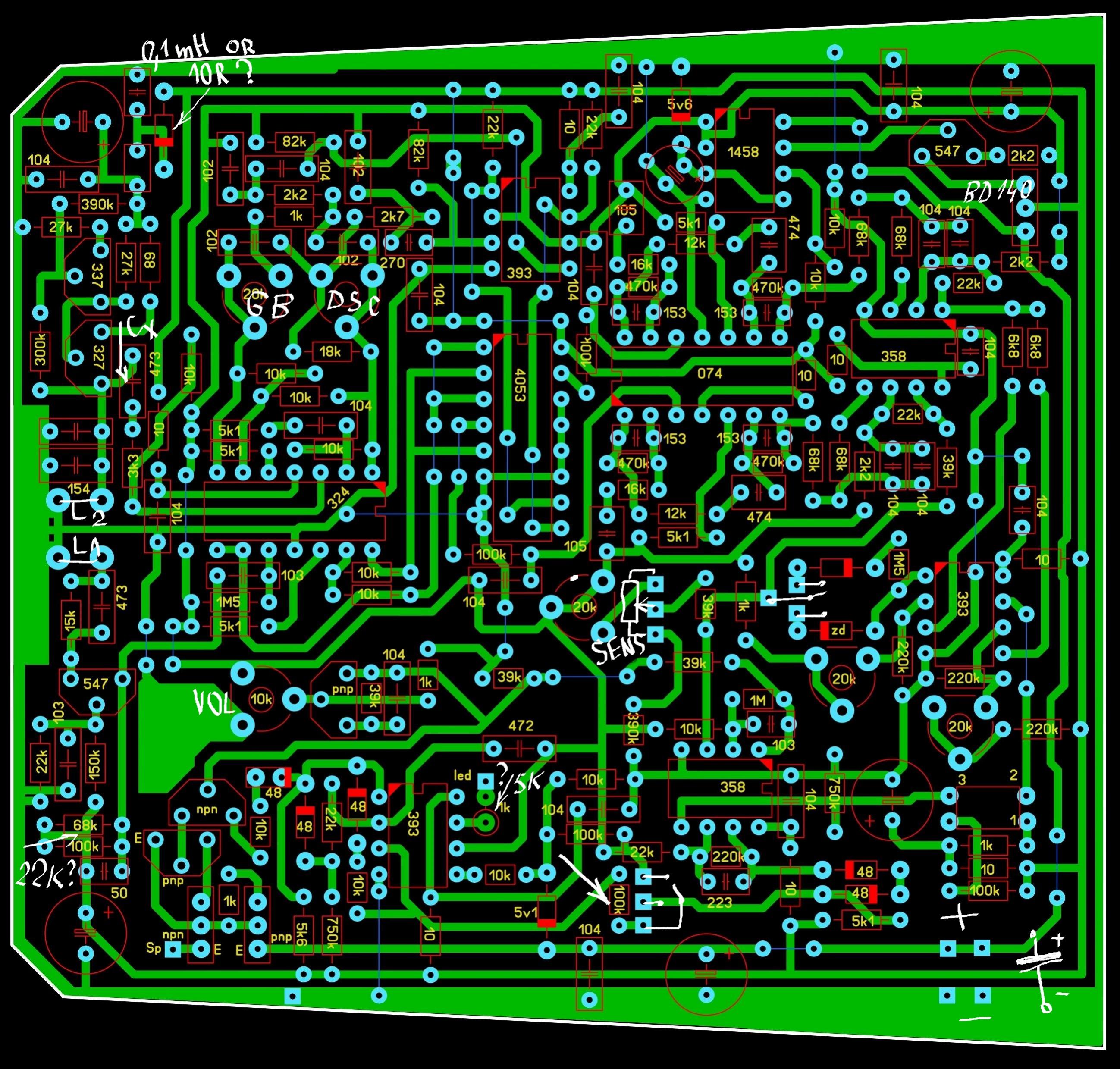

                  • What are the power requirements and battery hookup connections. I built Ivconics through hole design. It seems to be missing connections.
                    • OK , I marked some things. D11 SS14 and R101 2.7k missing , R101 think it's necessary
                      • Originally posted by timekiller View Post
                        Yes thats the version I built, missing 2.7k from pin 5 of 1458, C48 and C49- are they necessary? What is the applied voltage at + and -
                        12V?
                        • this is the PCB last revision I can find
                            Does this circuit have a voltage doubler that allows it to run on a 5V battery?
                            • No . highly recommended for stable operation 12v .
                              • Timekiller, thanks for your help. One more question, is the SS14 diode the unmarked diode at the top left corner of the through hole board design?
