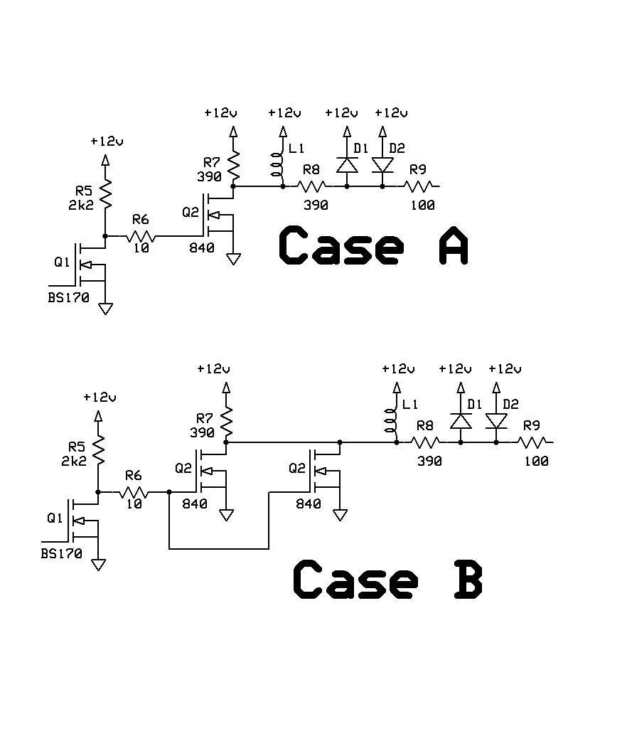

      Usually i avoid to interfere in debates where i feel inferior comparing to knowledge present at other participants, but this time i can't resist; i must ask for an opinion!
      I am offering you here a piece of schematic.
      You have "Case A" and "Case B" on it.

      "Case B" looks as rather weird solution, but it totally outperforms "Case A", in course of sensitivity, target response and stability.
      This is checked and proven in practice.
      My question is: how come?
      Opinions?

        Two MOSFETs in parallel = half the on-resistance of a single MOSFET.
        For the same on-time, half the resistance means twice the coil current.

          I would like to know the inductance and resistance of the coil plus the width of the drive pulse.
          Take Rds of the IRF840 as 0.85 ohms.

            It wouldn't result in twice the coil current, it would in fact make no significant difference if it uses a coil with high resistance. The only benefit would be if trying to keep the total coil and switching circuit resistance low, but the circuit would need altering to do this.
            As Eric said we need to know the coil and cable resistance, the inductance, pulse width and it would help to know if the 840s avalanche.

              It was tested with 0.35mH/1.5R (including cable, coill itself is somewhat 1.1R), pulse width 160uS, pps 250.

                If the coil resistence is dominant then the MOSFET would have little influence. But sinc ivoconic said there IS a difference, I deduced his coil is low Ohm. Tx coils for PI have low resistance of less that 1 Ohm. This is my case.
                  With those values your coil current is 3.6 A with one MOSFET and 4A with two in parallel.

                    That's not as low as some but it's still a relatively low resistance coil circuit compared to what we often see here.
                    Assuming 10v then I get around 2.83A peak coil current with one IRF840 and 3.05A peak current with two 840s in parallel but it becomes harder to turn the FETs on as the resistance drops so it's wise to use a push pull circuit to drive the FET otherwise it spends the early part of the pulse acting as a resistor and this can influence the result.
                    Looking at the GS5 circuit posted on the forum with a 436uh coil, same pulse length, 3.5 ohm R with a 2.2 ohm series resistor and 0.55R for an IRF740 I get 1.73A, and 1.78A if I add another 740 in parallel.
                    Most of the projects here use high resistance coil switching circuits, mainly because they are taught this gives the best result when at least one manufacturer has proven it doesn't.

                      Working it out very quickly on the parameters you gave -
                      One IRF840 gives 3.3A at the end of 160uS pulse
                      Two IRF840 // gives 3.7A at end of 160uS pulse
                      My conclusion is that it is not enough of a difference to make the significant improvement you suggest. There must be another factor.

                        I used 12V as the TX supply which would explain why my current is higher than Crane's. See Ivconic's schematic.

                          Taking into account the resistance of the power source, say 1 Ohm, the difference is 3A vs 2.8 A.
                          That's a 7% increase in current and a 14% increase in power (W = 1/2 L * I^2).

                            It could be another factor that is influenced by the increased coil current. For example, the main sample delay used with Q1 alone may be sub-optimal, but with Q2 the circuit reaches an optimised condition. Or maybe the damping resistor needs to be adjusted.
                            Without seeing the full circuit and more details of the detector settings, we're all just firing arrows into the air.

                              I didn't see the voltage so 12v gives much the same as your figures, 3.39A and 3.66A. As you say, not enough to make a significant improvement.
                              Good if that was all there was to it though.

                                A simple solution to increase the current is to widen the TX pulse to 195uS. This would give 3.7A with the single IRF840, which is the same as the parallel setup at 160uS.
                                Where do you get the 1 ohm in the power source?
