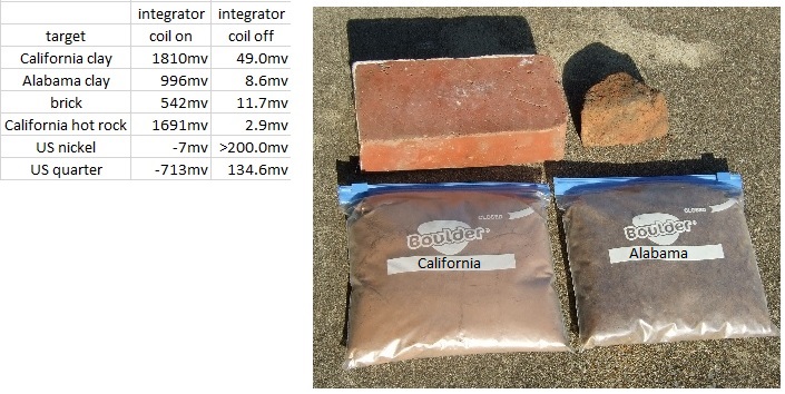

                        Looked at amplifier out on a scope this morning with different targets including some LF ferrite bead cores which should only show a signal when Tx current is changing. Bigfoot style coil(Rx two 8 inch round) Tx(oval coil surrounding Rx). Looks like 10 TC's(L/R) might be a good number for a critical damped coil. 300uH/300R=1usec*10(10usec delay), 378uH/1000R=.378usec*10(3.78usec delay). Does 10 TC's sound way off? Calculated Rd for a 300uH coil with 100, 200 300p capacitance. 10 TC's would reduce the delay by about 1usec stated by bbsailor in reply #37.

                          • #43
                            Hi Carl
                            I keep reading I should be able to sample down to 0usec. I'm using a Bigfoot style coil, two 8 inch round coils Rx(647uH, 1.05MHz SRF). Oval Tx surrounding Rx(378uH, 895kHz SRF)SRF measured with coil leads connected to coil. Differential input preamp(gain about 375). Tx, 160usec, constant rate, 6250 amps/sec, 1 amp peak. The coil is very close to balance without trimming with a ferrite bead core. Including some scope pictures, coil volts and preamp out volts. Top, ferrite near one end to unbalance coil when charging. Middle, ferrite near center to balance preamp out when coil is on. Bottom, Ferrite opposite end. I can zero preamp out when coil is on and change the waveform when Tx is turned off but I can't get rid of the saturated signal. Any suggestions what or where my problem is? Coil, preamp or something else.
                            I have an integrator that samples amplifier out during the last 137usec of the 160usec Tx. Was thinking using it to identify ferrous non ferrous but the ground signal is a major problem. Looking at it again to try and learn something. Charted some data. Coil off integrator(6usec delay, 10.2usec sample). The hot rock has the lowest coil off signal with almost the highest coil on signal. Is target shape causing some of the differences or is it mostly material? I thought it interesting to see the results of the different targets. It would be more interesting to know what causes the differences, comments appreciated. Targets were centered on one of the figure8 coils with a 15mm spacer between target and coil. The coins were added for reference signals. Charted integrator out(no target mv-target mv).

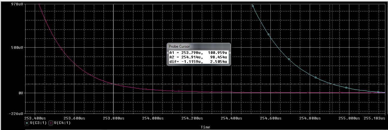

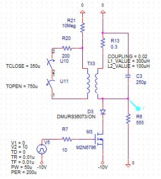

                                As promised, I have performed some PSpice simulations with the aim to improve the behavior of PI Tx and Rx. First, I'll speak about Tx.
                                Below is the classic schematics with a critical damping resistor

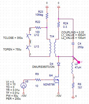

                                And now the same one with a 47uH inductance inserted serially with the damping resistor which has been optimized to get the shortest decay:

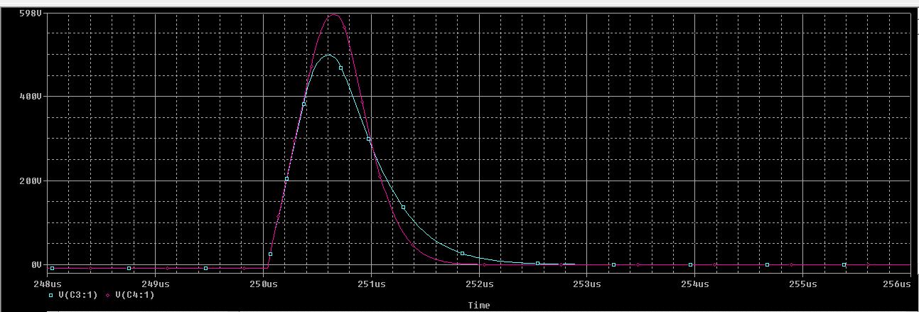

                                Let's have a look to the Tx waveform after Tx off command on the Mosfet gate :
Name:	R+L Full Wave.JPG
                                You can see that with the inductance the voltage peak is higher and the decay time lower. I look now what is the delay to reach very low voltage levels (100 uV) :
Name:	R+L detail @100uV.JPG
                                We have 4.9 us without inductance and 3.8 us with so a 1.1 us gain !
                                I will continue in the next post.
