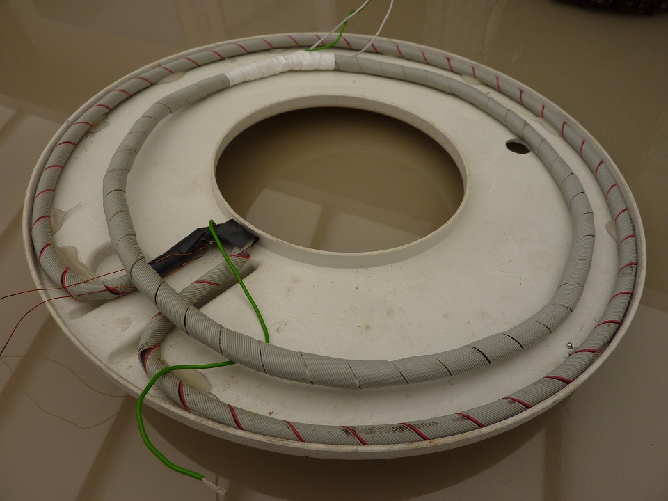

                Here is another way of shielding a coil by using a fine pitch ribbon cable. At one end, all the conductors are joined together and brought out to a ground wire. The other end is all open (comb configuration). In both the coils shown, the ribbon cable is wound on top of a polythene helical wire wrap to space it off the coil. To make a neat job you have to experiment with the number of conductors to peel off, depending on the coil diameter. The one with a red conductor is the better of the two. It was an 11in winding which I have squeezed into a 10in shell. Hence the ingrowing loop.

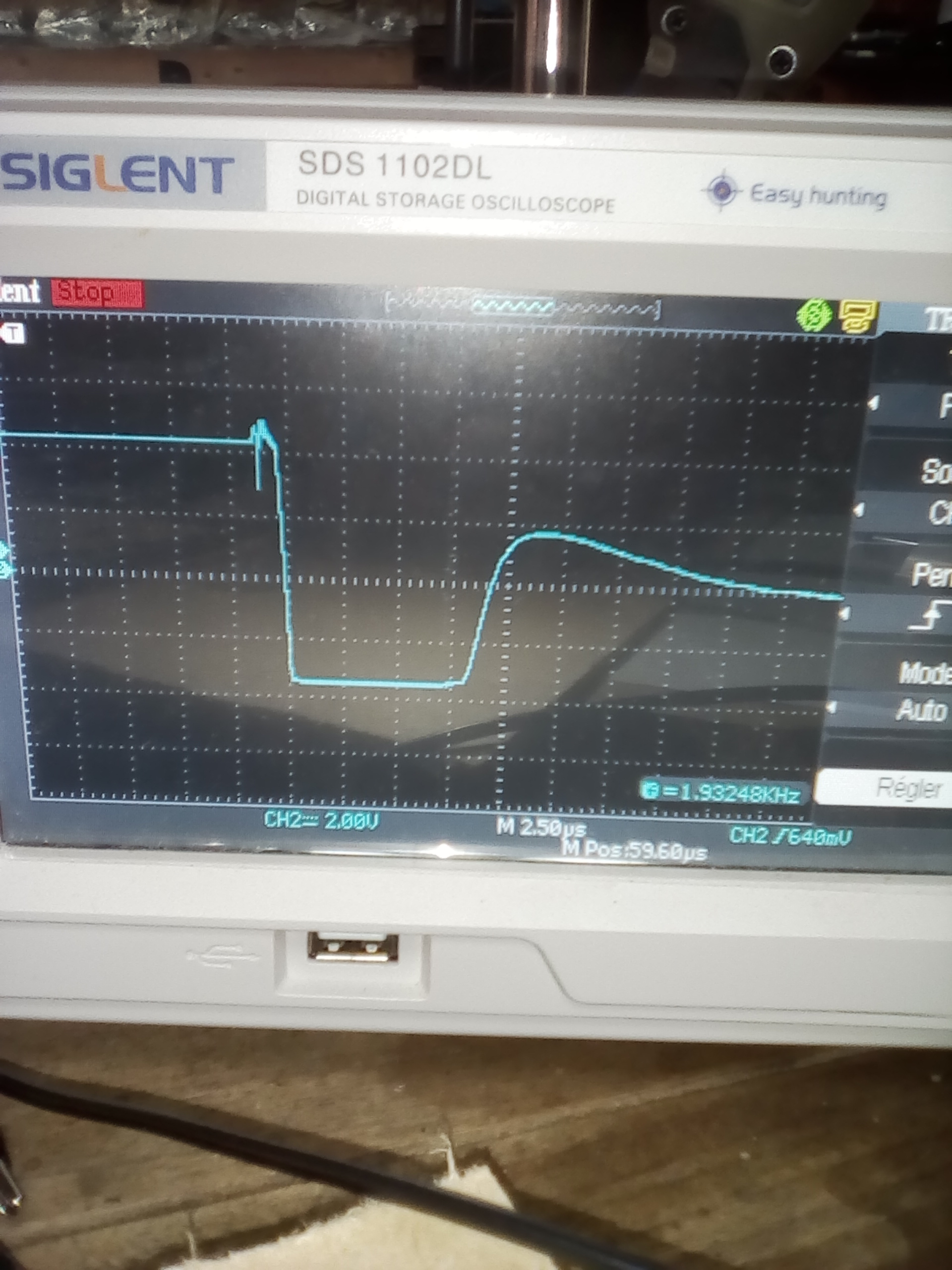

                              New coil ! Circular, insulated and shielded !Click image for larger version
ID:	346789Click image for larger version
                                Originally posted by antalaz View Post
                                New coil ! Circular, insulated and shielded ![ATTACH]37472[/ATTACH][ATTACH]37472[/ATTACH]
                                There may be something amiss with the grounding of your preamp as you have a positive tail at the end of the recovery. This can happen if some of the recharge current to the TX reservoir capacitor flows in a part of the RX ground. A good way to avoid this is the ground the RX directly to the ground side of the TX capacitor.
                                Another cause of this type of overshoot is excessive capacitance in the coil and cable. Try as short a length of cable as possible and see if it improves. You could also increase the value of your damping resistor and see if the overshoot develops into a ringing waveform. If so, it is a coil capacitance problem. Sometimes you can get a faster response by allowing a cycle of positive and negative ringing, as long as the start of the sample pulse is just clear of this.
