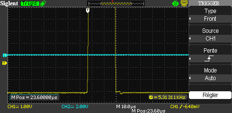

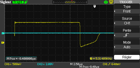

      Here is the results... i dont understand why my coil is slowed down... any ideas ?
      One pictures is with minimum damping resistor and the other is with max damping resistor (1k)Click image for larger version
ID:	346842Click image for larger version
      Please note that i've made those mods:http://prnt.sc/aqfyyk

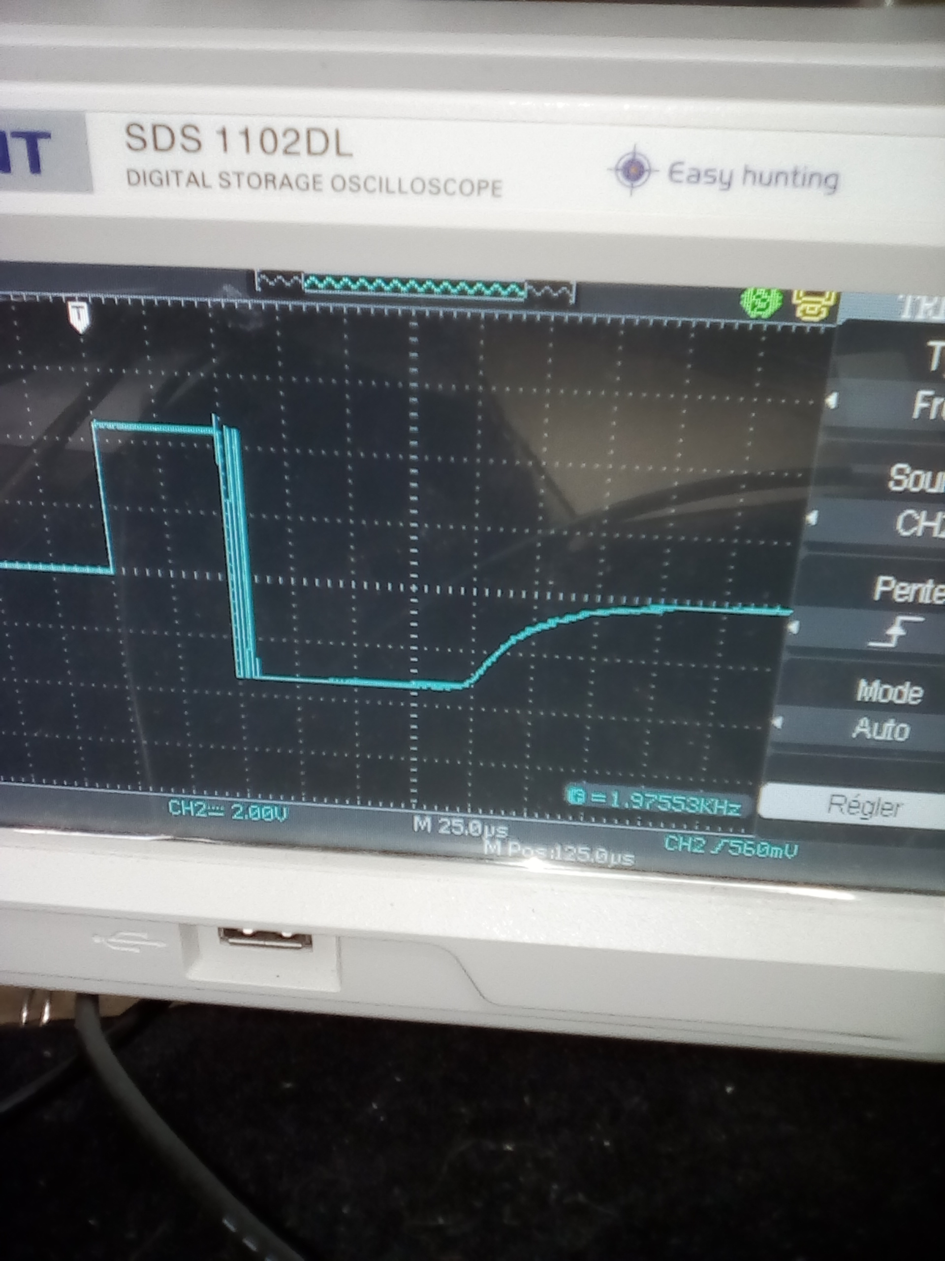

            I've restored my Surf as it was initially, then i've followed Tepco mods which consist of changing values of R1 and R2 in order to modify pulse settings, and make Surf more sensitive to small objects.

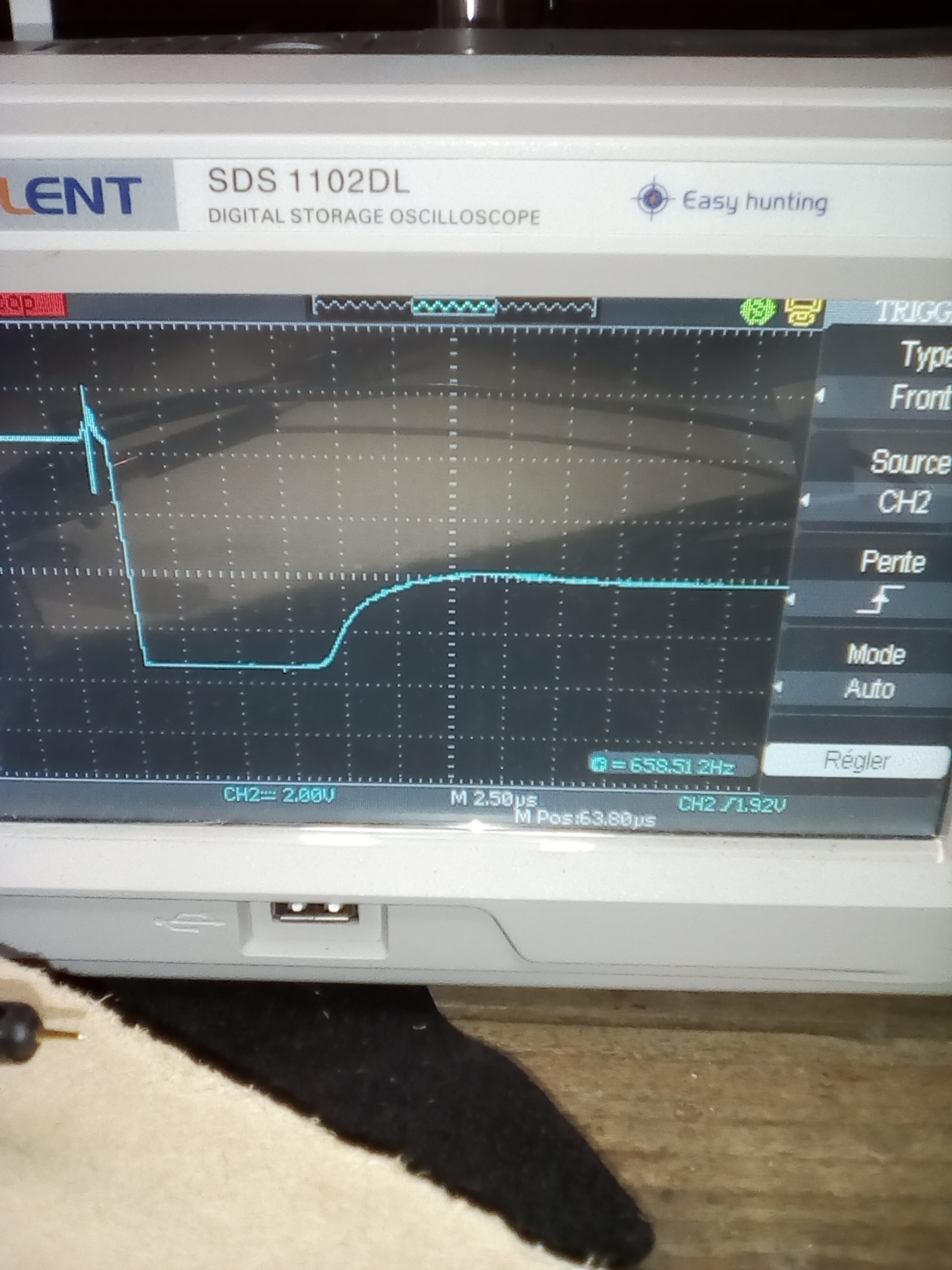

            Still got trouble, so i've made some measurements, and i think my 5534 is no acting properly... it should amplify my signal, shouldn't it ?
            I've got a good signal on the input, but a square wave on pin6
            well, i would very appreciate your help.

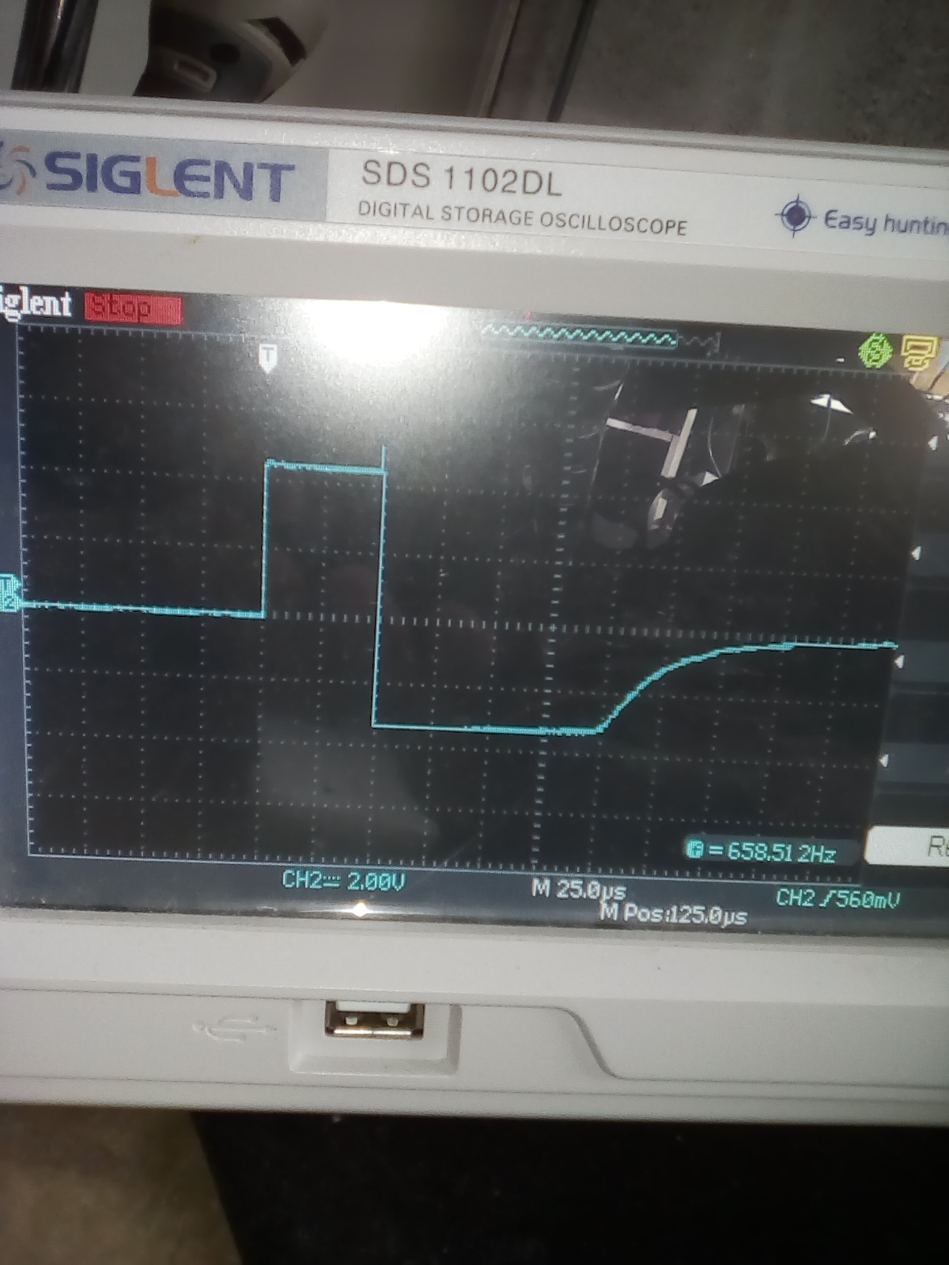

            Pics of scope are attachedClick image for larger version

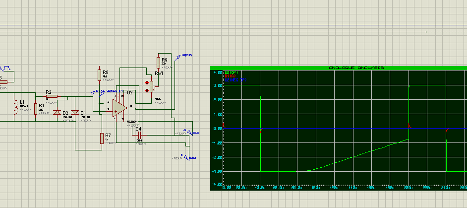

            i'm also trying to simulate surf on proteus, scheme is finish but the software give me trouble...
            thank in advance
              I've simulated the NE5534, if R(1M) is disconnected from pin6, i almost get the same issue...

                    Replace the 5534, probably its fake, check it using multimeter , between pin2 and pin3 you must measure a diode (0.6v)
                    i had the same problem with 5532.
                      Problem solved by re-soldering components ! But I will have problems with lm328... It goes only to 0v or 3.7v
