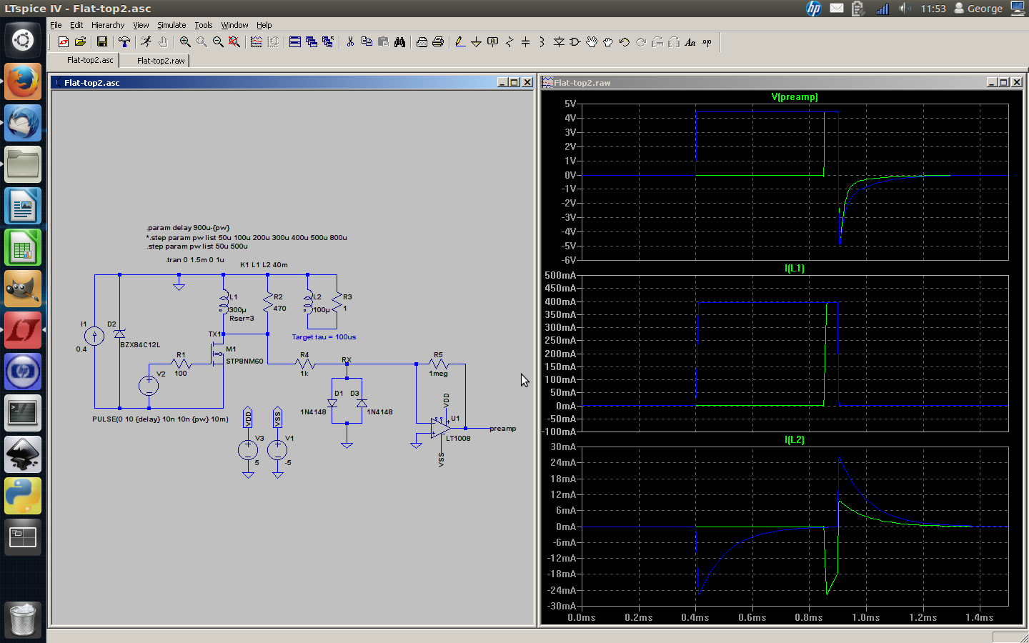

          Here's a variation on the previous simulation, with each TX pulse ending at the same time, instead of starting at the same time.
          To make the display less crowded, I'm only showing the results for a pulse width of 50us and 500us. Although in both cases the coil contains the same amount of energy, it is obvious that you need to wait for 5 target TCs to allow the reverse eddy currents to dissipate. Otherwise the reverse eddy currents will cancel some of the eddy currents generated when the TX turns off. For the 50us pulse width, this gives a significant degradation in the target signal. In fact, more than 50% of the target signal is lost in that particular case.
          The 50us pulse width is shown in green, and the 500us is blue.
            You can also see how the on-time target signal does not degrade at all. Long taus can be measured at full sensitivity with very short pulses.

              This will be true (of course) because the TX-on pulse doesn't have to fight with any reverse eddy currents in the target.

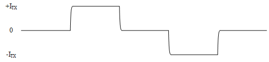

                      What's being discussed is what I call "constant current PI" (CCPI), where the turn-on time is roughly as fast as the turn-off time. One way to do CCPI is to pulse the coil on & off with a dead time in between:

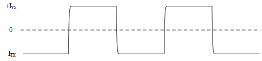

                      I did some work on this approach at White's. Another way is to continuously slam the coil between a positive & negative current:

                      This is what the Minelab GPZ does.
                      My personal preference is for the dead time approach. First, it avoids Minelab IP . Second, it's easier to implement. Third, the dead time is very useful. Fourth, although I haven't pursued this approach, I expect it would be useful to have the ability to control the turn-on slew rate. This is also easy to do.
                        So what I am taking from this is we need to flat top our tx current,and hold it there for the full 5tc of our desired target so the charging eddys will die out and not be counter productive to the rx signal strength. What is the method to get constant current in the coil other than series resistance?
                          According to Eric and Carl, you can wait for 3TC of the desired target, and it will close enough without wasting power to get the last few percent of target signal.
                          The simple method is to use a series resistor, but that fixes the TX pulse width, which is not adjustable without also changing the resistor value. The more complicated method is to use a constant current source as the power supply. I fudged it in the simulation by using an ideal constant current source with a zener diode in parallel to stop the voltage rising above approximately 12V.

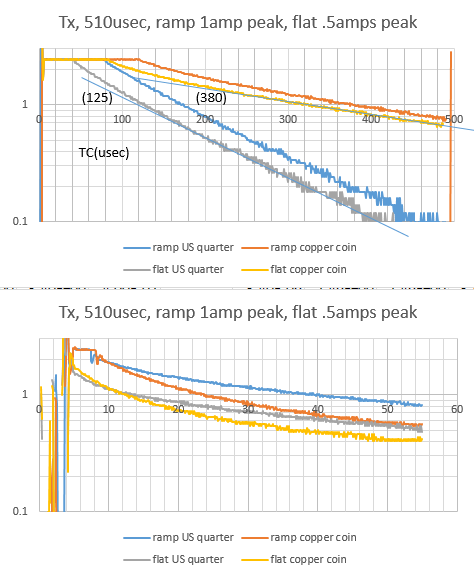

                                Another attempt at measuring the TC of a US quarter and a 1 troy ounce 99.9% pure copper coin(guessing it would be close to a US silver dollar). US quarter TC(at least 125usec), copper coin TC(at least 380usec). Are you suggesting a 1200usec flat TX when looking for a US silver dollar?
