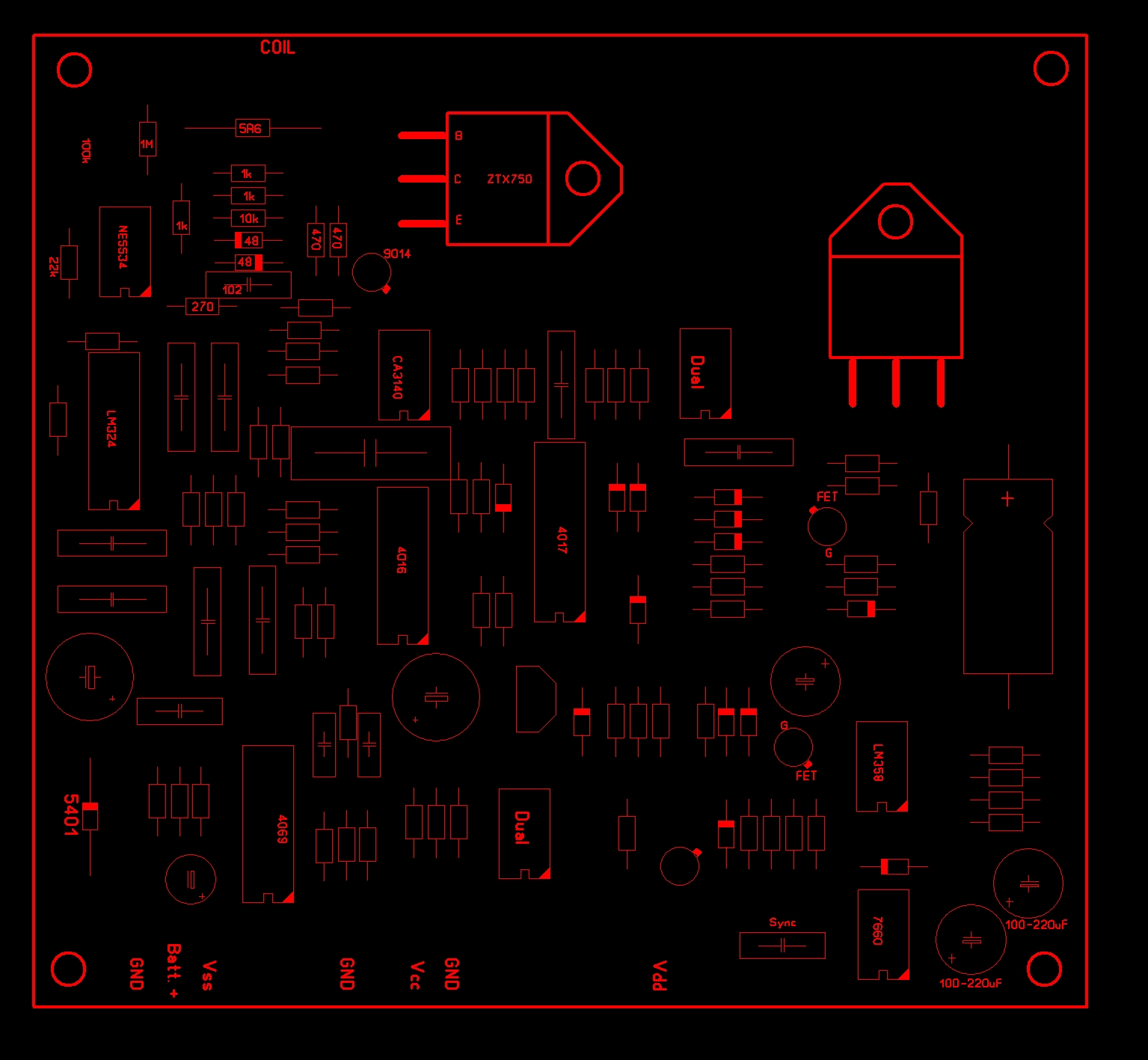

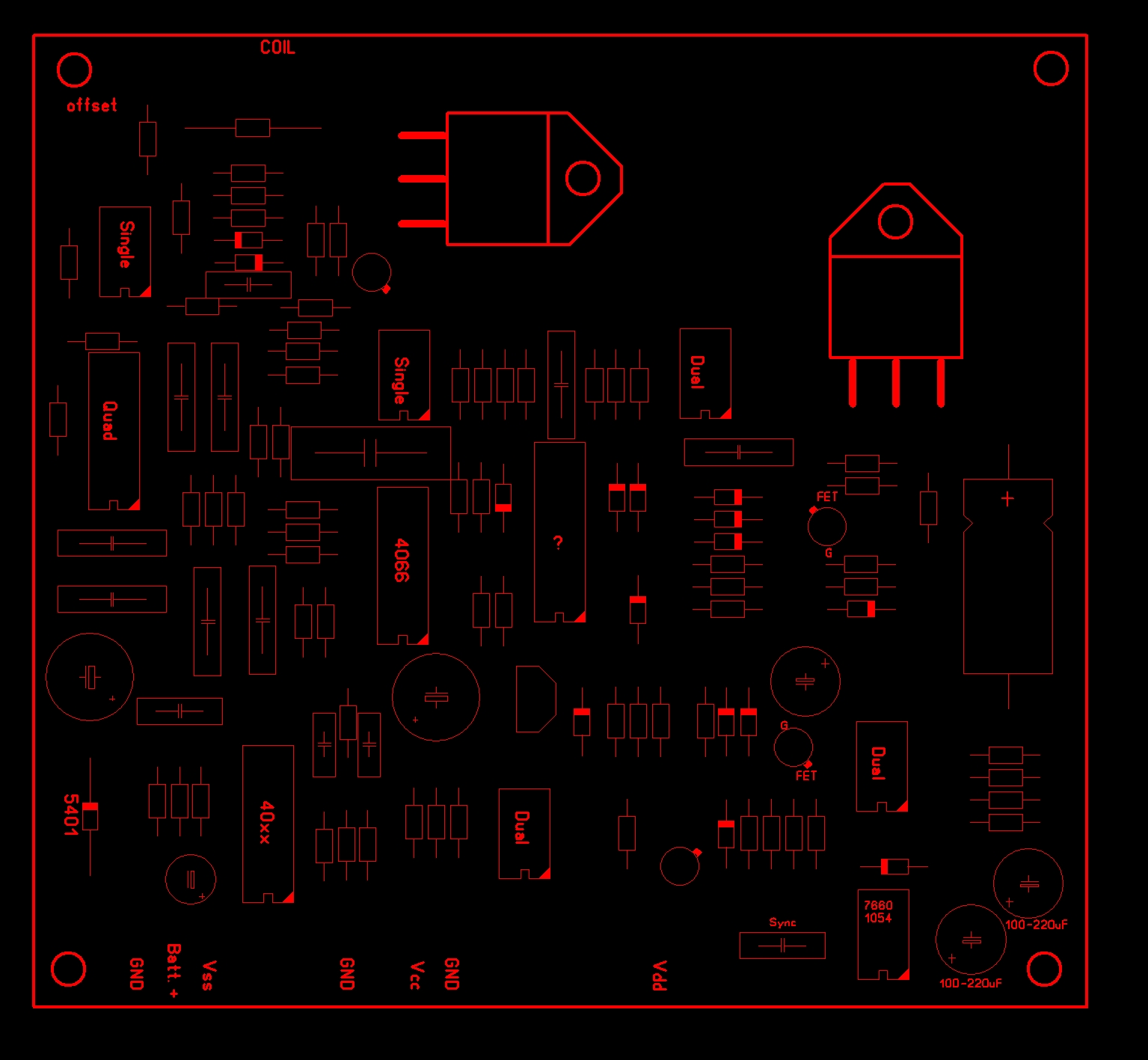

    It's also possible R24 was never installed, instead with a jumper? I was thinking IC4 is a CD4538 or similar and IC6 a CD4066.
    I didn't open your lay file, only your jpg.
    Eric may remember this unit?

        Carl was right; basically this is PI-1000!
        Oh how blind was i all the time!
        It was right there in front of my eyes all the time!

            On your pcb i measure 10 ICs but on schematic there are only 8!!!!

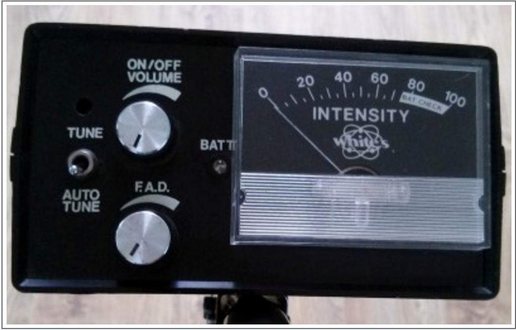

              Someone here has a PI 150
              They may send you a photo of there board if you ask.
              Might be able to eliminate or confirm one avenue

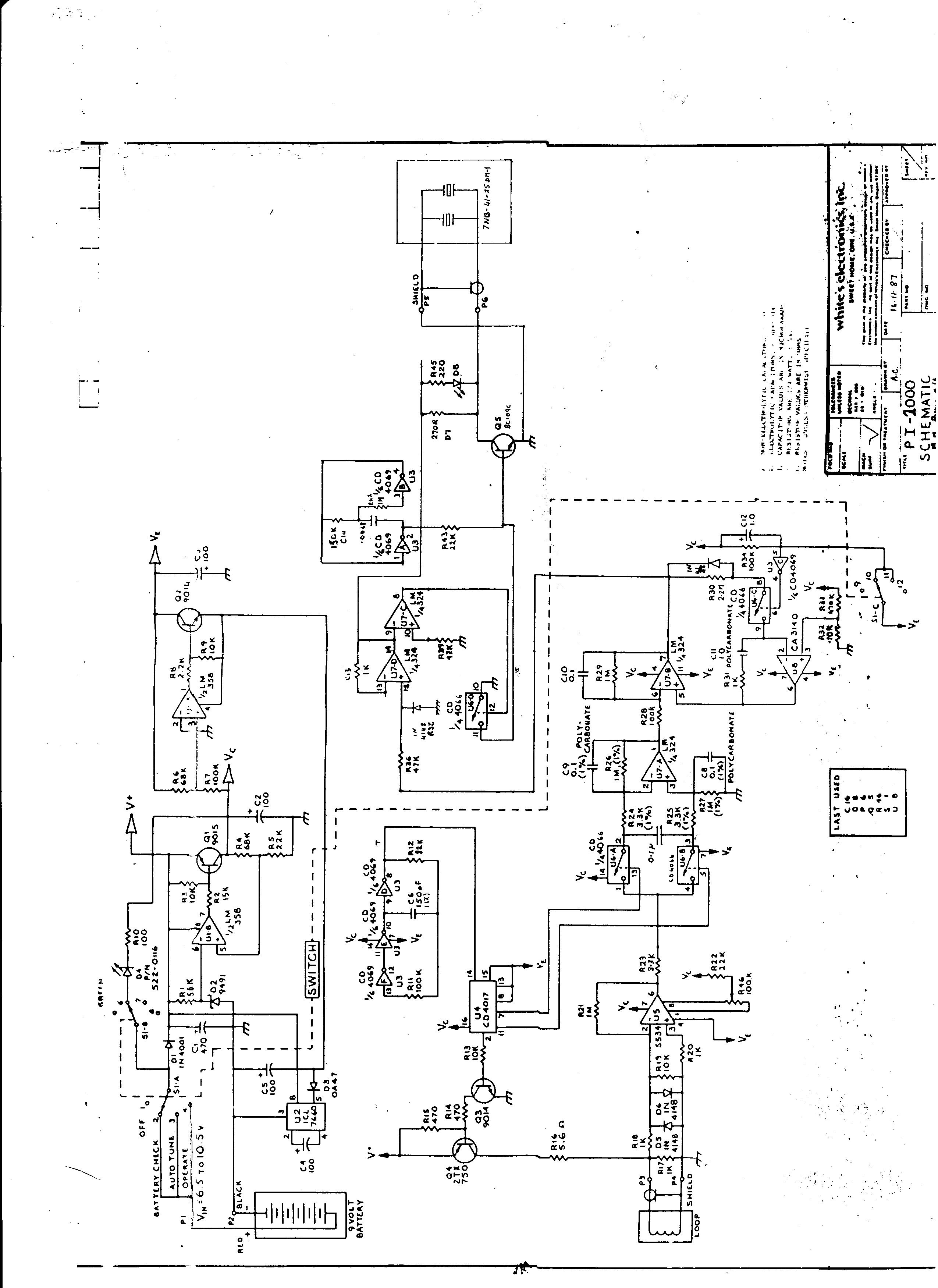

                Schematic and User manual:
                Yes that is the schematic i was comparing with this pcb.
                So far i traced maybe 30% and those are equal.
                But also at some point i founded out small differences.
                It seems like PI-1000 but slightly modified.
                I will try to complete tracing and naming the components on pcb draw and later i will post it here.
                In meantime also discovered few minor mistakes (made by me) on the draw.
                Tracing component by component is best way to correct such mistakes.
                  Will check that as my work goes on.
                  As i said; seems this is a bit different than PI-1000, maybe some unknown variant?
                    https://translate.google.co.uk/trans...07&prev=search
                    I am not well informed about PI150.
                    Could it be that it is based on PI-1000 design?
                    Maybe those are very similar?
                      Definitely Bill's schematic and this pcb do not match 100%.
                      This is not exact "PI-1000", this is some variation, even more interesting!
                      According to pcb; pins 12. and 11. at 4016 are reversed on schematic.
                      Bill's mistake or...?
                      More to come.

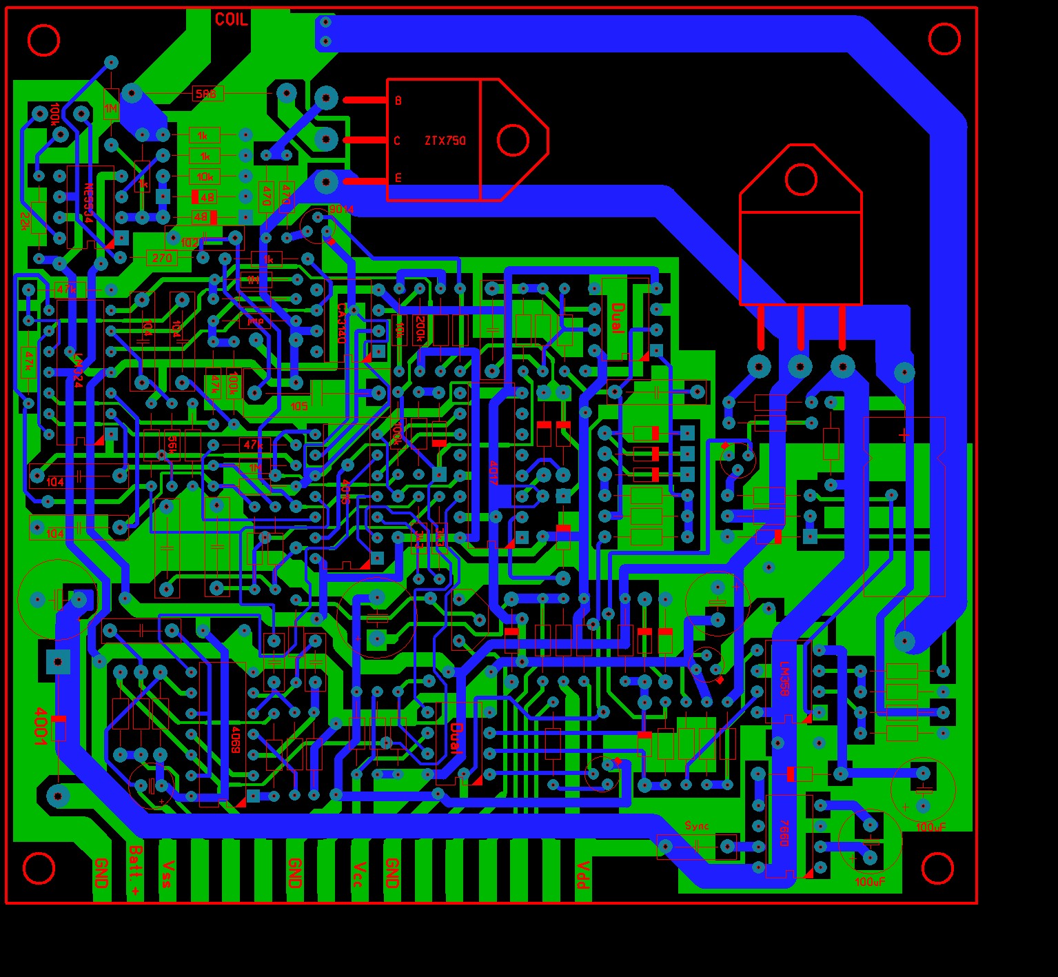

                      • #41
                        This is as far as i can get relying on PI1000 schematic.
                        Definitely this is not PI1000 but something based on similar design and extended more.
                        Without additional information this is not possible to solve easy.
                        But i am still convinced that this is very interesting project.

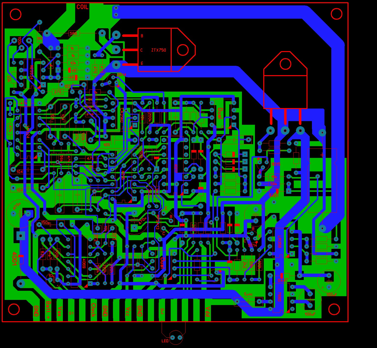

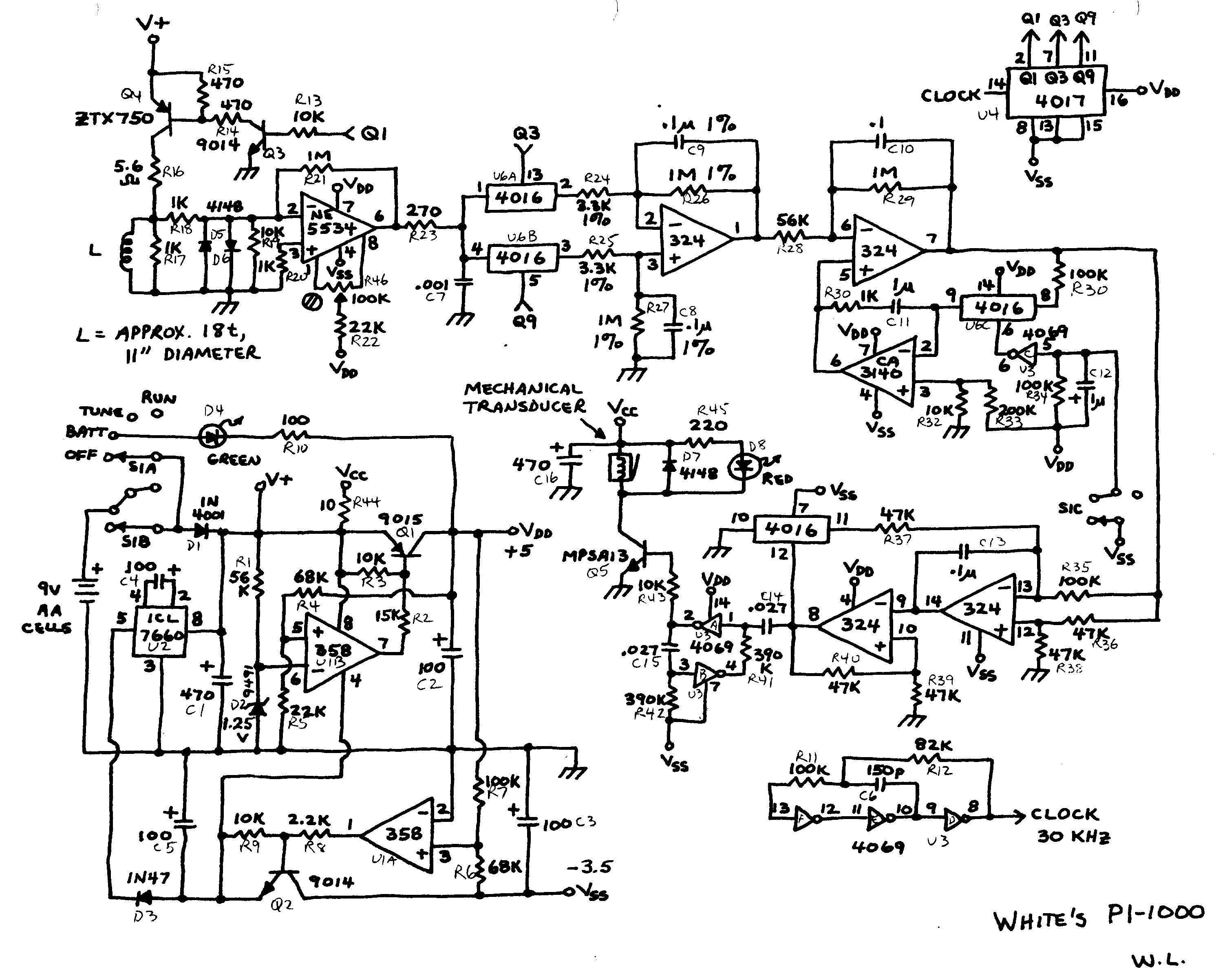

                          Here is the original ( I think) Pi1000 schematic.
                          It may help youClick image for larger version
                            [ATTACH]37574[/ATTACH]
