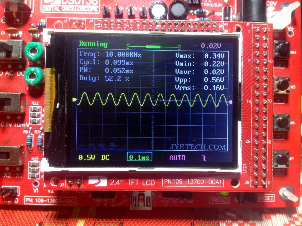

                          Sorry for interrupting with off topic stuff here; but i just got DSO138, put it together and played with it for couple hours, trying to investigate a bit detailed the real power of STM32F103C8T6's ADC.

                          I was thinking to add STM32F103C8T6 to my "artillery" along with dozen Arduinos that i already have.
                          There are pretty affordable STM32F103C8T6 ARM STM32 modules on market:
                          But there is one question i would like to ask you, before i order it.
                          I already installed Code Sourcery G++ Lite toolchain and tested few simple steps with it.
                          But it is still not that comfortable to work with as for example with Arduino IDE is.
                          I saw there is a way to use Arduino IDE to flash STM32F103C8T6 board through UART.
                          Not really a problem, i am already using UART to flash Mini Pro's.
                          But i was wanting to ask if there is any dedicated software similar to Arduino IDE for more comfortable work with STM32F103C8T6?
                          Something more "user-friendly" than invoking a toolchain functions through command prompt?
                          Is there a such thing? And what are you using in your work?
