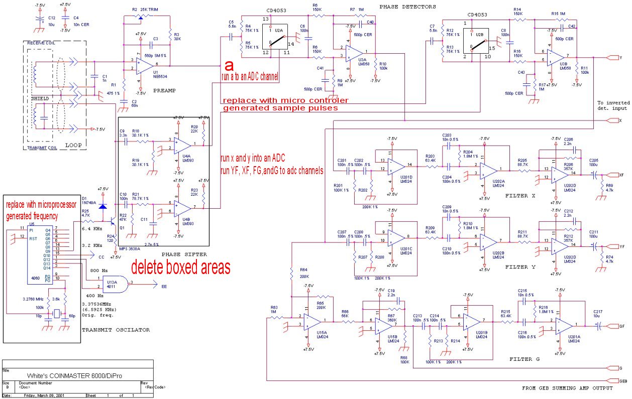

                            6000 di pro modification for computer control
                            This schematic shows modifications to the main guts of the 6000 di pro. Not sure where it came from, but almost 100% certain that it came from geotech originally. By deleting the area in the boxes, adding a micro to generate the frequency and the sampling period, tapping the received signal
                            with an ADC channel, and grabbing x,y,g,xf,yf,gf and putting them into ADC channels, you can do direct IQ sampling, as well as X,Y and G values, including amplifying the "r" channel.
                            From here, the ui and discrimination functions can be done in software.
                            It would be great to have this portion laid out on a PC card, with the signals avaialable on a header that could be plugged into an arduino compatible. That is, make a shield with the circuitry here, tap the analog lines, and two digital output lines. A properly laid out shield would allow this to be used with a huge number of CPU's that have boards with arduino compatible footprints, including the STMF411re nucleo board, as well as a number of
                            atmel and microchip boards. Ti even has a arduino footprint compatible MSP430 board.
                            If someone does this, it would be great to do it in KiCad, because that is very available, and a really advanced layout tool. I see .lay files all the time that I can't look at.
                            I'd also make R24 into a pot, like the 4900 sensitivity. That would allow a manual adjustment of the current going into the coil (because of the zener next to it that clamps the voltage). The other change I would make
                            is to put the sigbal circuitry in between the receive signal and the demodulator.
                            I wish I could get the electronic master to this so it could be edited....

                              The 16-bit ADC is nice! However I don't have experience with PICs unfortunately. The integrated on-chip opamps are often not suited for the job.
                              Sampling at every degree means a very high sampling rate and a lot of data to process. E.g commerical detectors have a frequency range up to 15kHz. Getting 360 samples on a full cycle, means 360*15Khz = 5.4MS/s. This fills up your RAM really quick, and not much cycles per sample left.
                                No you are wrong there. 60 hz is 16.666 ms i.e. (1/60 ) * 1000=16.666 at 15000 hz you have (1/15000)*1000 = .066 milliseconds. that is a full cycle. divide that by 360 and you get 1.185 10-4 milliseconds per degree. .00018 milliseconds. That is .18 usec per degree. so sampling 1 cycle at .18 usec, 16 bit resolution, it would take all of 2*360 = 720 bytes. It takes more memory to do slower
                                frequencies. You fundamentally mis-understand frequency. You are giving the amount of memory to digitize 15,000 cycles. We only need to digitzed a maximum of 10 to get 10x over sampling.
