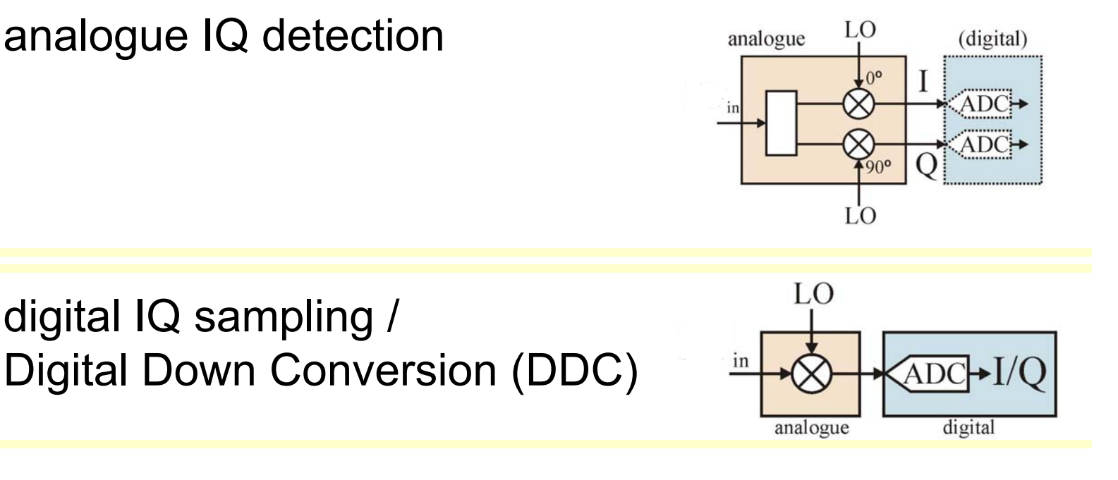

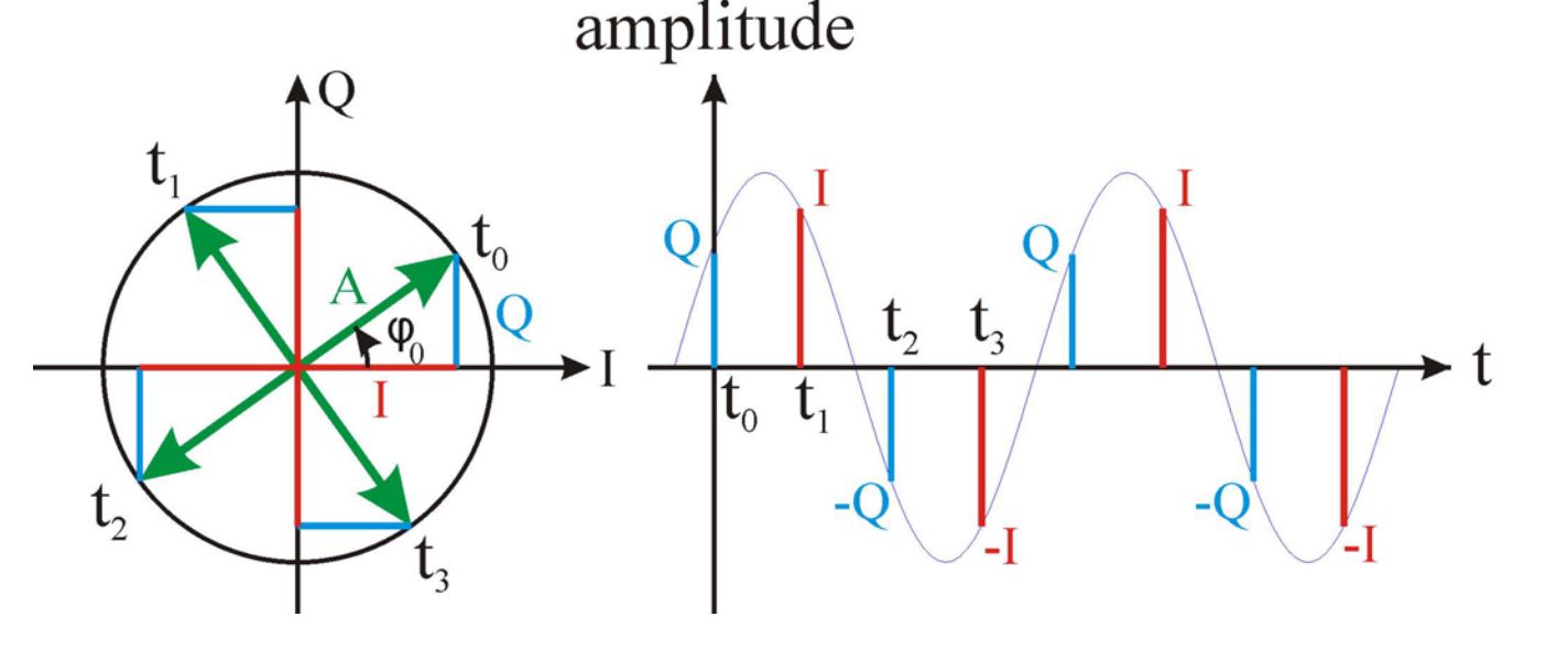

      For IQ demod Mr Nyquist says you have to sample a minimum of twice the highest frequency ( ie 2 "I" samples and 2 "Q" samples) for every cycle. So the sample frequency for 15 Khz is 30 Khz. The I and Q samples are separated in time by 90 degrees. There is no need to sample more than this per cycle. Gather up sufficient samples ( eg 1024 ) and then do an FFT / DFT .. this will give amplitude and phase.

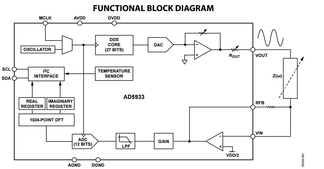

      The AD5933 does all this in one chip .... ;-)
      and you can get it on a little pcb here ... http://store.digilentinc.com/pmod-ia...ance-analyzer/
      Even though it is classed as an "impedance analyzer" ... it makes a superb dsp engine for a discrim detector.
          [ATTACH]38472[/ATTACH]
          [ATTACH]38473[/ATTACH]
          you're correct of course. However if we oversample,exactly four times the TX frequency we can drop the mixer and sin/cos local oscillator because the samples are already 90 degrees apart. This makes the implementation trivial, oversampling by a factor of 4, collecting 2048 samples over DMA, gives me an interrupt every 32mS with 1024 I and 1024 Q samples, interleaved in an array. This gives me 32mS to process the batch while the DMA continues to fill up my buffer in the background.

              AD5933. Nice chip. I think I'll propose using that in one of the medical devices I work on.
              It looks to me like this chip can generate the excitation frequency as well. Could it be as simple, as using this chip to generate the frequency, and feeding the resulting signal from the coil into the input, and then just reading the results directly over the I2C bus at 400,000 bits per second. I'd be happier if it were SPI, even though I hate SPI, it at lest will read much faster. I don't see how one would be able to track the data in real time, by reading the I2C at 400,000 bits per second....

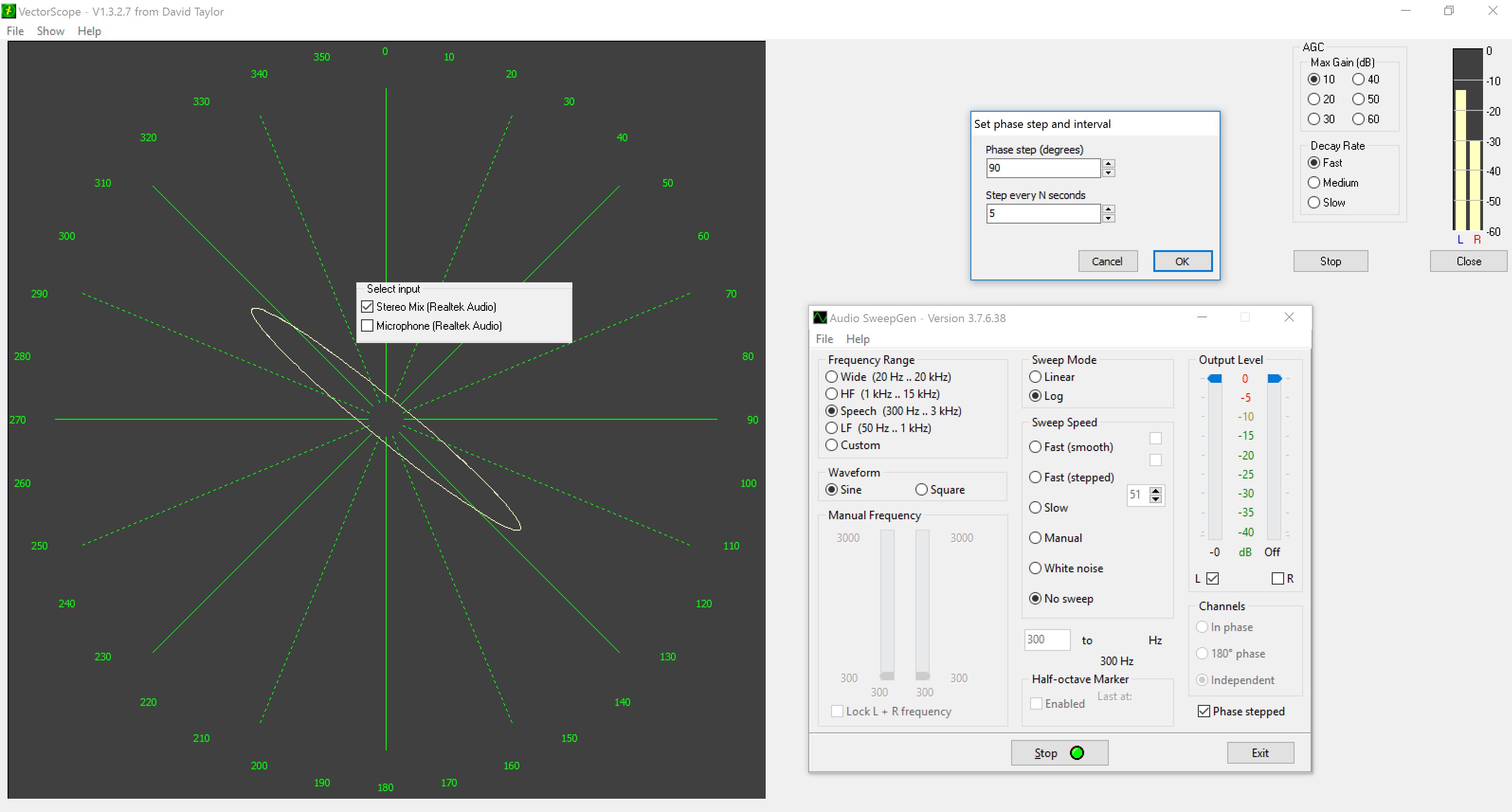

                    ...a PC soundcard could do the TX and IQ RX ... try the audio tools from here ... I set the PC to internal sound loop using stereomix ... http://www.satsignal.eu/software/audio.html .
                    You dont have to register the tools to use them .... great for basic experiments ... see how the phase and amplitude varies on the vector scope ... compare response of capacitor / inductor and resistor ....
                    A real detector would require you to write code ;-) .....

                          Yep they use the trick with 4x oversampling, I'm implementing on my STM32 at the moment. The trade-off is that the timers must be in-sync and frequency resolution is limited.
                          What I do at the moment:
                          - Full sine wave table with 4096 entries, 16bit
                          - 32-bit phase accumulator for DDS
                          - Calculate phase increment for desired frequency
                          - Double buffer for RX and TX to hold samples for about 10ms (= 5ms double buffered)
                          - Configure ADC at 5.33MS/s with hardware oversampling, i.e samples are accumulated in hardware, using a 64x oversampling gives me 83kS/s maximum sample rate at 15bit.
                          - Configure DMA for both DAC and ADC in cycle mode with interrupt on half-full / half-empty
                          - Configure Timer3 to trigger at exactly four times the sampling frequency, starting both a ADC and DAC conversion simultaneously
                          - In half-full/half-empty interrupt (occurs at a rate of ~200Hz, every 5ms):
                          - I fill the DAC buffer with sine values (DDS)
                          - I get the RX samples in an array, interleaved - i.e samples[even_index] = I_i and samples[odd_index] = Q_i
                          - I downsample the I, Q values
                          - Write values to PC over UART for debugging
                          That's my goal for the moment, still missing the pre-amp and coil driver, only function generator + oscilloscope hooked up.
                          The tricky part is to find optimal values for the TX frequency, so that I can configure the timer to trigger at 4x the TX frequency (prescaler, period).
                          Not sure how much I gain by this batch processing, maybe a simple interrupt at 4x TX frequency would work fine too.
                          If somebody is interested in the hardware oversampling: http://www.st.com/content/ccc/resour...Analog_ADC.pdf
