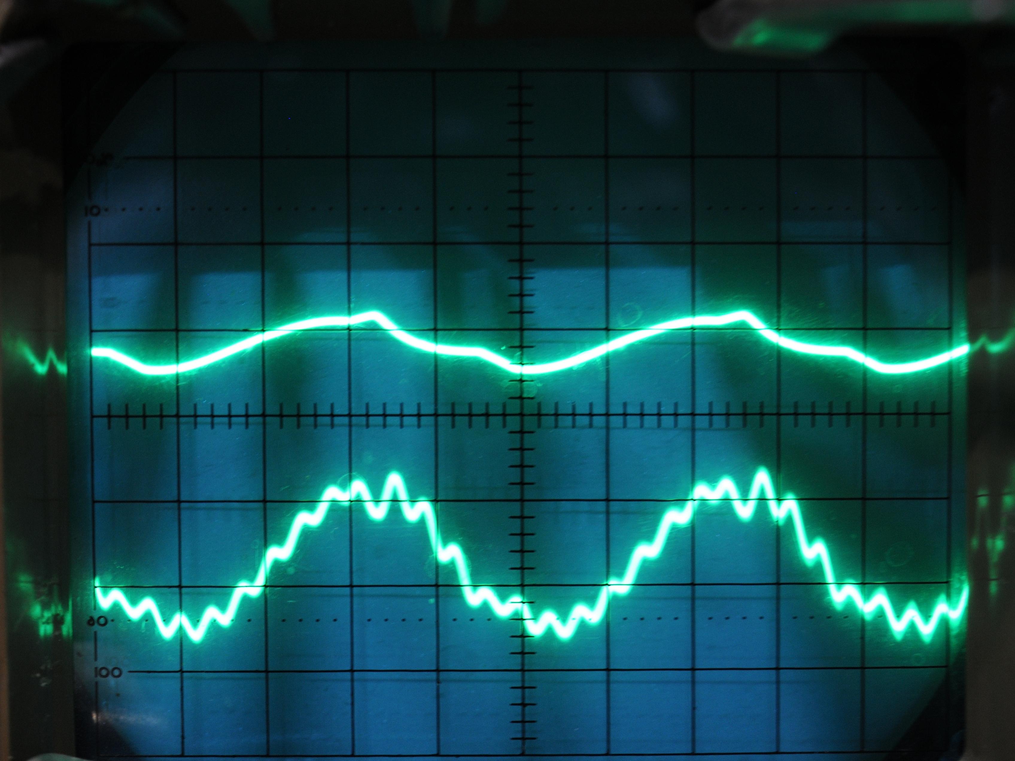

      • On page 86 fig 9-4 would one of my problems be coming from the BC327 and BC547 two transistor oscillator? even though i replaced both of them perhaps one of the resisters values had increased causing the step ladder effect?
Name:	8inch 6b coil.jpg
ID:	359050 it is also doing the same thing with the 15 inch 6b coil only the steps are more vertical and horizontal

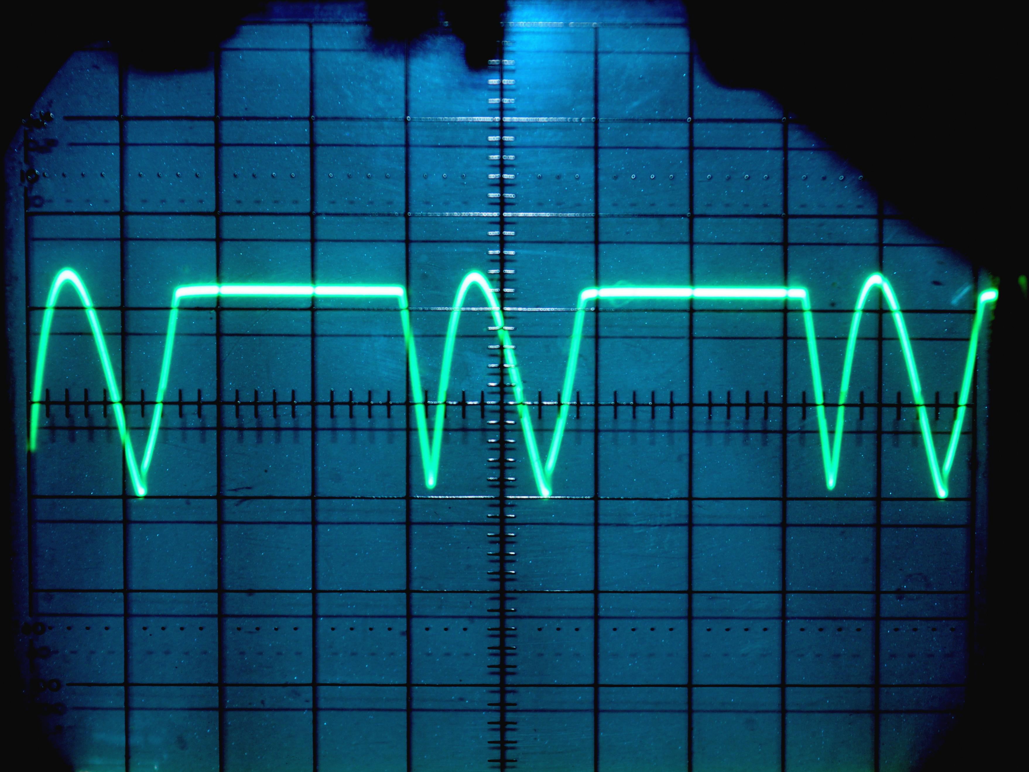

          • Thank you KT, not very helpful but thank you just the nonetheless, Why i am asking is if i prob the top of the board and they tops of the poly caps and the tops two transistors, i get the TX sine wave showing on the oscope with less amplitude then i would if i prob collector, also when i place the prob on the TX wire, not the bare wire but the plastic coating, if i keep probing the top of the board around U8 there are other wave forms showing on the Oscope.
            • This is the Tx oscillation from the transistors, with only a coil and U1 Ne5534, It look very different of that is described on page 76, When all other ic are in the board this wave form can be seen throughout the board, is this a normal oscillation waveform?
