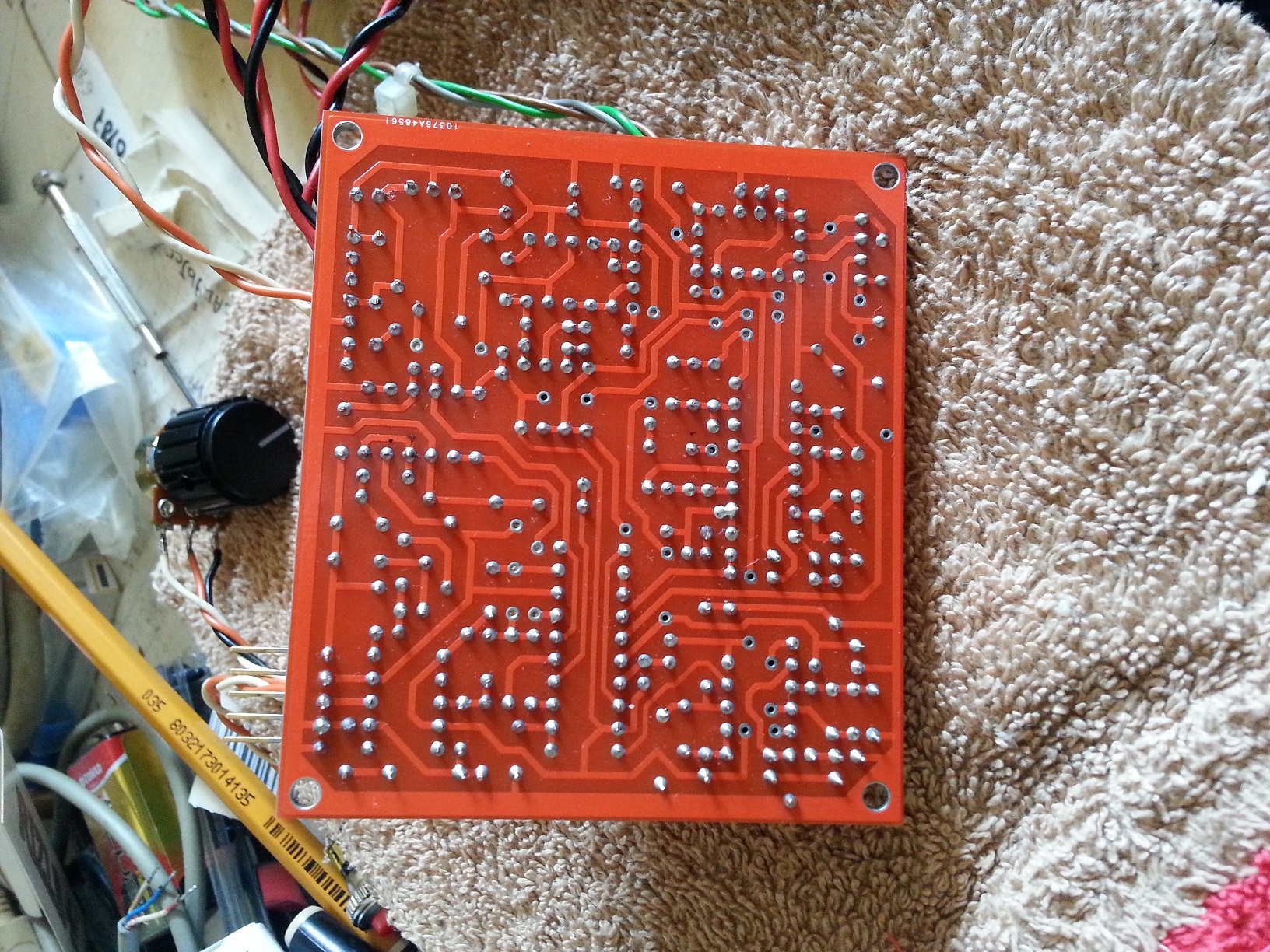

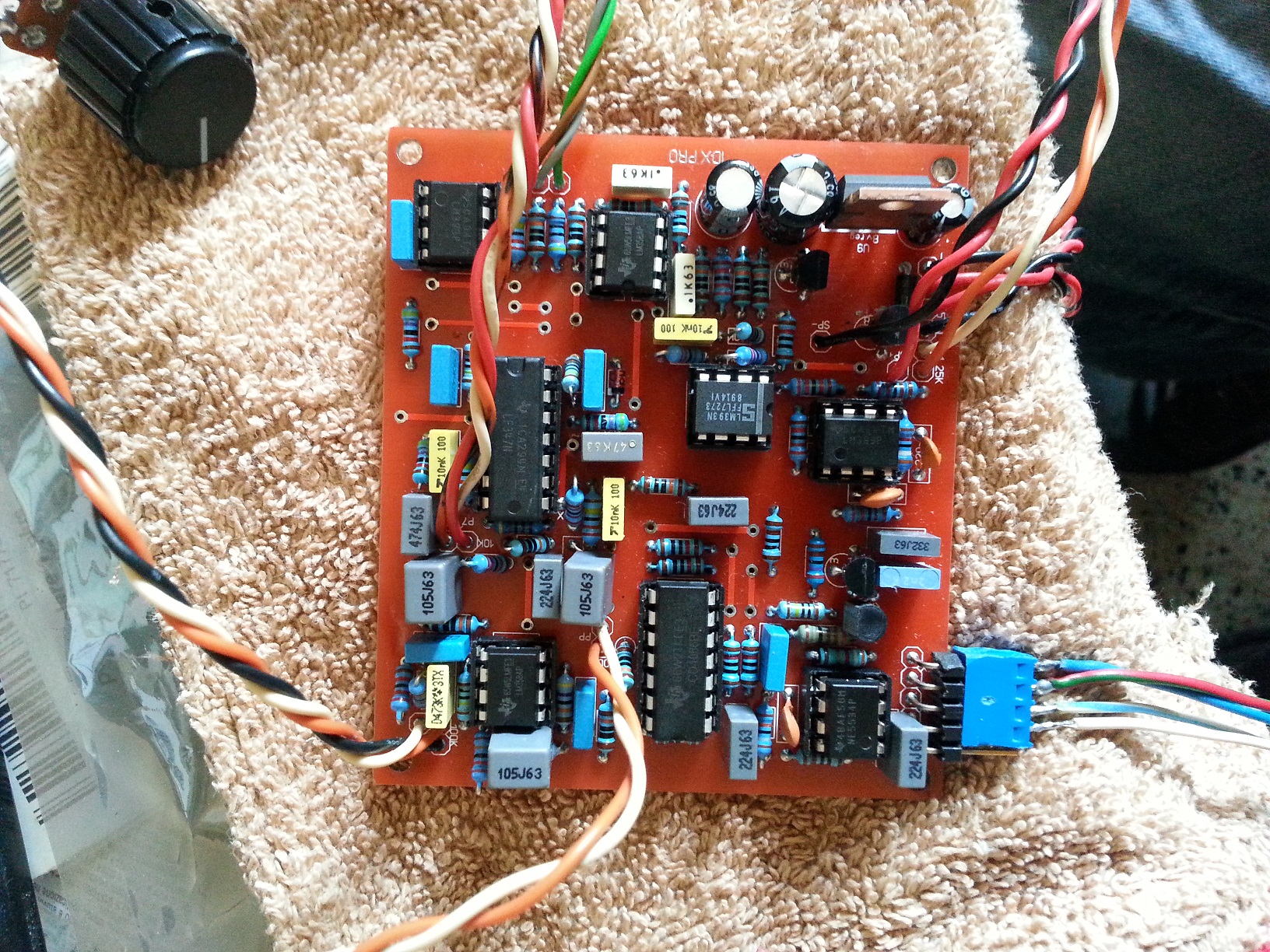

    Hi Guru's my idx pro not work but i have no idea where begin to control this circuit!!! I have only checked the + and - rails on the ic's and all seems ok, but no other check i have made. i did a 27DD coil with wire that i had in home... for tx 0.55 and rx 0.35. When i have turned on i heard a single beep and in range of 13cm far detect a cell phone. i Turned off and pull off all ic's.... i remounted ic's and from then on i did not have audio signal.
    Where do I start checking?
    Thanks to all those who want to help me!!!
    This is my pcb

            do you have an o-scope?
              Guess something went wrong with the reseat.
              Try beeping each pin from the top of the component to the bottom track.

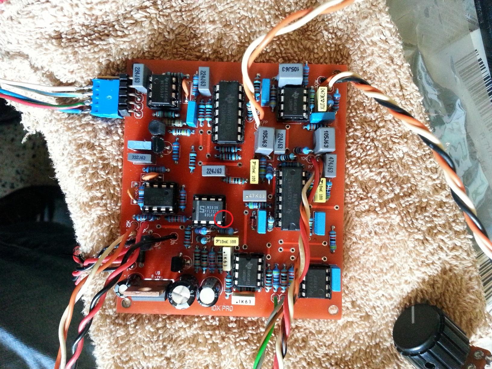

              Something looks wrong here

                  I have recheck with beeping all ic's pin's from top to bottom and all welds are ok!
                  In photo you see the little tin solder ball that i have removed but i think that not did do any short. You have hawk eyes Koala!

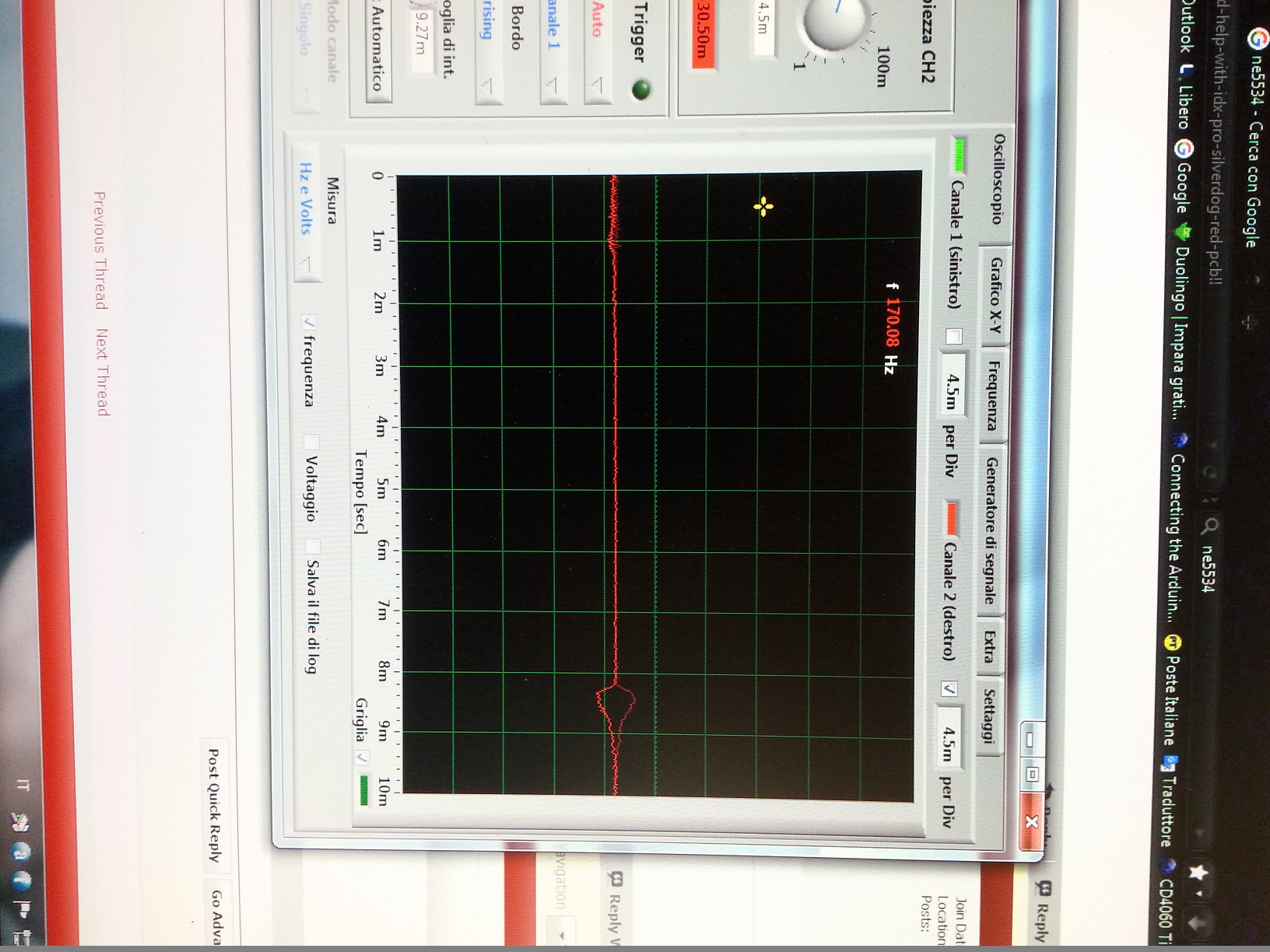

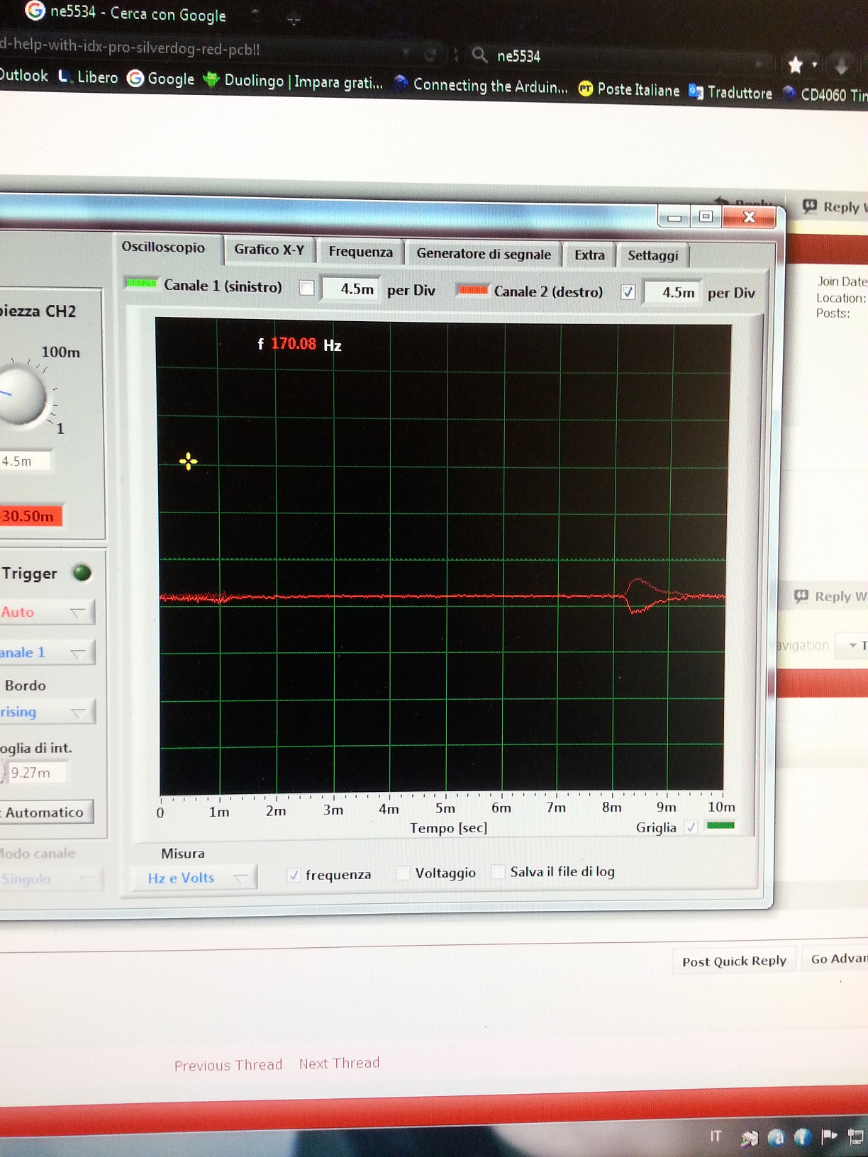

                  kt315...I have turned out coil and from circuit ground and pin 2 of u1 i have about 150 180 Hz fluctuant signal not 50Hz
                  This is what i view
                    is that lf347 the right wayround?.
                      Thanks yes it is in the right way!! Yesterday i have bought the right wire size and in the next few days i will winding the coils and return to forum with news!
