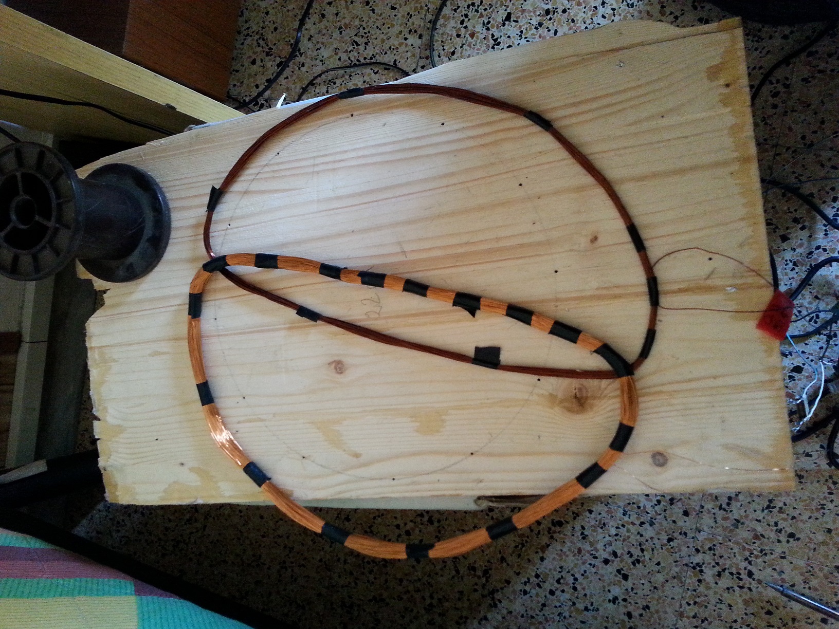

      No eduardo my coils are umbalanced and for reach 6.5Khz i have mount 3 or 4 capacitors! but if you say this, i rewind a coils and perform measurement for exact mH and impedance....i have bought the exact size of wire that i read on forum 0.70 and 0.18 mm!!!
      But if this is true why my detector at the beginning have ringed with some pieces of iron and with my cellphone?
      Thx
      This is the coil tx 0.5 and rx 0.35(too much big)

        I also had a problem, but my fault ... I replaced the lm358 by a 4558 ... and so it does not work. J had manufactured a concentric coil but the operation is not good. Made a double d in 27 ... but after measurement, the tx made 1.5R for 550mh son 0.25 ... this work @ 6.70khz ..... and not 6.59 with 1uf it goes to 6.67 khz. My question to the gurus of the site is: is it a problem if the frequency is a little higher?
        Moreover, I find that sensitivity is not very good.
        Thank you all for your help .
          oupss.. 0.25 for rx coil ...
          it s 0.8 for tx ..... sorry

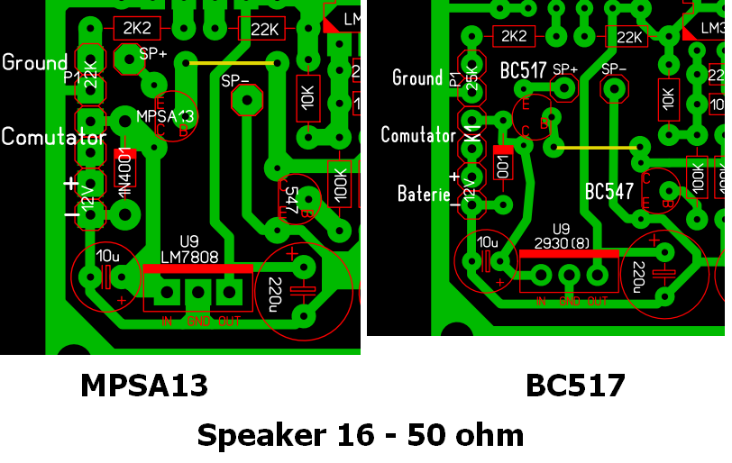

            I have problem Q4 BC517, always getting Hot, with or without sound beep.
              Hello, check r39 .. 22k, the meaning of Q3 is it good? It is the power supply of your circuit? L impedance of the hp? I am not a specialist..but this is the first test to do. good luck .
                Thank for reply lamoiz,
                i use 8ohm speaker, and i use lithum bateray 12v, what volt at R39 22K?
                  Originally posted by Wahyu View Post
                  Hi eduardo and Lamoiz
                  BC517 has different pinout than mpsa13, check that transistor, also try to replace U4.

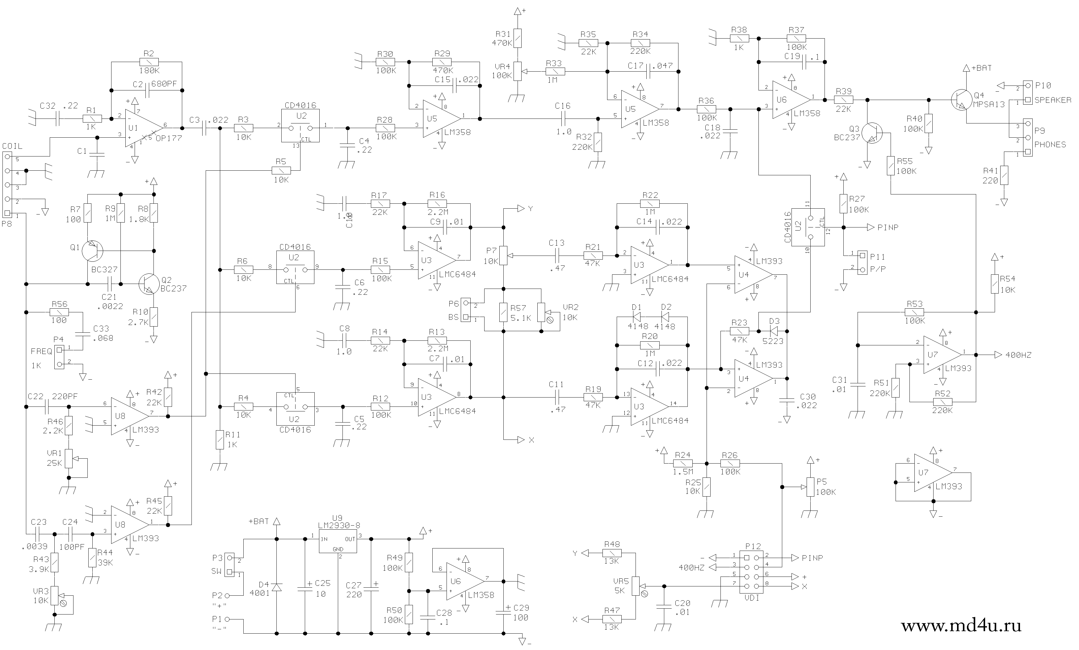

                    Hello CDI,
                    ok i will, i use this schematic
                    everything ok, discrimination work great, just BC517 getting hot
                    for U3 i use TL074 , and U4 LM393
                    thank for reply
                      check modulation signal from U7 Q3.
                          One stupid question: but, how much voltage u have on battery? I ask u this cause last time when i builded IDX for a friend, the same 517 audio transistor was hot after 5 minutes.
                          I had 4 lithium batteries 3.7v in series, which gives more than 20v when full charged.
                          Later when i removed one of those, everything was ok, bc517 remain cold.

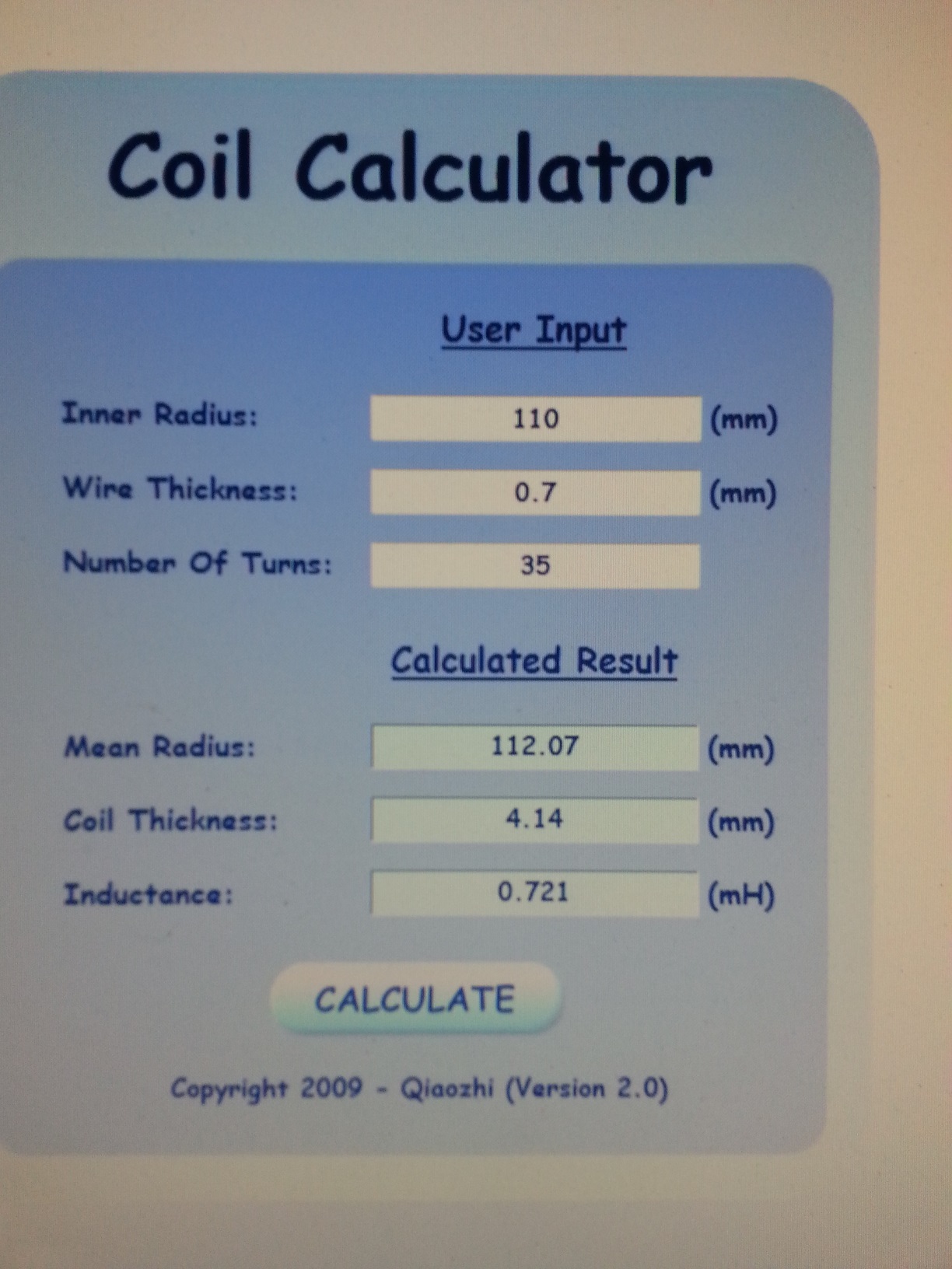

                            Some info before making the coils....
                            What is the right parameter in coil calcualtor for making 27DD coil?
                            In a discussion i had read this:
                            Actually, you can do a simple calculation:
                            D_Coil_Half_Circumference = (D_Coil_Diameter + PI * C_Coil_Diam / 2)
                            D_Coil_as_Circle_Diam = (D_Coil_Half_Circumf / PI)
                            Then just use D_Coil_as_Circ_Diam , in a Coil Calculator to get Inductance.
                            So, it seems that the D Coil Half as a Full Circle Diameter is about :
                            D_Coil_Half_as_Circ_Diam = (0.82 * D_Coil_Full_Diam)
                            So:
                            27cm DD Coil Diam => 22cm Diam as Full Circle <----someone confirm that this is correct?
                            13.5cm DD Diam => 11cm Diam
                            21cm DD Diam => 17cm Diam
                            41cm DD Diam => 33.5cm Diam
                            ecc. ecc.
                            All this because the data that is reported on the forum about 27DD coil with 0.7mm wire on calculator with 35 winding not correspond at 0.587 mH

                                Sorry for insistence but i need info before making coils
                                Someone can delete my doubt with a answer?
                                So:
                                ecc. ecc.
