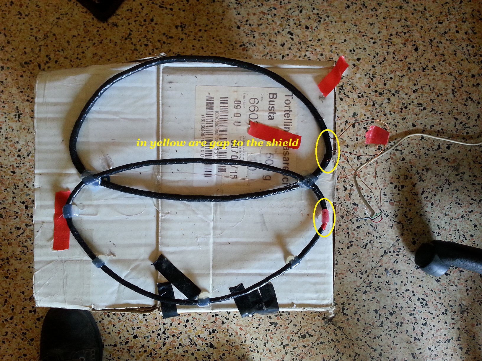

    Then just use D_Coil_as_Circ_Diam , in a Coil Calculator to get Inductance.
    If you're putting the coil diameter into the Coil Calculator, then that's your problem. You should be entering the radius.
      The problem is why with 110inner radius 0.7mm wire for 35turns the coilcalc gave me 0.721mH inductance when other people says .587mH with the same wire and turns and coil diameter!

        read this.IDX_Concentric_coil.pdf

            For a 270mm diameter DD coil, you have two diameters for each D-shape. To get an approximation of the radius for an equivalent circular coil, the calculation is (270 + (270 / 2)) / 4 = 101.25mm. Not 110mm. With 35 turns of 0.7mm wire, the inductance is calculated as 652uH.
            Obviously the inductance calculation is not an exact science, but it does get you close to the correct value. However, to paraphrase Charles Babbage ... "rubbish in, rubbish out".

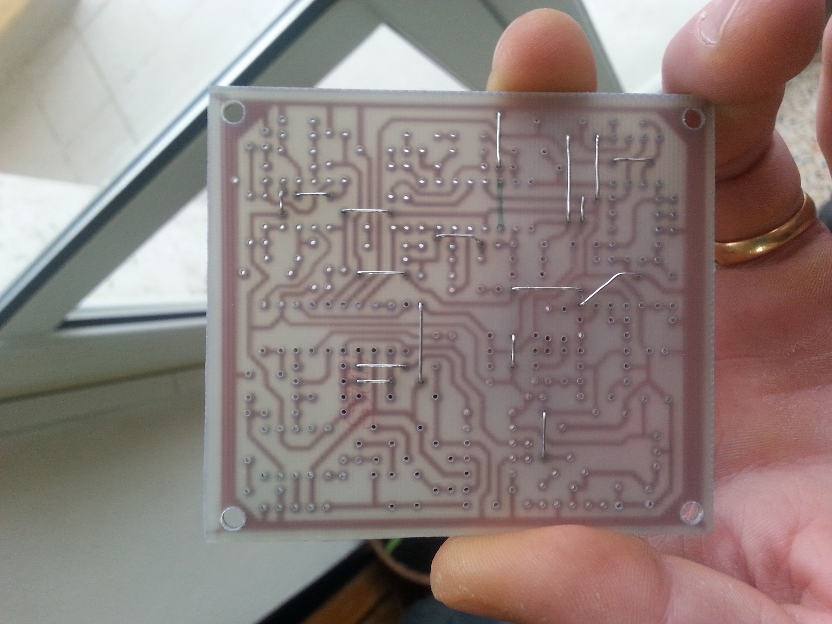

                  While I wait the pcb from silverdog.....i make this one for educational

                  But i still have to find time to build the coils
                  Good weekend to everyone!!!

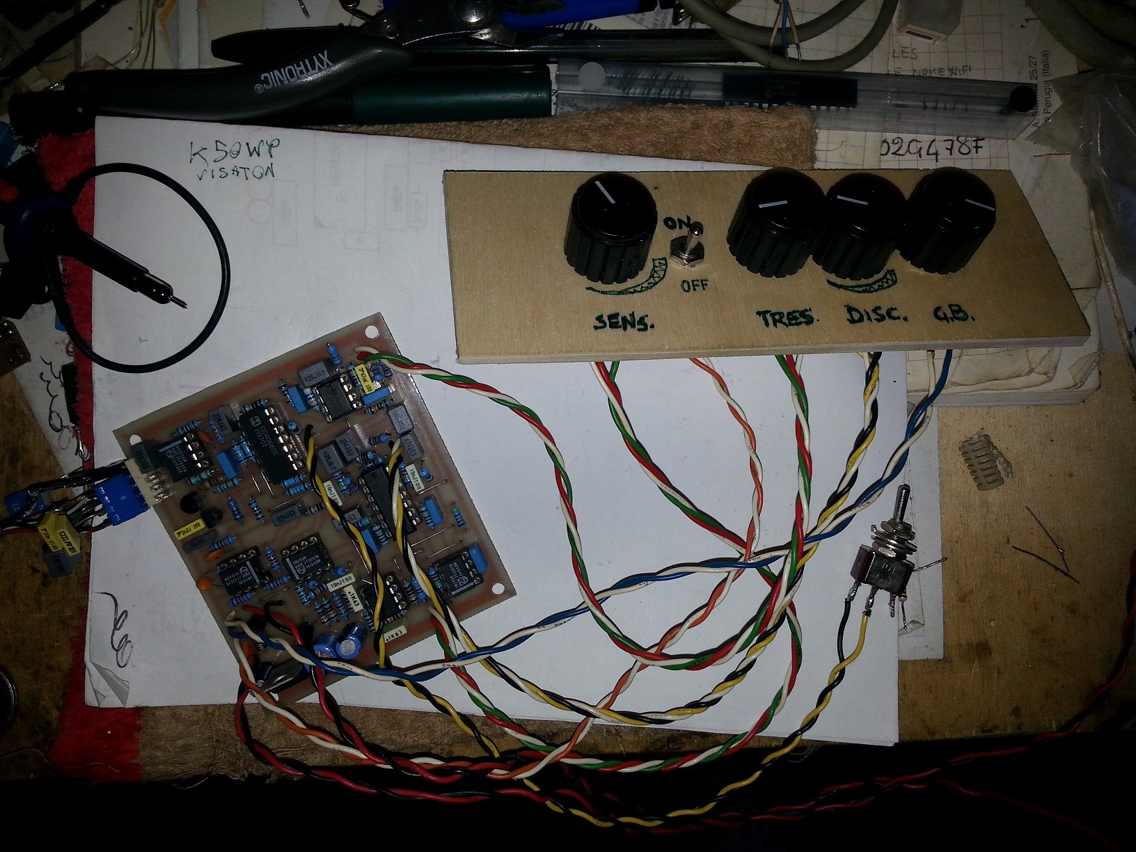

                    These are my last progresses on idx pcb
                    I wait ic's and mpsa13

                    Cheers

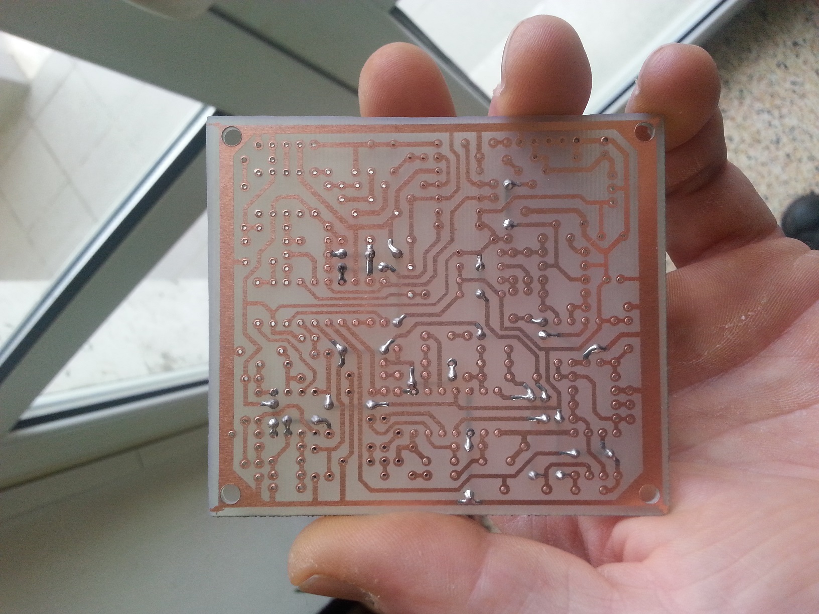

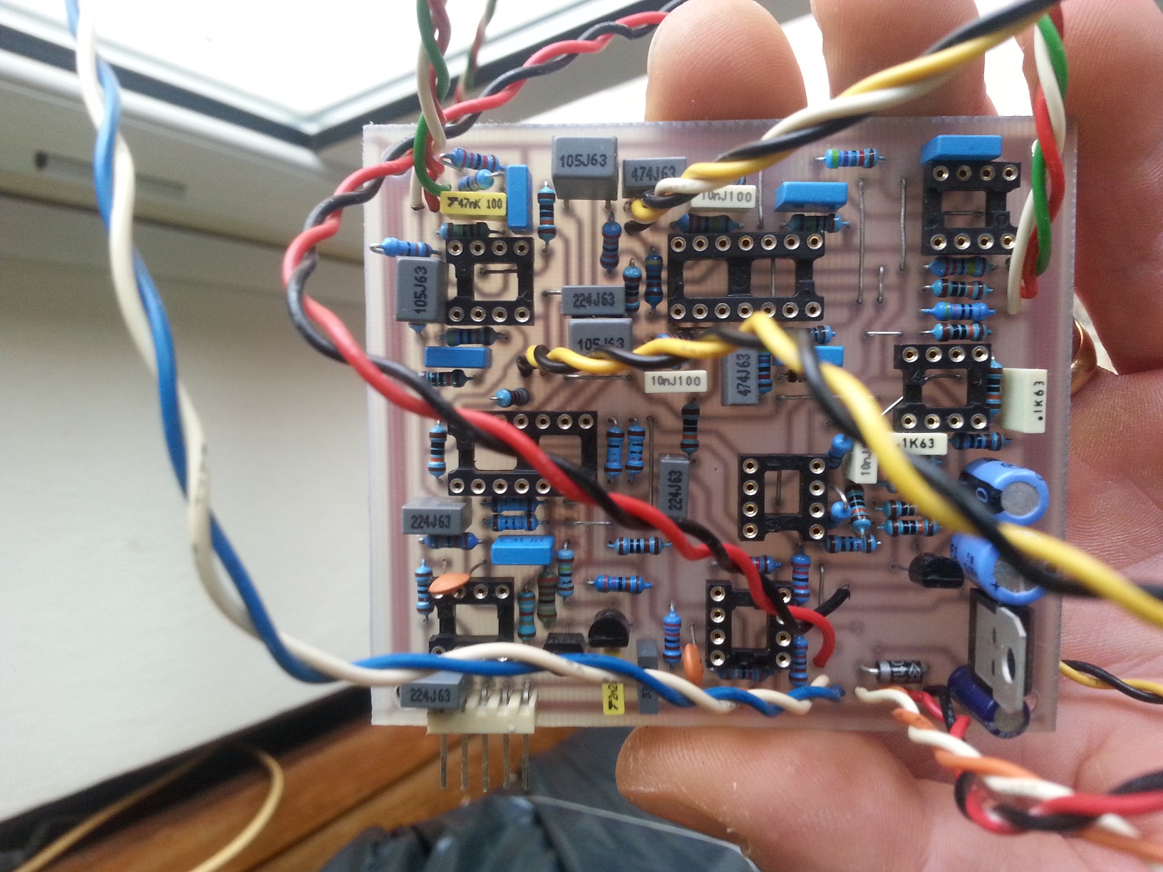

                      Hi friends!!!
                      This is my progress to IDX pro.....homemade pcb
                      all seems to work but i have some doubt on sensitivity...

                      The detector is able to view 1euro coin at about 25cm with discrimination
                      but i have the same distance without discrimination....why?
                      the coils are properly nulled with oscope and with perfect nulling point when i turn on the detector emits a slight noise only.
                      I return to forum for news!!!
                      Bye

                        Hi
                        Your PCB looks very nice, great job! What IC do you use as U3? LM324 or LMC6484 or LF347? I have tried with LM324 and I only got 25cm but with LMC6484 i've got 30+. With LF347 you should get 35 or more outside! not in the house. I have the same distance with or without disc on a euro coin about 33cm with LMC6484.
                        • #42
                          Hi NĂ¡ndor thanks!!!for u3 i've used lf347 but indoor i think the performance is not very good!! I want to test it outdoor but for final making i need a few days!!!!
                          See you next time for some news
