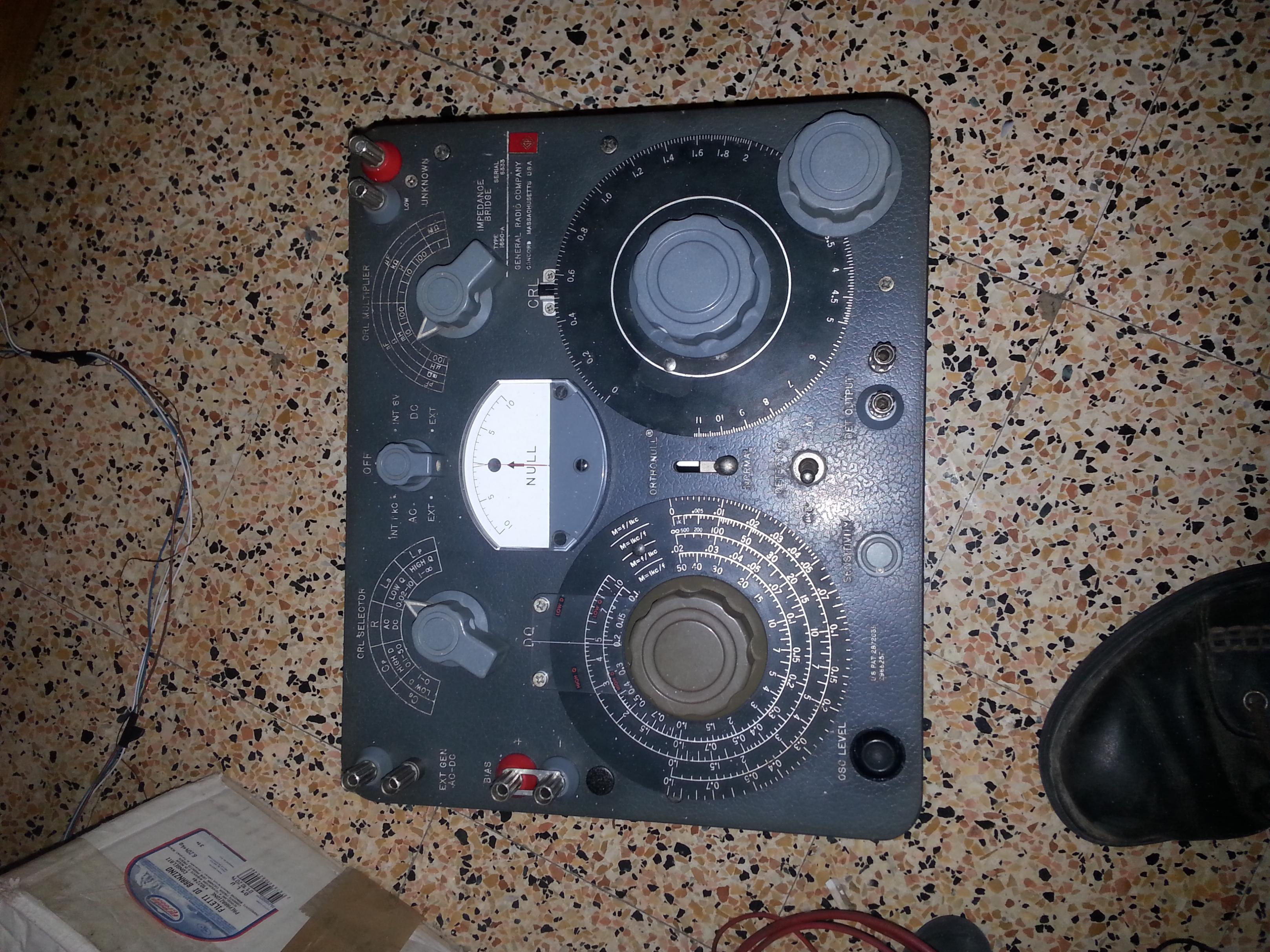

    This is my little.....LCR meter

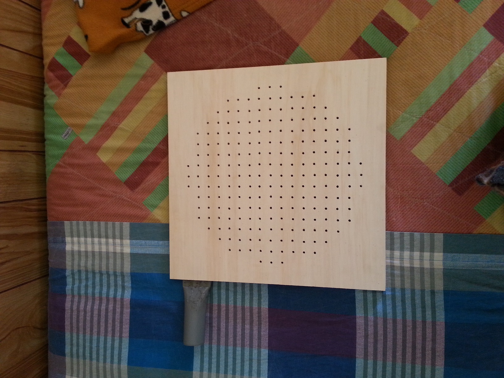

      Hi there!!!
      I have make this vacuum forming table because all other trials to make coils case are miserably failed!!!
      Cross fingers
      P.s. It is not over yet

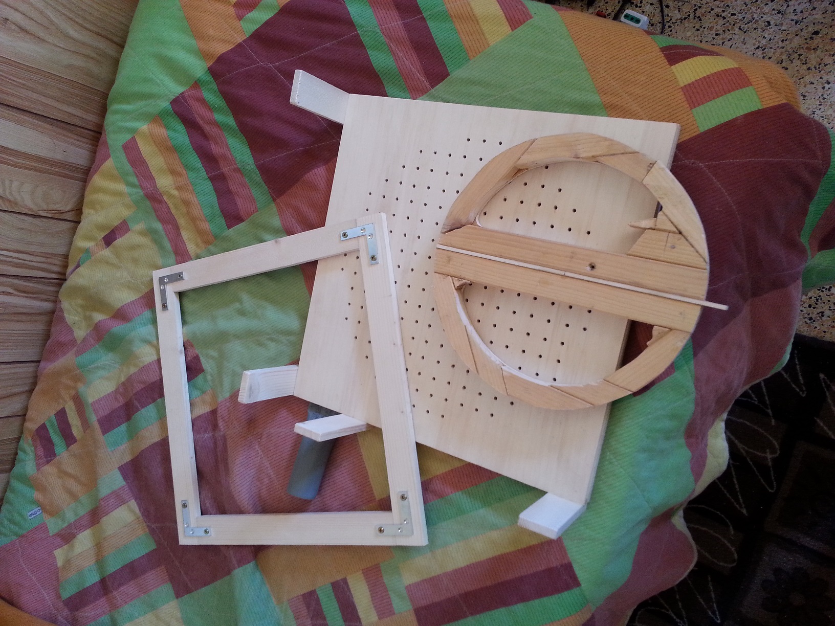

            This is my last project progress
            in picture you can see the vacuum table, the wood frame for fix the abs or pvc sheet and the wood coil form(not finished yet)
            Cheers to all

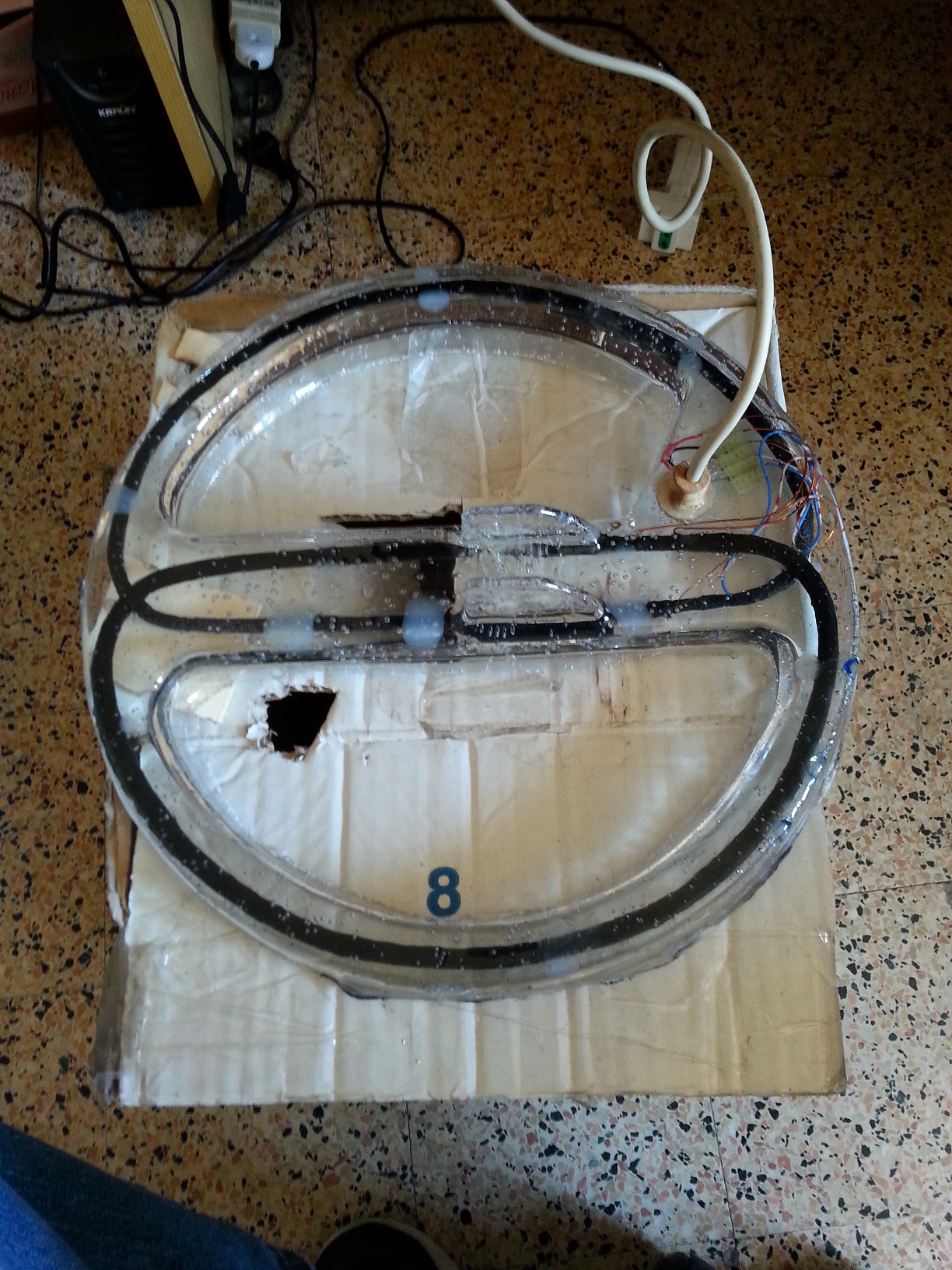

            • #51
              Hi there!!
              This is my thermoforming results with PC policarbonate 2mm tickness!!
              It is not perfect but not so bad for non use
              • #52
                Looks very nice! Hope you find good stuff
                • #53
                  HA ! I like it. You can see what's going on in there.
                  • #54
                    Cool. Nice idea! How is the performance of your device?
                    • #55

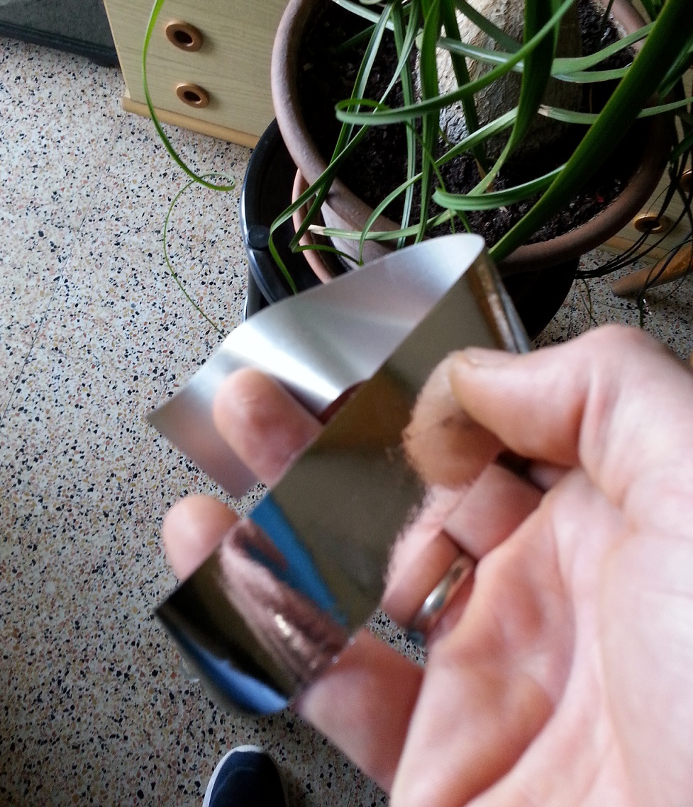

                      nice... how you will add shielding? i do not see right graphite layer...
                      • #56
                        I count three wires per coil, so he was using tape for shilding.
                        • #57
                          Thanks NĂ¡ndor, homefire, blobber, kt315 finally i have done it
                          In response to blobber.... in air test 34-35cm 2Euro coin with discrimination value sets to reject medium screw driver. Consider that my room is not wireless signal free and i have iron on the floor.
                          In response to kt315.... No i do not made shield with graphite because unfortunatly i do not have found it!! I have found in the store flowers a string of some sort of plastic Click image for larger version
ID:	348558 that had one side conductive and from tests i have done i see that in my case the response and discrimination are better than aluminum foil and i decided to wrap my coils with this, and finally with electrician tape.
                          Thank you all and see you with new news
                          • #58
                            I have never had any success using that aluminium covered Mylar if it's the same as the pound shops sell for camping.
                            First its its very conductive.
                            Second it seems to degrade with time.
                            Third as it creases the covering cracks.
                            Fourth no mater how tight I trap the tap wire over time the connection degrades.
                            I spent end quite a lot of time trying different things but failed to get it to work 100%
                            hopefully your stuff works better
                            35 cm sounds spot on. You can tweet the RX capacitor for more depth. Great for YouTube air tests but useless in the field.
                            • #59
                              Hi Koala! No it is not similar to mylar material (like of balloons)!!! This is much more strong in sense of thickness and it is used for flowers gift package and only one side is conductive! I have wrapped (conductive side internally) that tight as possible and in one side i have wrapped a copper wire tined for about 3cm . Considers that i have inverted a flap of this material for constrain with copper wire and in the end wrapped all with electrician tape. I hope that i made a strong contact between the wire and the shield and that it will remain for long time....i hope
