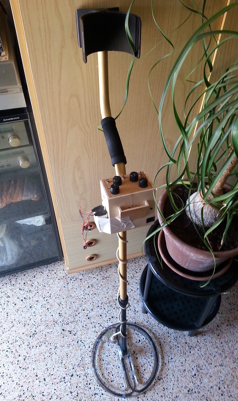

    Hi NĂ¡ndor! This is my new unit assembled and ready to try it out!
    For now I have taped two 9 volt batteries, then if everything works, I'll see where to put them!!!
    Crossfingers
    • #62
      Very nice box design! Have luck!

        8x AA battery work well. Using headphones I get will over 20 hours probably near 40 but I change after 3 days detecting.
        • #64
          Thanks Koala for the info but i want to recycle what i already have
          • #65
            Thank you, in the next few days i painted it in black! See you

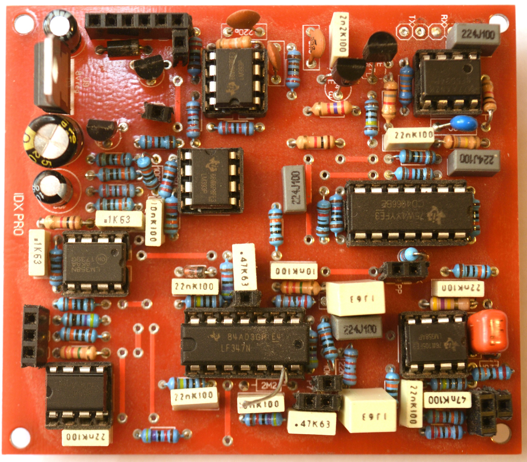

              Being winter here, I am re visiting the IDX Pro ( red board), In all metal, the search depth is good, 34 CM on Canadian and USA Penny, however it does not seem to want to GB ( Using a ferrite )I tried a 20K,50k and 100K pot, it only seems to want GB at the very end of either Pots, Also it has no discrimination, If I set the 10K pot to its highest setting it will block out everything including clad. Any idea's. The coil I am using is one that Don made for me and I also tried a whites Blue max 256. Also the volume is very loud if I have headphones plugged in, Almost un useable with head phones.
              • #67
                My board, Perhaps I Messed something up ?
                • #68
                  Any fake chips i guess??? These days i'm scared when using anything with Texas instruments logo on it?!?!? Is the source of parts reliable?
                  • #69
                    I doubt that very much the IC's that are on it now, Andy AKA silverdog sent them too me, I also have spares that I got from Digikey, there is something else wrong, Perhaps the 3.3? its not a Polyfilm but was sent by Andy so I figure it is good for it as with the 650p that next to the 553 ?its also not a polyfillm box. I doubt that's the problem though.
                    • #70

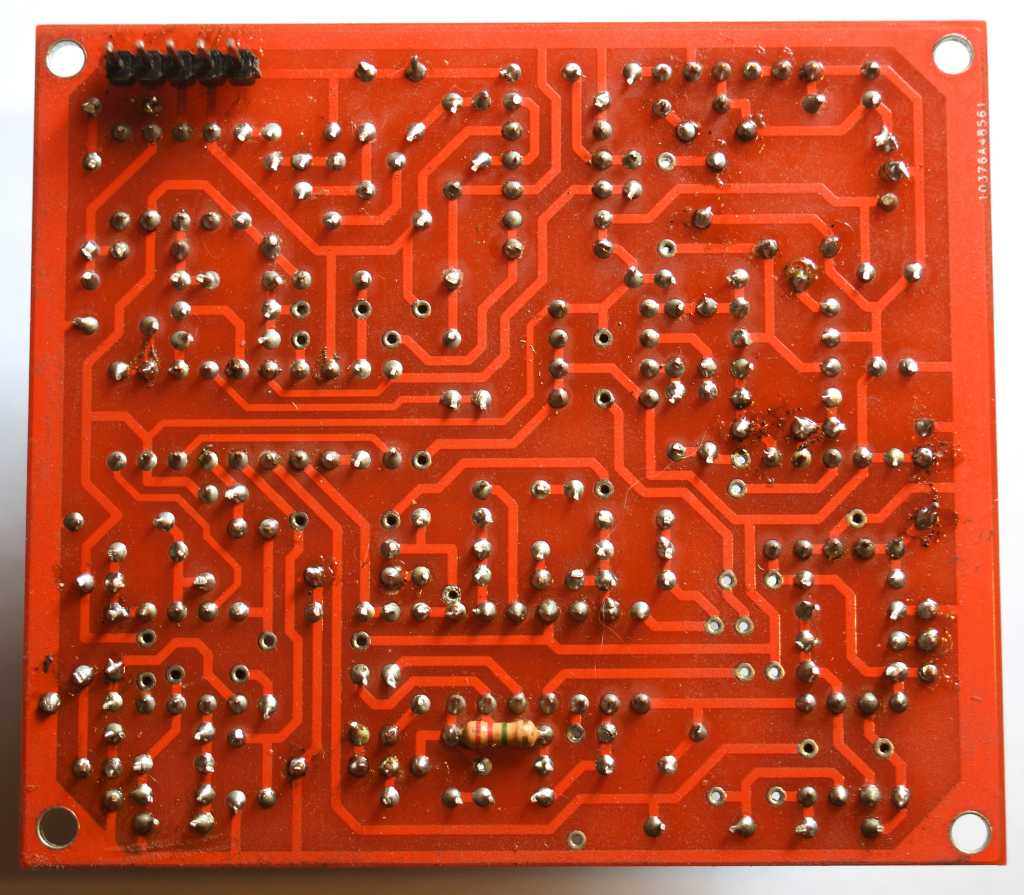

                      Good evening, first you should also send the back of the pcb, and not to be wrong for my experience, you have to measure each component (potentiometers - resistors - capacitors), and very carefully watch with a lens the welds that there is a short circuit , I say this because with the same circuit I had a similar problem because of a potentiometer and a capacitor with false capacity. It made me crazy.
                      • #71
                        Here is the back side, I will re look with a magnifying glass. If you are wondering why one resistor is put on the back side, its because I wanted the lead to be used for the Y if I was going to put a VID on it at one point.
