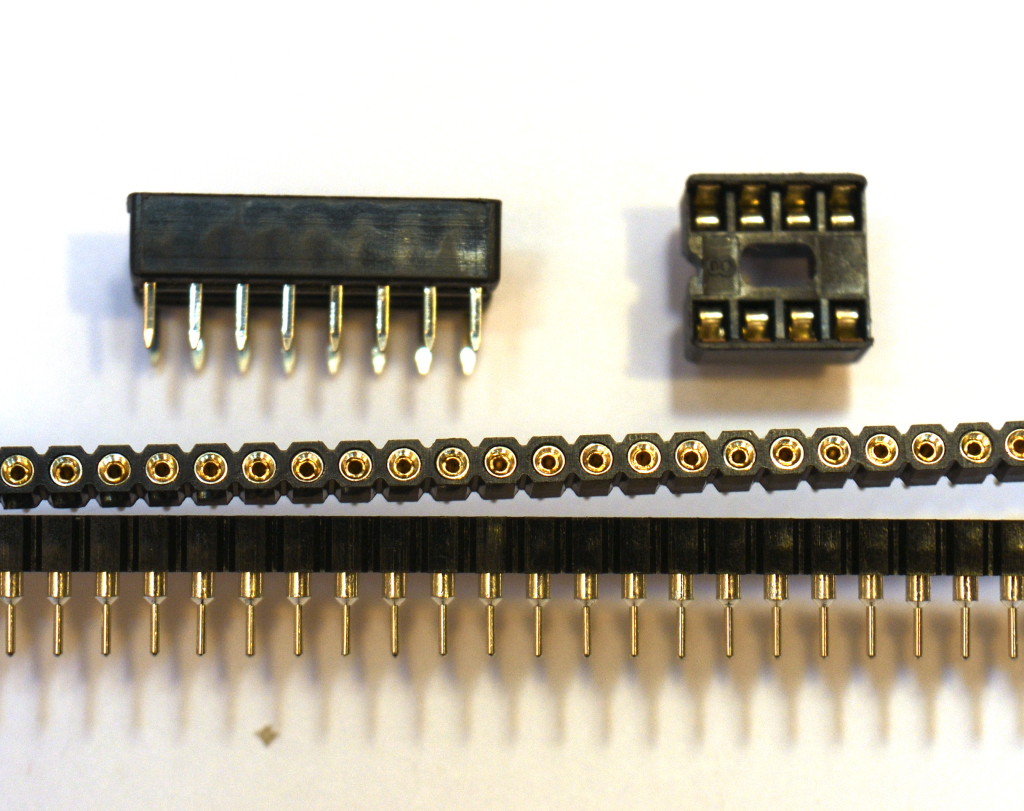

                          It might be common knowledge in the electronics world, However, I have always used standard Dip sockets (AKA el cheapo's) while swapping ic to find the best performance I notice a decrease,when I pulled a ic out and put it back in, If I had not known how the detector was acting before and after, I would of thought there a other problem, after replacing all those Dip sockets for better Dip strips, Everything went back to normal and a little better! Just something to keep in mind, From now on all I will be using is better ones.
                          Photo : top Cheap sockets, Bottom better Dip strips.

                            Yes, I like better sockets for the same reason.
                            The bottom ones in your photo are 'machined pins' and available in DIP sockets.
                            A bit more expensive but well worth not having trouble later.
                            Two single strips is a nice way to do the DIP sockets.
                            Just insert a DIP chip to ensure the two rows stay aligned when soldering into the PCB.

                              Yes indeed, seen the Dip 2 row versions, they are a little more expensive as you say, but if you figure the gain of eliminating problems, and total cost of a DIY detector! they are still a very sound investment, For the single rows I have now, I was thinking of using the cut resistor leads and giving the two right angle bends to act as alignment jumpers while soldering , that way I wont accidently heat the ic
