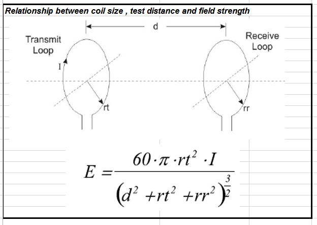

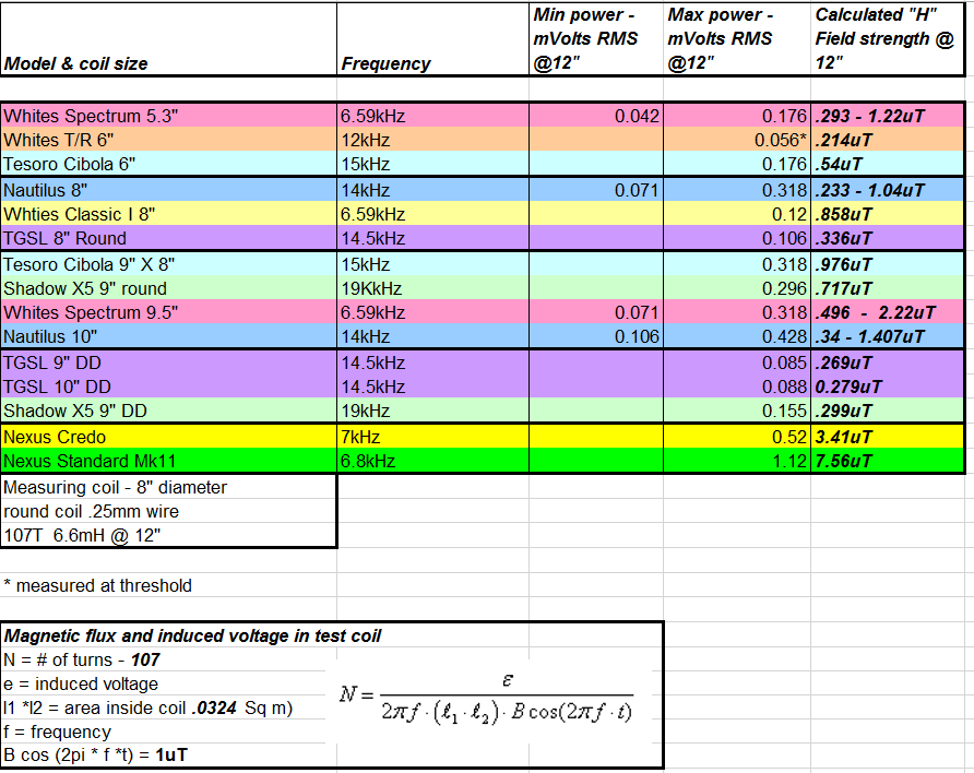

    My methods may be way off base, but I did an experiment a few years back to measure the relative field strength of a few different models. I posted the results here but can no longer find all the references. Just for fun, I made few field strength measurements of the Nexus Credo and Nexus Standard MkII. Wow... even if it's wrong, I applied all the same mistakes to all my measurements. You can get the picture!
    Don.

            It's unfortunately pretty difficult to modify most machines to see what the effect of increasing / decreasing TX 'power' has on detection ability. Typical TX circuitry means you would have to vary the power supply to that part of the circuit, which has knock-on effects on how the TX drive interfaces to oscillators/logic/micro's. Then there's adjusting the gain of the RX stage without messing up phase shifts. If you start off with a low-power machine, then lower the power further, you're likely to get noise / EMI trouble. If you took a high-power machine and dropped the TX power, then you'll have problems jacking up the gain, and circuit noise may be an issue there. And I suspect it's not a 'linear' thing, anyway, and doubling or halving the TX voltage would make minimal difference, maybe if you have half/normal/double at the flick of a switch you might get somewhere.
            The only machine I can say has this feature as standard is the XP Deus, with its 3 TX 'power' levels, the software takes care of the RX 'gain' change. I doubt there's more than a 2:1 voltage difference between low and high settings, though. This is enough to make a decent battery drain change, allowing for TX power being proportional to (TX voltage)^2, which is important when you cannot change the battery. And I've not seen any user reports saying there's any noticeable difference between the 3 power settings (obviously some/many users somehow expect depth to magically double....)

                      To give a practical example, the prototype MD-works 35 volts - pp.
                      The modified Smart 27 volt - pp. and they are both better in mineralized soil than the Deus and multiple brands.

                            That is rather large, for sure. My calculations for the Fisher F75 indicate 3.4 Ampere-turns (based on 34 turns, and 0.1 A RMS current). And the stock 11" x 7" 'bi-axial' coil has a very elliptical transmit coil, more than 2:1 diameter ratio, so I don't think it would read very high on DonBowers test setup.
