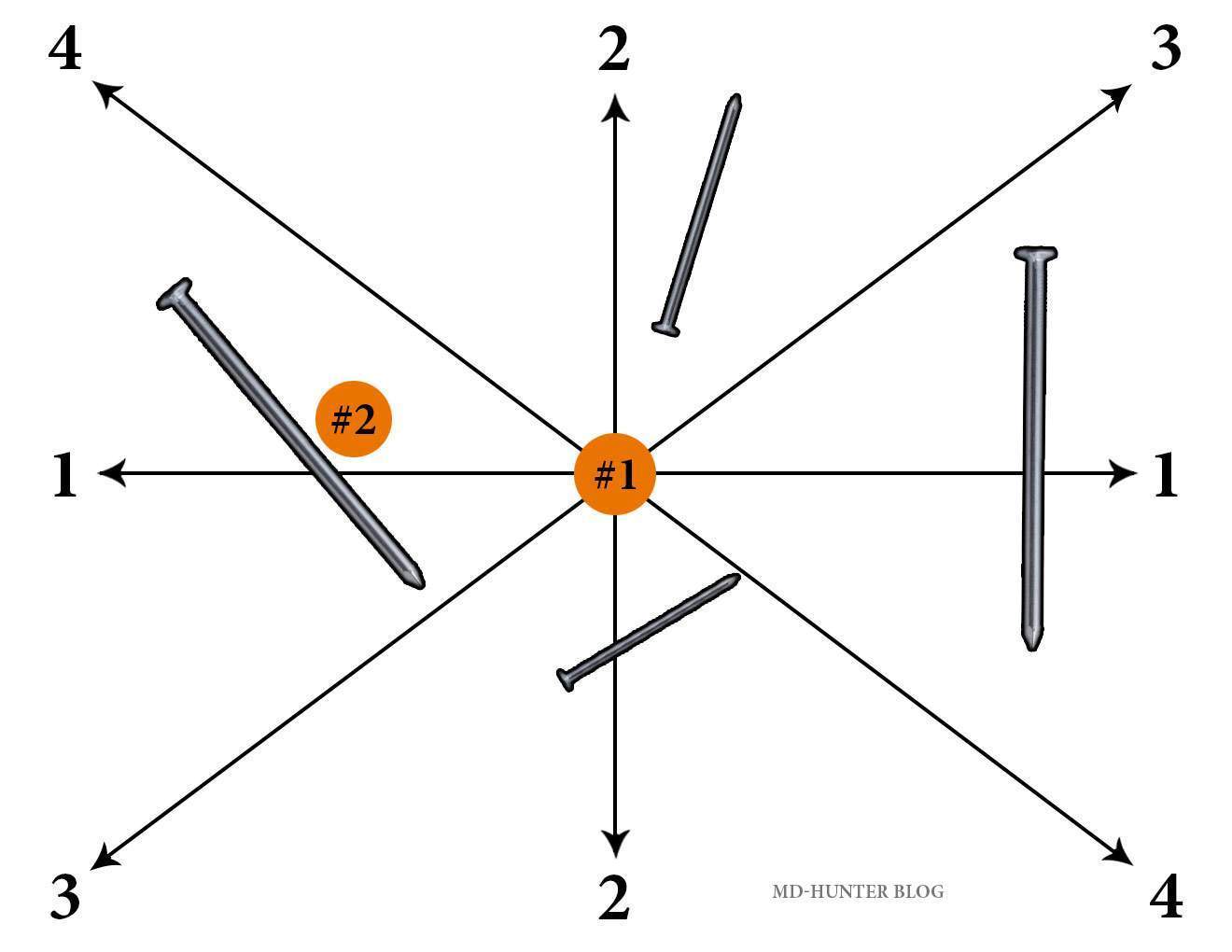

    I have and use Monte NBPT test too. Small clean new nails are not same problem, than
    big rusty iron wedge. NBPT test can successfully pass even some cheap Chinese detectors.
    Some additional words and video of NBPT cheap Chinese MD6006 test.
    Monte genuine NBPT test use US Indian Head or US Zinc Cent coin as test sample.
    Using high conductive (silver and alike) coins is not big deal, cause most detectors
    are able to filter out nails and then detect silver coin.
    Some Monte words on NBPT test:
    " I use an Indian Head Cent or a modern US Zinc Cent in the marked #1 position because they are
    the same size, shape and very similar conductivity.
    There are 4 nails to just be rejected. Then a coin (US Indian Head or modern Zinc cent) is placed in
    the center circle marked position #1. The search coil is swept left-to-right and then right-to-left along
    four (4) sweep directions marked on the Nail Board. Two sweeps for each of four directions makes
    a possible eight ( 8 ) audio hits possible for the coin. Keep the search coil about 2"-3" above the nails "
    Monte nail test board:
    In this test I use as test sample US Indian Head 1902 one cent coin:
    Detector tested is cheap (32 Euro) Chinese model MD-6006 (genuine - no mod):
    MD-6006 can filter out NBPT nails and then decently 8/8 detect Indian Head coin
    from all NBPT directions. Video:
    https://youtu.be/NsZU8DqFrJ4

                Could you share with me the PDF of the nail test printout please, Id like to give it a try with my DIY detectors discrimination.
                EDIT: I found one and my TGSL fail miserably two rusty nails, and fails to pick up a Canadian silver quarter. Click image for larger version

                  I think you forgot to write most important variable for this test: used COIL ?
                  11" DD? Very bad separator, try it again with some small concentric
                  • #54
                      EDIT: I found one and my TGSL fail miserably two rusty nails, and fails to pick up a Canadian silver quarter. [ATTACH]44289[/ATTACH]
                      Use nice shiny nails preferably stainless steel.
                      Set so the nails aren't fully rejected but give a broken tone
                      Then don't use headphones but the internal speaker
                      Bingo it will sound fine for a YouTube video
                      Could you use these settings in the Field
                      Absolutely not.
                      Would you dig the coin if you were using headphones and you can here the iron grunt. Probably not.
                      But hay it look good on YouTube
                      • #56
                        Absolutely
                        Smaller the coil. Better the result.

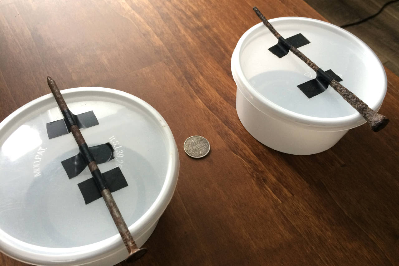

Name:	iphone 5S April1 2018 012_DxO.jpg
ID:	352281 -my 3D test...For the 2D nailboard test, the size of the coil has a significant effect on the results ... 11 "I have bad results in the 2D nailbord test" Coils 9 ", and I have less than good results in this test ... In my the 3D-deep separation test, coils Under 9" they have bad results and on the other hand coils 9" and more have good and excellent results in the 3D test .., - here is also the height of the coil above the nails, most of the detectors work well from 0-15,20 cm above the nails, except is Tecnetics G2- 13 "ultimate - the 0-20cm does not produce a positive signal signal, it starts to pass such a 3D test and at a height of 20-25cm above the knees with a very high separation is good for detection in winter ... when it's snow-...Detectors in my 2D naiboard test and 3D test: Whites SpectraV3 -4x6" ,6x9"eclipse,8x6 "sef, 10"dd whites,12x10"sef,6x10" mars sniper coil,,...Teknetics G2 - 3.5x 6.5" nel snake ,11"dd ,13"ultimate coil,..Golden mask coin killer 15khz-5"spider,9"spider coil,.... Rutus Optima- V.2-16 khz DD23CM, DD29cm coil, rutus Argo V.3 6.6khz..- DD29 cm coil,....

                              I did some experiments with two rusty nail lined up on top of a thick book and a coin underneath
                              couldn't understand why a YouTube video only an old vintage machine would pass this test yet all his more modern detectors failed.
                              Turns out it 100% down to the coil not the machine. DD are much better swinging down the nails and a concentric slightly better when swinging at 90 degrees.
                              again no magic going on with the vintage machine. Just comparing apples with pears by using different coils.
                              • #60
                                I believe your correct, ever since Nexus posted his video I have been obsess with this, Reading and watching video's, Nexus video is a very effective sales tool, the video even had me convince I would never find silver again with our diy detectors, Lucky like you Koala, I notice old analog detecting doing better then modern ones and they all share the something, Smaller concentric coils .
                                EDIT: the only ones that seam to do a fair job was Tesoro with the 9x8 concentric coil, Which is why im ordering one for the TGSL, This one https://canadiantreasureseekers.com/...x8-concentric/ I'm Sure the 7 inch might be better but I don't want to small of a coil either.
