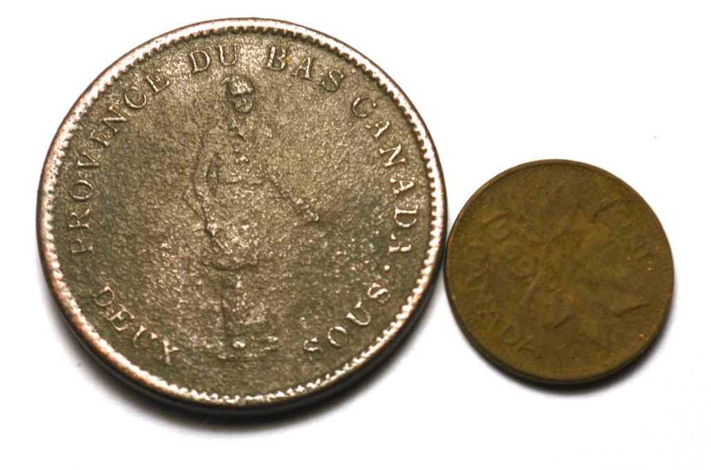

                      Nice little coin you have
                      • #71

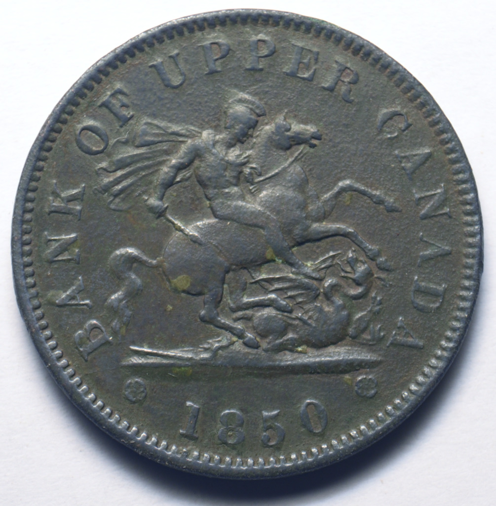

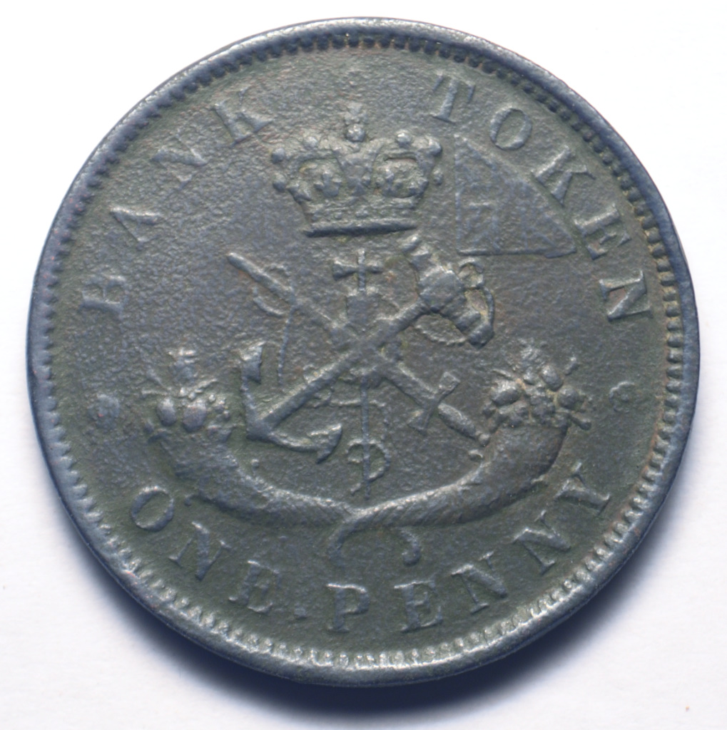

                        hehehe Thank you ! I found it this year with the TGSL actually, It is hardly small mind you, lol here a photo of an other coil the same size in comparison to a todays penny.
ID:	352286 also this years find.

ID:	352287 this coin

ID:	352288 other side
